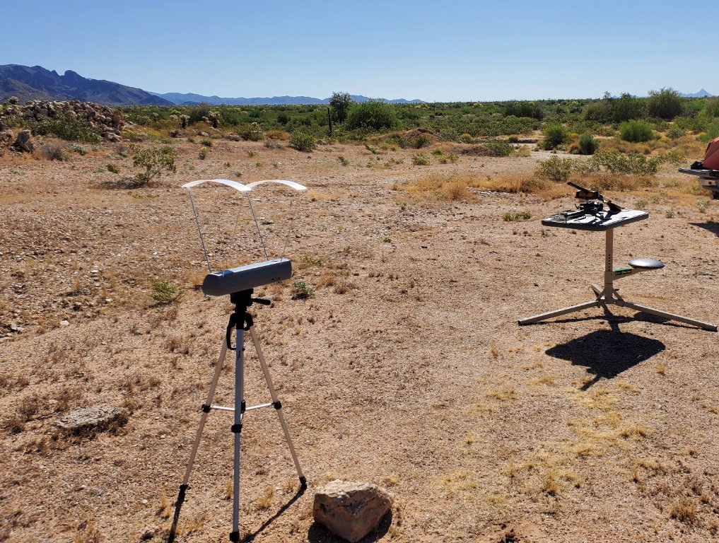

Post by Johnnyjr » Mon Aug 30, 2021 1:27 pm
Ok . My new unit says 10 feet away. Now I don't have a regular rifle rest to sight from. I use only a sand bag front to rest the rifle. Now I only have two lever guns. A 44 mag and a 357. I have no idea how much muzzle blast they would have. I mean nothing like a large rifle I'm sure. I wouldn't think any more than a hand gun..So I'm wondering how far away the chronograph should be.. any ideas on this?? I've heard some say about 4 foot is all. Appreciate any advice or actual experience..johnny

Post by GunnyGene » Mon Aug 30, 2021 2:27 pm
I set up at 10' (.41mag). There's a small drop in MV in that 10', but nothing to worry about. I'll set up a target stand a foot or 2 beyond where the chrono will be so I have something to aim at, and fire a shot or 2 without the chrono. Don't want to kill the thing with a low, or off center, shot. Having a aim spot and a regular distance (whether it's 4' or 10' or whatever) also helps with getting consistent readings.

Re: Let's talk chronograph
Post by Johnnyjr » Mon Aug 30, 2021 3:10 pm
I called the company and she said 5 foot for pistol. Pro chronograph ltd model.. so if I'm shooting a 44 hand gun at 5 feet would I be able to do the same with my Henry in 44 mag. She didn't fully understand my question and said with a rifle,10//12 feet..??
Post by GunnyGene » Mon Aug 30, 2021 3:16 pm
Maybe, if you measure from the muzzle. Try it and see. There's no hard and fast rule for this, just experience. Whatever way you set up, do it the same way every time for that particular firearm & ammo so you don't introduce measurement error into your results.
Post by runnin n gunnin » Mon Aug 30, 2021 3:55 pm
I'm with Gunny, I set my chrono ten to 12 feet from the muzzle of the rifle and a target 10 feet beyond the Chrono. I keep the same distance for my pistols as well. Haven't shot the chrono yet !
