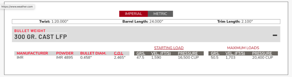

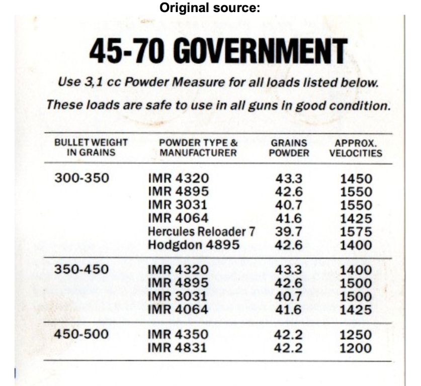

Here's the best two sources.
Would you concur? I'd like a few head nods before I do my first ever reloads (tad nervous)
I think I'm going to follow direction from the IMR website.

Never used any 4895 in 45-70. Id start at the low end of that load table.

I think I'm going to load 6 Grizzly and 6 Missouri 300g bullets with the lighter grain and test those out first.

the most helpful reloading manual I've found for 45-70 is "The Complete Reloading Manual for the .45-70 Gov't Spiral-its bound – January 1, 1993 " .... its available at Cabela's and Amazon ----> https://www.amazon.com/Complete-Reloadi ... B004JOGNQS .... it covers Trapdoor loads .... it list most all powders .... for a for a fun to fire round at 100 or so yards, I'd recommend you find one in the mid to low trapdoor

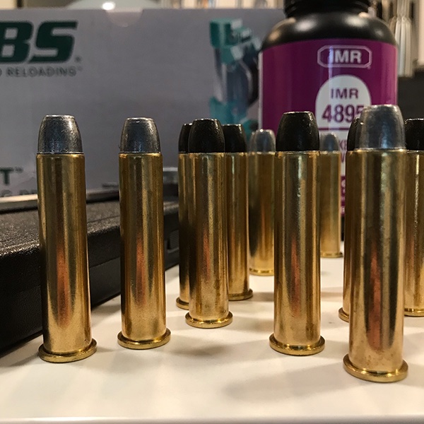

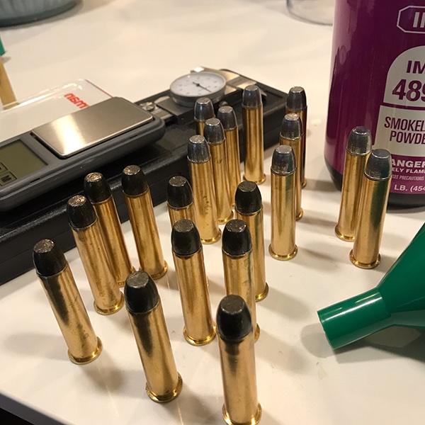

Pressed ten and ten :-)
Triple and quadruple checked my weights and measurements and reweighed all of the completed rounds when they were done.

Those look fine Kmb. Did you stay with the Hodgdon load data?

Re: It's on!
Post by Kissmybrass » Thu Aug 05, 2021 2:03 pm
Rifletom wrote:
Thu Aug 05, 2021 12:31 pm
Yes I did! I used the IMR trapdoor 300g data.
Did a ton (maybe too much) research and this was the best for starters.
https://shop.hodgdon.com/imr/imr-4895

I don’t believe there are specs for crimp but I may be wrong, just not in my experience anyway. If you have any factory ammo on hand you can do a visual comparison between them and your reloads. Biggest issue with over-crimp is an increase in pressure do to a late release of the bullet. From your pictures your crimp looks fine, especially since you are producing a light load. (More room for error doing that) Crimps are especially important in lever action rifles due to the in-line style of magazine. Too light of a crimp will cause the bullet to move forward or rearward in the case from recoil causing an over or under length condition.

Post by Kissmybrass » Fri Aug 06, 2021 11:18 am
Yes I did. I used the Starting 47.5 grains of 4895. Around 1600 fps I believe. Gonna head to the range this afternoon or Tomorrow morning!
