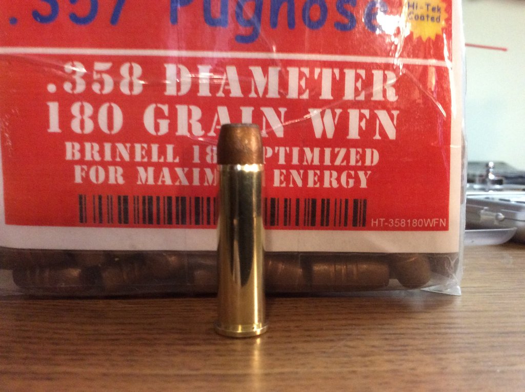

Post by fortyshooter » Wed Feb 10, 2021 12:37 pm
Another vote for the Missouri Bullets 180 Pug and the 158 gr. RNFP ! If you shoot steel make sure your attachments are in top shape with those 357 mag loaded 180's. :D
357 magnum MB 180.jpg (136.88 KiB) Viewed 1545 times
runnin n gunnin
Posts: 797
Location: Arizona
Re: 357 Mag coated lead bullet suggestions
Post by runnin n gunnin » Wed Feb 10, 2021 12:42 pm
Nice Crimp 40

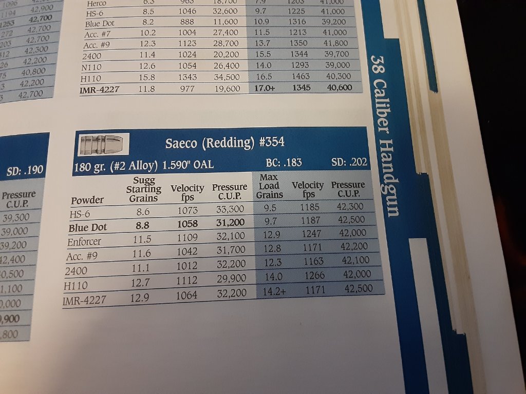

Nosing around Google turned up nothing but great reviews on MBC 180 pugs- several comments like "most accurate load I've tried".
Now that's an endorsement.
One problem... my (limited) data sources don't include 180 grain lead among those tested with IMR 4227, only jacketed in 180 grains.
Any of you kind fellows have a data source?

Maybe someone with a Lyman manual will chime in. I have one but not at home right now. You probably wont find any for a 180 grain lead bullet. But I just did a little research and came up with some for a 160 grain bullet.

Post by Vaquero » Thu Feb 11, 2021 11:17 am
wolfman wrote:
Thu Feb 11, 2021 10:49 am
From my Lyman cast bullet handbook.

Post by fortyshooter » Thu Feb 11, 2021 11:48 am
11.6 of 2400 is plenty to get the job done and that's what I use. 1380- 1400 FPS out of my Henry with 20 inch barrel and sweet shootin' !

Post by wolfman » Thu Feb 11, 2021 12:06 pm
You guys are the best... many thanks!
Gotta get me a copy of the Lyman.
Post by BigAl52 » Thu Feb 11, 2021 12:17 pm
Well there you go Randy to the rescue. Dont be surprised if you see some powder kernals in the barrel. 4227 will do that. Give it a good firm crimp
