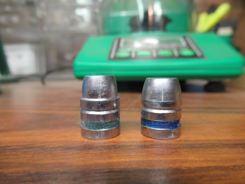

No deformation with mine. These are the two different styles of 45 Colts that I shoot out of my revolver and my Carbine, a 255 gr. SWC and a WFN. I shoot the same styles but with gas checks out of my 45-70 in either 350 gr. or 405 gr. All feed reliably. Both rifles are Marlins so I can't speak for a Henry. However I shoot the 240 and 275 gr.WFN cast out of my 44 mag Henry and it feeds fine too.
