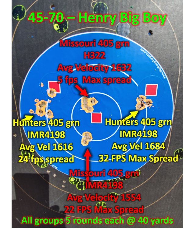

Love the pics of those reloads! I just got the 405 Hi-tek from MBC myself. Loaded up 20 to test on my Henry and shot them off yesterday. I noticed they come out to only 2.53" OAL instead of the 2.55. Does that seem to affect anything? I decided to keep the starting (and maybe finshed?!) charge in the low range and started with 33.5 grains of IMR 4198. I started there because I like using the Lee dippers on the big cartridges if I can and the 2.8cc threw about 33.5 when measured on my scale. They seemed to shoot good for me. Do you adjust for the shorter (more compressed) case? Anyone shoot these through a chrono at various charges with IMR 4198?

...also, I have been looking at the ACME bullets as well.... I see the 405s they have are .458" and the MBC are .459. Have you (or anyone else) compared the two bullets in the Henry and, if so, any difference between the company based on quality and accuracy?

The last chrono I did last month was 36.5 grans of IMR4198 (and I shot H332) came out here:
45-70 target.jpg (120.23 KiB) Viewed 2645 times
I ordered 500 more MBC Hi-tek 405 grain Buffalo and 500 180 grn for the .357 a month ago, still has not shipped yet. MBC is quite backed up in orders.
