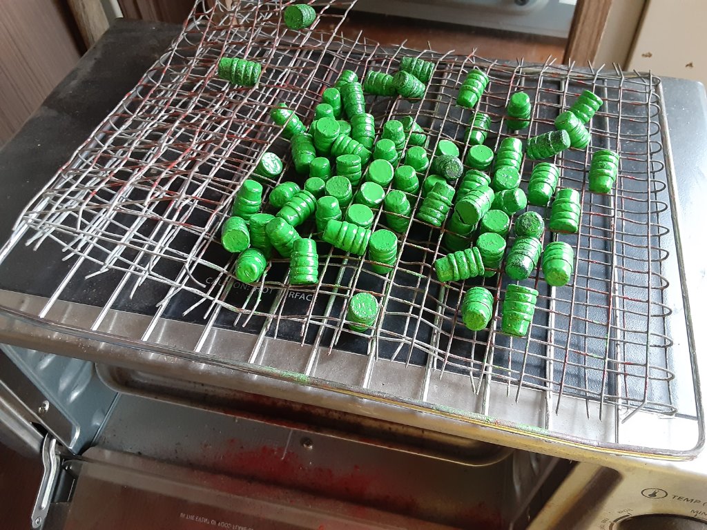

While I have been waiting I powder coated a small batch of 41's that I found.

Me likes them green bullets Randy
