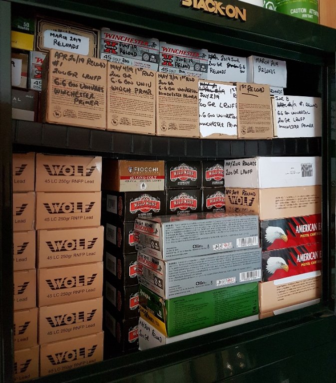

Just an update for anybody still on the fence.
I have reloaded approx 1500 rounds since April. Probably shot at least 500. The only issues I have had were a primer that jammed in cockeyed during priming, and the Starline "blank" brass case found the other day which I did not use. I have had no squibs, misfires or jams cycling the action in my rifle. They shoot fine in the revolver too. All rounds are consistently 1.575" - 1.585" in OAL. All are 1st time reloaded brass. I have collected some brass from fired reloads in a separate bin but have not cleaned any yet. I still have LOTS of brass. I can comfortably reload 50-100 rounds in couple of hours. My routine is:
- check brass case
- de-prime, resize & prime at stage one
- powder charge & flare case at stage two
- remove case, check primer seat, and visual on powder (weigh every 10 or so)
- seat bullet at stage three
- crimp at stage four
- visually inspect each finished cartridge WITHOUT FAIL before they go in the box holder
I have been happy with the accuracy so far, and the reloading is quite a relaxing time actually. I like to keep things simple; 1 powder, 1 caliber, 1 primer mfg, and I have a good source for lead. To each his own for reloading, but if you are thinking about reloading, I am proof that it does not have to be complicated.
Here's one cabinet just about full and I have another full of factory ammo as well. This 'ol cowboy is well stocked.

Been following your reloading adventure since the beginning, RR. Liked what you said here to anybody "still on the fence." At this point, I'm on the side with non-reloaders. Since I don't see any greener grass on the other side of the fence that I want now, I'm good.RanchRoper wrote: ↑Thu Jul 04, 2019 5:28 pmJust an update for anybody still on the fence.
I have been happy with the accuracy so far, and the reloading is quite a relaxing time actually. I like to keep things simple; I am proof that it does not have to be complicated.
...one cabinet just about full and I have another full of factory ammo as well. This 'ol cowboy is well stocked.![]()
My most expensive caliber at this time is the .45 Colt round. I'm awaiting one small shipment (125 rounds) from Choice Ammo, which will bring my stock to 440 rounds. Depending on how many I shoot during a range visit, I have between 11-15 visits to go before I run out of .45 Colt. I'm at the range one or two times per month now, rarely three times. So I should have enough .45 Colt to last into 2020. And as soon as I get the replacement BP .50 cal Trapper pistol shippe to me, I'll be working with that ammo, too. I like what ESquared said about this muzzleloader. I'll be reloading "from inside the barrel." Sounds cool.
