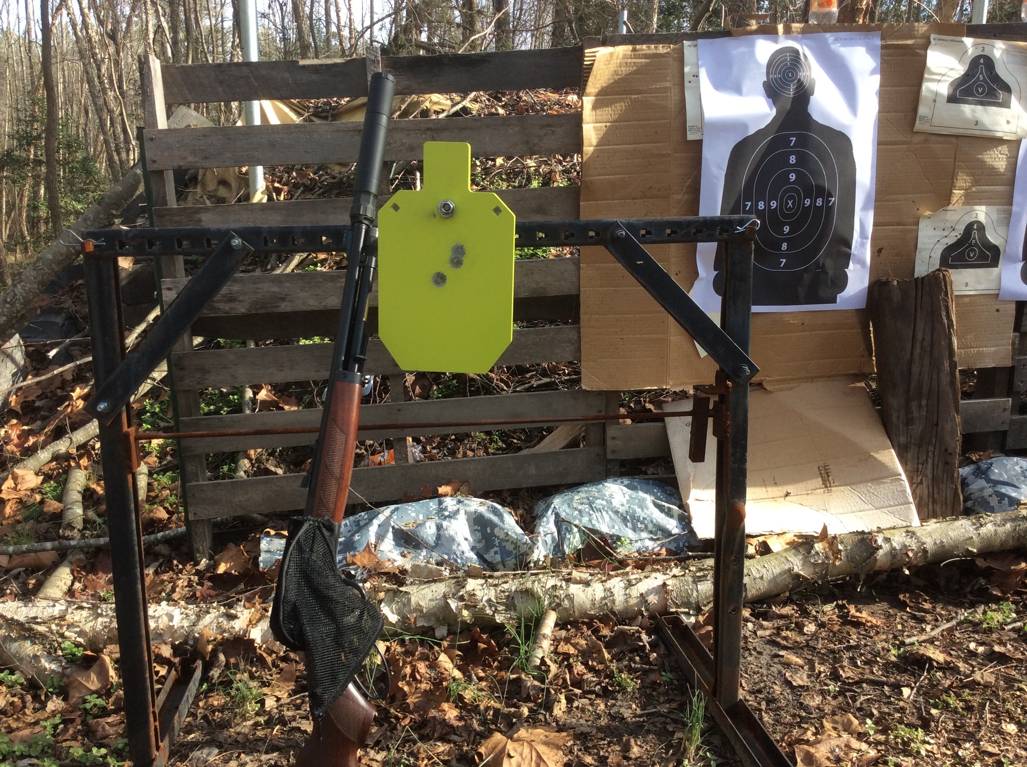

Well here were my first three 50 yd. shots for 2023. Using the 255 Xtreme bullets with my 6.0 gr. Red Dot...Beautiful and quiet as a BB gun!
50 yd shots with Henry X 45 1 2 23.jpg (1.04 MiB) Viewed 1960 times
Nice shooting! Did you chronograph your load?
