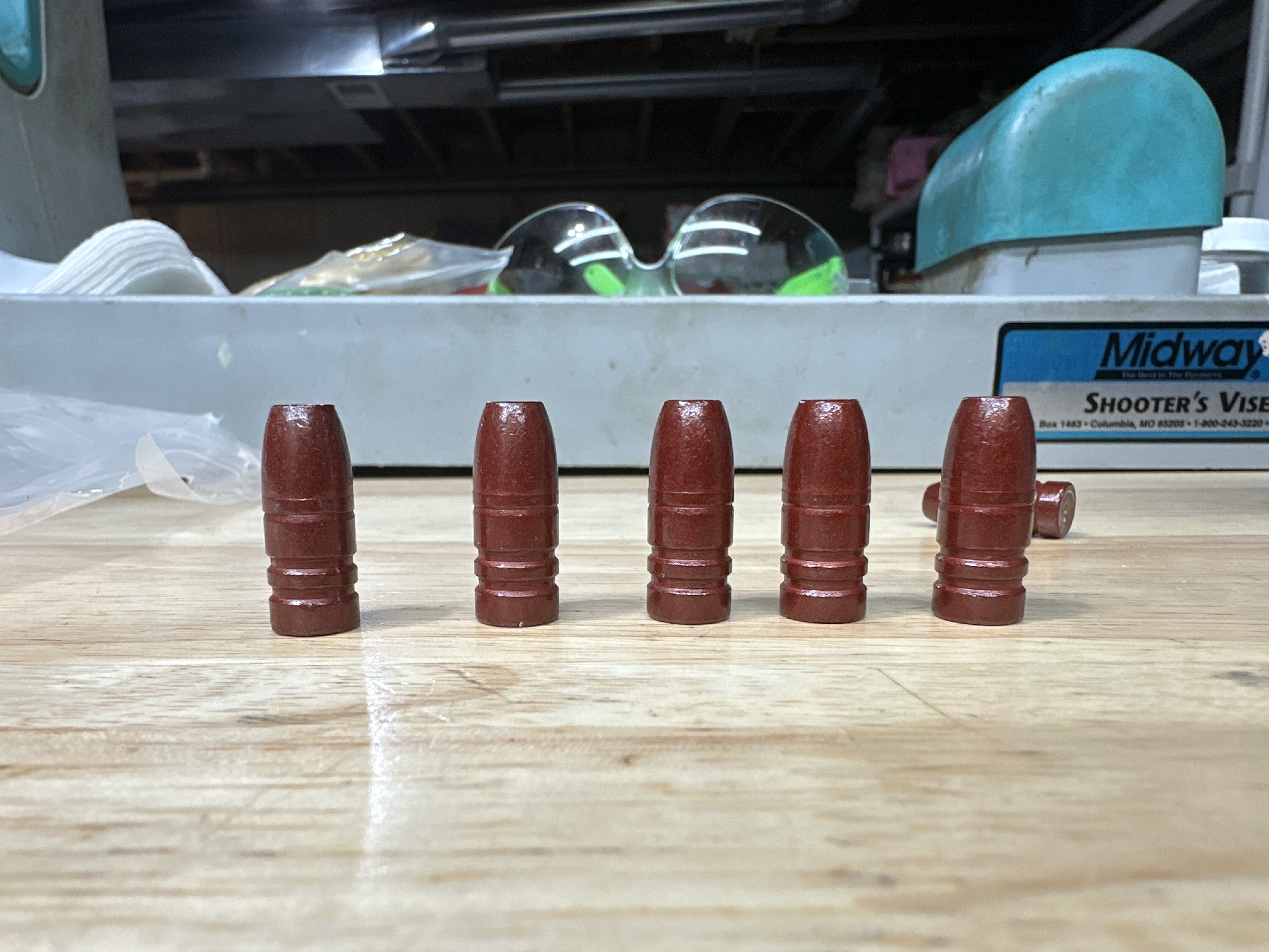

Post by BigAl52 » Mon Oct 06, 2025 5:24 pm
Got the 38-55 bullets from SNS today. I like the way they look and they are very well done. Just put together some test loads using some of the load data from the Marlin results. Hopefully we will have some success. The Henry only has iron sights on it so I dont expect the groups to be as tight. I havent decided what to put on the Henry yet.

Post by DsGrouse » Mon Oct 06, 2025 6:46 pm
are those 255's?
I swaged a couple of pounds of 170.2 grain cores for my 240 grain .375 bullets. I'll swage all these up into 240 grain P4FPs.
After this, I plan to swage up some 185-grain cores for 255-grain bullets. These are P4S spire points. I'll have to trim them down with an end mill cutter so I can run them in the magazine tube. I expect their final weight to be around 250grns.
I'm hoping to pick up a P4SFP pointform die from RCE.

Yes sir they are 255. I check weighed a bunch they are all within tenths of each other

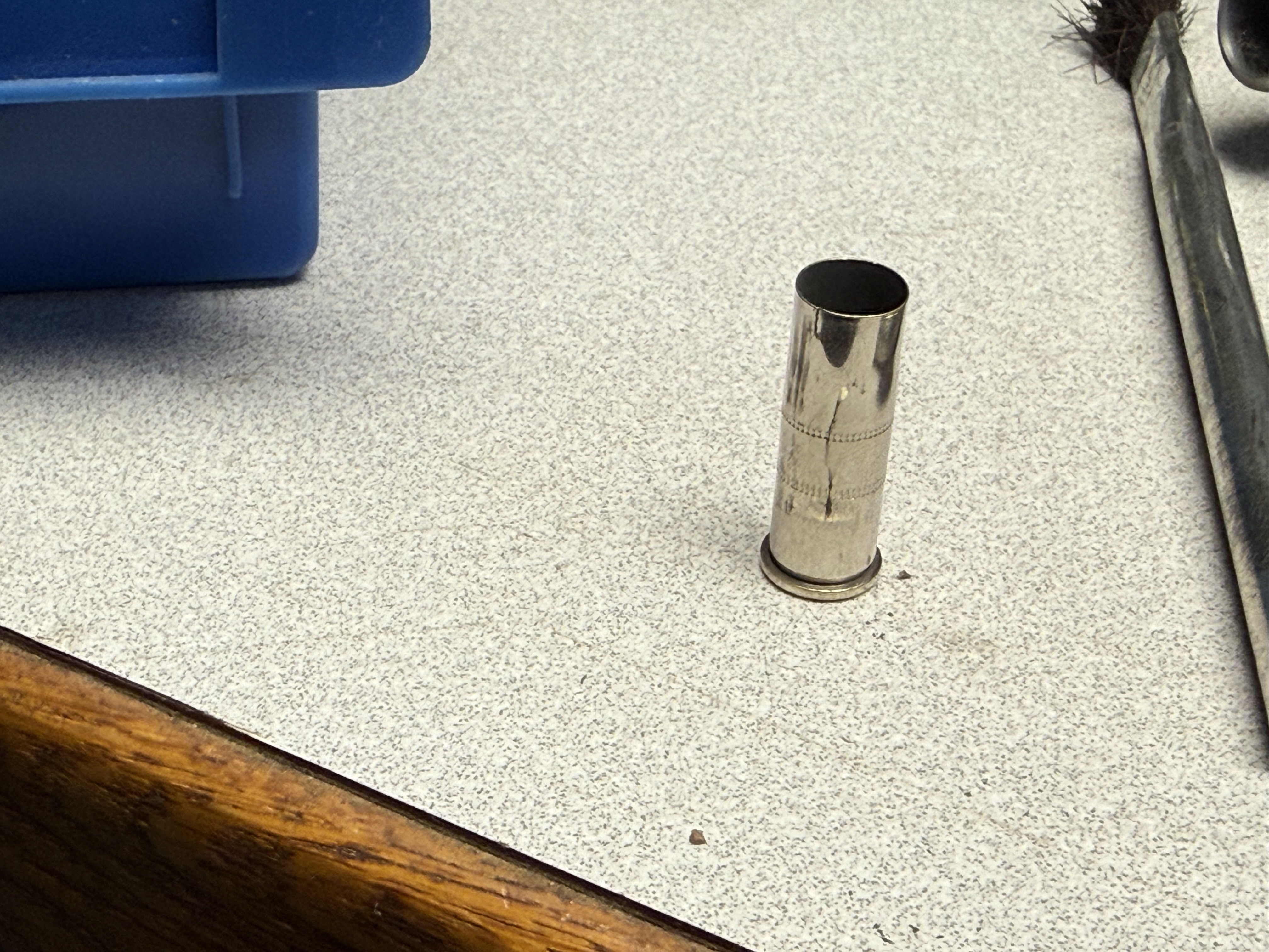

We had about 4” of snow over night so I figured it was a good day to say inside and prep some 38 Spl. So I sized, deprimed, expanded and then primed 300 cases. As I was expanding one case something didn’t feel right. So I pulled and inspected the case and this is what I found.
Needless to say this case went into the scrap bin.

I've come to the point that I rarely bother with nickel cases anymore. Sometimes you can get a half dozen loadings out of them and sometimes not.

Yup Ive seen that a few times on my nickel cases and I do the same thing. I don’t go out looking for them but the ones I have get reloaded until they look like that.

Same here. So I don't bother with them either. -----> recycle bin.
