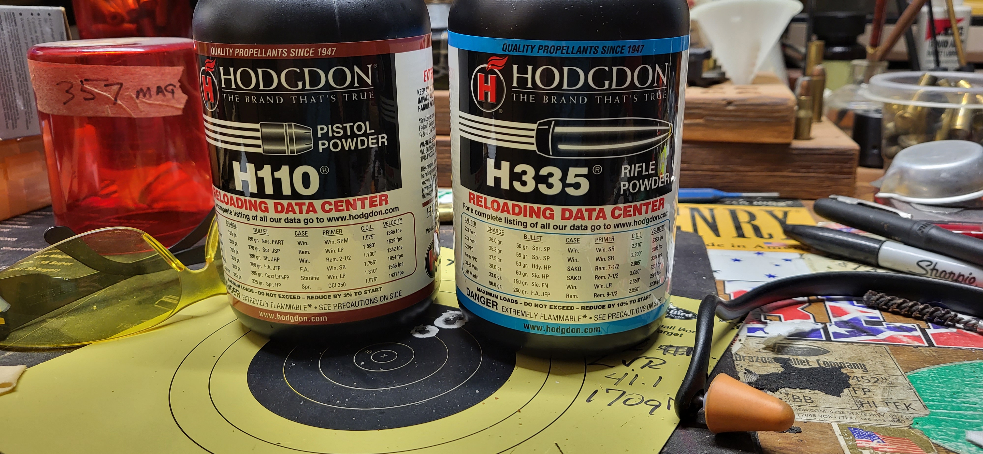

Post by Vaquero » Sat Aug 02, 2025 8:54 am
Nothing in a few days, but I did pick up a couple of things. Two lbs. One as a spare and the other as I used up the last a couple weeks ago and "thought" that I had another. Didn't really like the price of the 110 :shock: but for $41 bucks on the other, I grabbed it also.
Some more fire breathing loads in the future. :lol: 8-)
