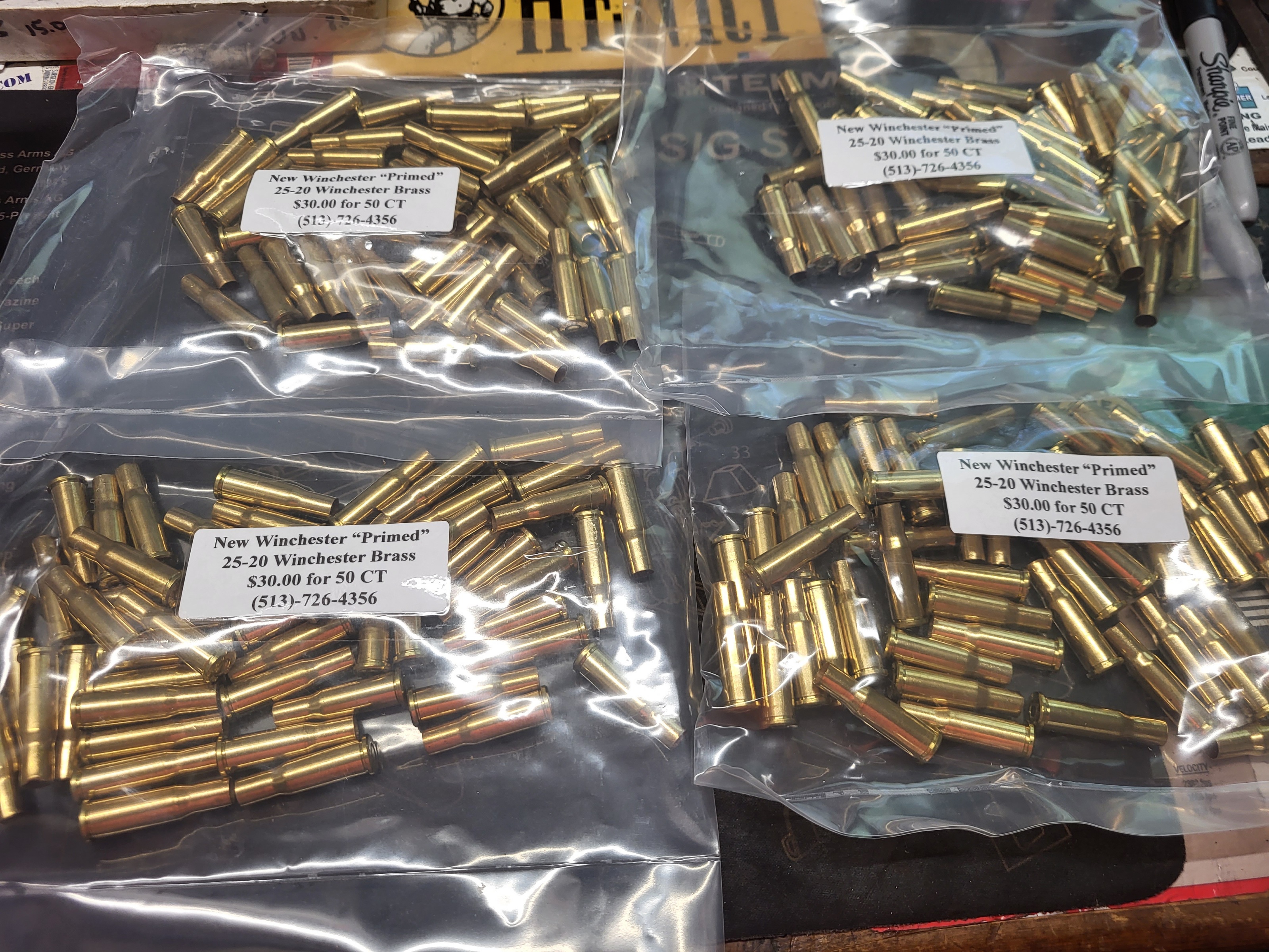

Post by Vaquero » Fri Jul 28, 2023 2:43 pm
Didn't do anything, but I did receive some new 25-20 brass today.
Not sure if any here shoot much older stuff.
But, I found these at ET Brass, $30 per 50 and are primed.
