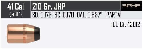

my ooops .... in the picture below taken from Nosler list the OAL at 0.687"
- 41cal-210gr-SPHG-Revolver.jpg (16.25 KiB) Viewed 3432 times

Thanks man.... Nosler didn't used to have the length online...or if they did I don't remember it...I should have at least looked though

.039" shorter than the Swift, but .014" longer than the XTP.
That fits with the load data, the data for the Nosler bullet generally maxes out with a little less powder than the XTP, I suspected it might be a little longer.
