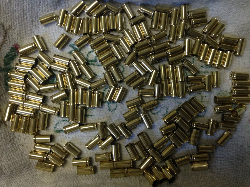

Post by Mistered » Sat Jun 29, 2019 10:53 am
but I can't imagine brass getting much cleaner (or certainly any faster) than with this rock tumbler/pin set-up.
Yep - It still amazes me even though I have been doing it for a few years - after dropping dry tumbling.
A load of 9mm from this morning. This was with a few heavy drops of Dawn and a 'shot' of lemon juice!

How much "tumble time" for those outstanding results?
Mistered
Re: Heads Up for You Wet Tumblers!
Post by Mistered » Sat Jun 29, 2019 5:24 pm
This was about two hours.
