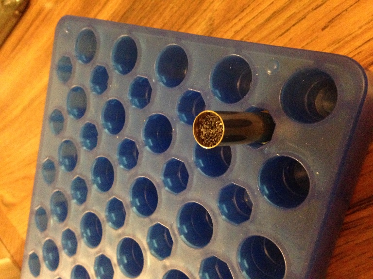

I am confused and concerned about this. I know the 110grn bullet is short, but this looks totally wrong. Does it pack the powder down?
The pic is a 357 case with 20 grains of 2400.

I don't load 2400 so I don't know about it specifically but compressed loads are common .... IF you are following info from an established manual and still have concerns, back off to the lowest charge given and work up
This is true. The density of the powder & load data will sometimes result in a nearly full case.
The Alliant website however shows 19.5 grains as maximum for the 110 grain bullet so i would think about backing that off.

Evan, I haven't loaded any 110's in .357 with 2400, but, I'm thinking 17.5gr would be a good place to start. According to Allinant, those loads on their website, should be reduced by 10%. Making that 19.5/2400 listing as 17.55gr of 2400.
When I called Alliant, the tech mentioned the same; back off 10% to start. This is how I came to my load using 2400/158 XTP's in my .357. 11.5-12.5gr 2400[.357]. Hope this helps.
