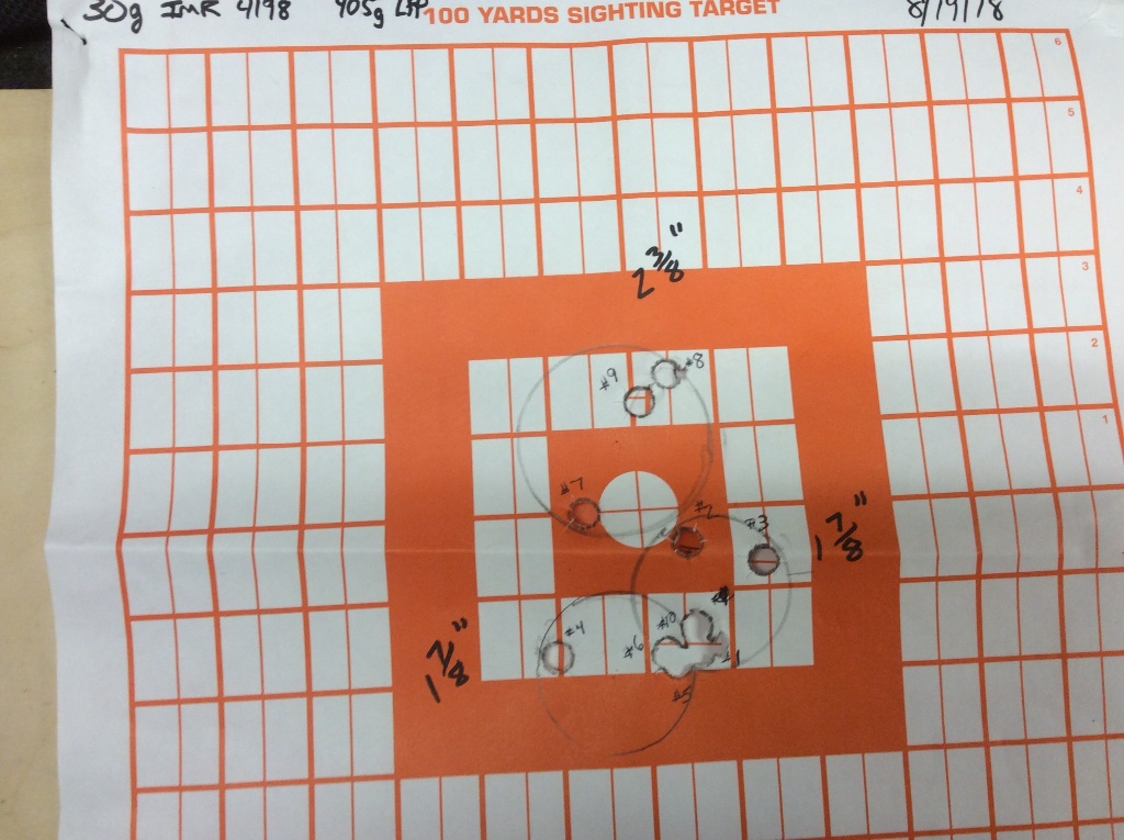

I think I have found a good powder/projectile combination that works for me, and one I hope will help me fill the freezer with meat.
At the range today I tried my newest hand loads. Of the 4 new loads tested, one was unmanageable (for me) due to excessive recoil. I only fired three of those off, and got scope bit twice. The remainder of those rounds will be disassembled and reloaded to my new favorite.
The loads in order of preference were:
1.) 30g IMR 4198, 405g LRNFP (Missouri Bullet Company, #1 Buffalo).
This round produced the easiest to handle recoil, while shooting three groups of three rounds each:
1.) 2 3/8” diameter group
2.) 1 7/8” diameter group, and
3.) 1 7/8” diameter group.
Target was posted at 100 yards. Shooting from a rest with bags, 3-9x 40mm scope. Estimated muzzle velocity was 1370 FPS. ( not verified in the field, taken from the Hogden page, Trapdoor loads, “The Complete Reloading Manual for the 45-70 Government”)
30g IMR 4198, 405g LRNFP, 100yds, 1370 FPS.

Any opinions out there concerning my new load, 30g powder, 405g LRNFP, 1370 FPS being used as a hunting round?
With more practice, I think I can tighten my groups up to get a predictable point of aim, point of impact.

Dadio63 wrote:I think I have found a good powder/projectile combination that works for me, and one I hope will help me fill the freezer with meat.
not surprised at your findings, it should be one heck of a hunting round ..... as noted in the link in my first comment in this thread, HSM's Cowboy Action ammo with 405 gr - Round Nose Flat Point bullets - with a muzzle velocity of 1300 fps - delivering 1520 ft lbs of energy have proven to be extremely accurate in our Henry 45-70 .... I'm getting ready to work on a similar load using 300 gr Nosler Ballistic Silvertips .... if I can come up with an accurate load developing 1300 to 1400 fps, it should have an even lighter recoil

I based my search for a powder/projectile combination based on your recommendation!
I found a comparable load in the manual, checked the HSM Cowboy Action load specs and found they were very, very close so went with the manual load ( lightest load in the Trapdoor category on that page).
Now we just have to develop our shooting skills to meet the rifle and rounds capability...I do not want to be the “weak link” in this equation.
Thanks for your help and input!
