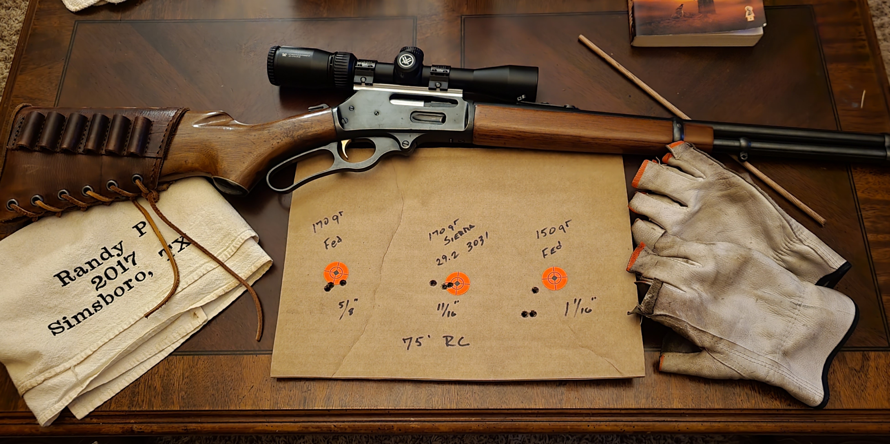

I was lookin for a target a couple days ago when Dave was showing his 32 colt.
But, I never found it but I came across this one from last year.
I was getting ready for deer season, this is my first cf rifle I've had it since the early 80's. And I ended up using a different 30-30.
So I pulled the rifle out for the photo.

Wow, some nice shootinā there, Vaquero!!!
Iām guessinā that gun likes 170 grainers better than 150s, huh?
