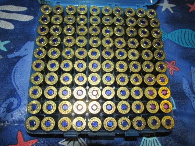

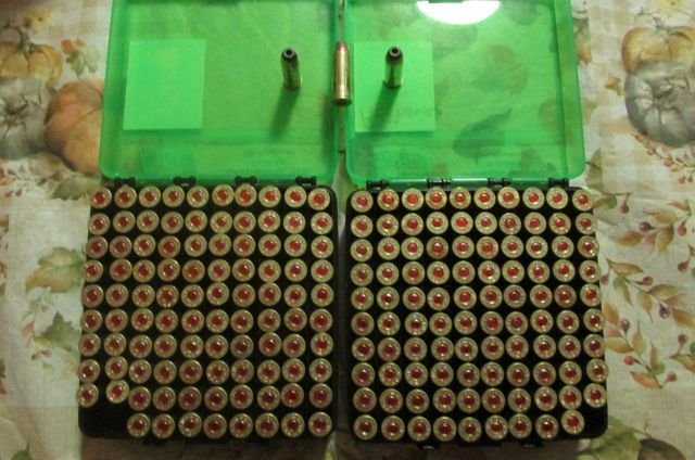

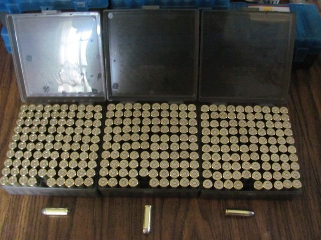

just put the finishing touch on our 44 Specials .... we now put together 3 different 44 caliber loads .... to ensure easy recognition we color code the primers .... we leave the primers of our 44 Mag, full power hunting loads silver (picture 1) .... Red is the color we paint the primers of our 44 Mag target loads fired from our Ruger Redhawks (picture 2) .... Blue signifies the 44 Special loads fired in our Bond derringer (picture 3)

Nice looking loads.
Lots of fun shooting. But I don't know how you shoot the derringer without a helmet! :o
I color code the primers to distinguish different loads of the same caliber too.

kind words appreciated .... taking the time to color the primers most certainly makes it easy to ensure feeding the correct round into each 44 .... we have a 38 Special/357 Magnum barrel and a 44 Special barrel for our Roughneck derringer .... light 38 special loads are fun to fire, 357 Magnum loads can be punishing ..... Nosler shows 3.9 gr of Bullseye as the minimum load of their 240 gr'ers .... I decided to go with 4.0 gr .... as noted, I've only fired one so far but it was fine .... more smoke and muzzle blast than I anticipated but recoil was not bad at all
