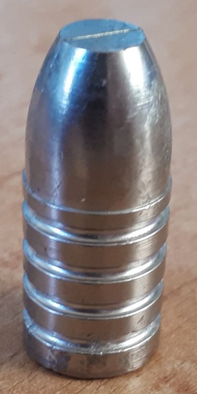

185 molded lead bullets in hardness 15 brinell
is it possible to keep the lubricated bullets for a long time in a sealed pot ? or is it better to lubricate and recalibrate them just before reloading?
it would be more convenient to prepare them in advance ... that they are ready to be seated in case ....
What do you think about that ?

first, that is one impressive set of fine looking bullets .... bulk packed, lubed commercial bullets often sit in boxes for months, if not years, waiting to be loaded .... it wouldn't hurt to wait until just before loading them but I don't tend to believe that its necessary

Nice lookin boolits, what caliber?

45-70 GVT 405 g , casted with Lyman mold #457193

Those are very formidable.

Very nice looking .45-70 bullets you have cast! That's one part of reloading I haven't ventured into.
