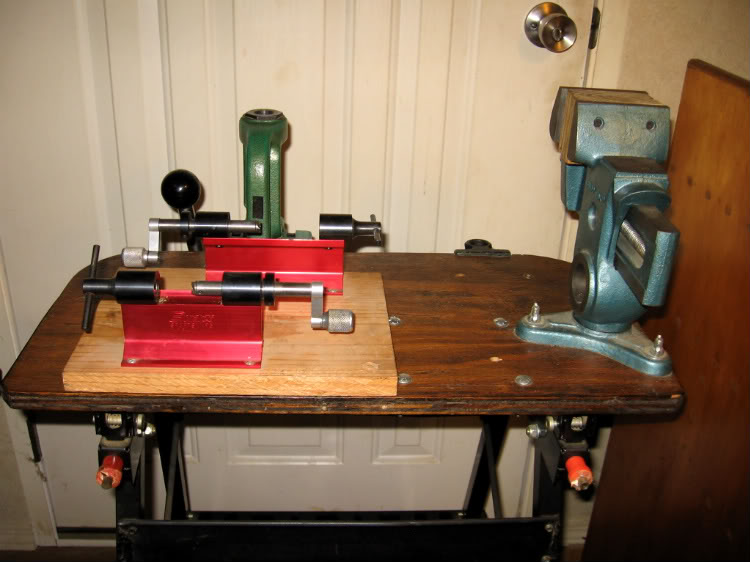

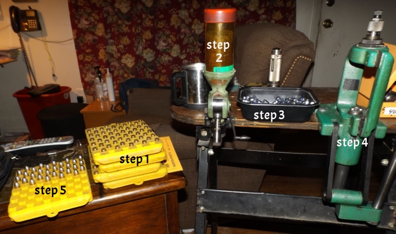

I put a top on a work mate and I been ammo on it for about 30 years . So I could watch TV in ac . My lube sizer for lube bullets and shotgun loader bolts on and off this table and it folds up . I have a big work bench in the garage I never use . I have more pic if you want to see them .

I have used the Lee hand loader. It is a great way to get started in reloading, and makes a great portable unit for those who want to put something together at the range. For normal reloading, I would recommend getting started with a bench mounted press. If space is short, consider mounting the press to something that can easily be temporarily mounted to a stationary surface. The Workmate solution makes a lot of sense as well. The bench mounted presses are much easier on the body and far more robust devices. If you like Lee presses, I suggest sticking with the classic series. Much more robust, and normally not that much more money than the aluminum Challenger series. The linkage is heavier on most of the classic series presses I have seen.
