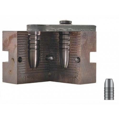

Saturday, the mold arrived by post, shipped by MidSouthSchooterSupply ...
Last night I had a little time to cast some bullets ...

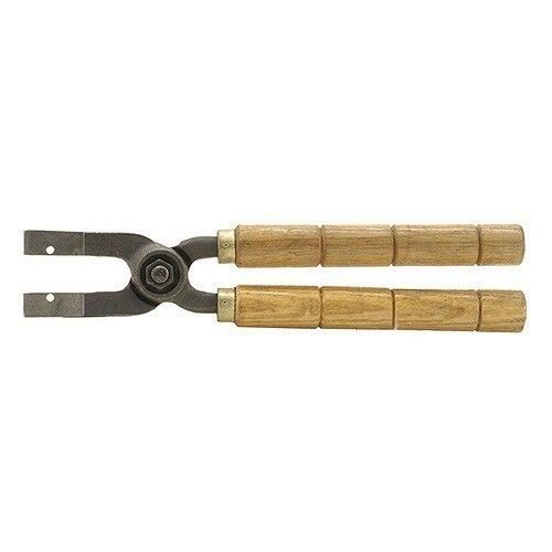

the mold #457193 45 Caliber 405 Grain from Lyman, and the Single Cavity Mould Handles are expensive but seems to be high quality products...

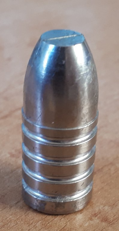

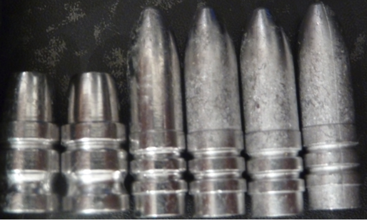

First bullet (Emotion) :D :
45-70 gvt.jpg (50.08 KiB) Viewed 2981 times

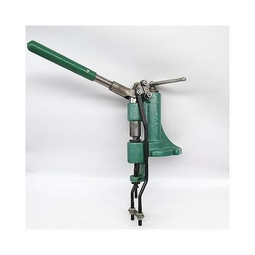

I was also able to test a luba-a-matic RCBS, bought used on the net and immediately equiped with a calibrator 45 and the appropriate punch.
Not bad for bullet lubrication ...

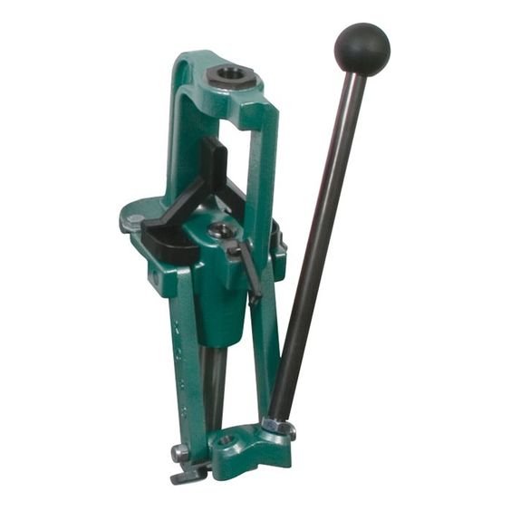

I opted for a RCBS rockchucker supreme., simple solid and efficient ... a sure value

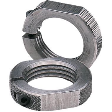

Equipped with die bushing hornady and lock n load locks of the same brand, we change this tool in 5 seconds.

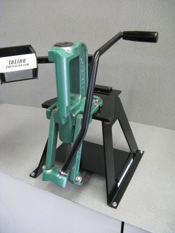

finally to be able to quickly change rockchucker press to another tool, I ordered a quick change ultramount system, inline fabrication
very practical, for the bench...

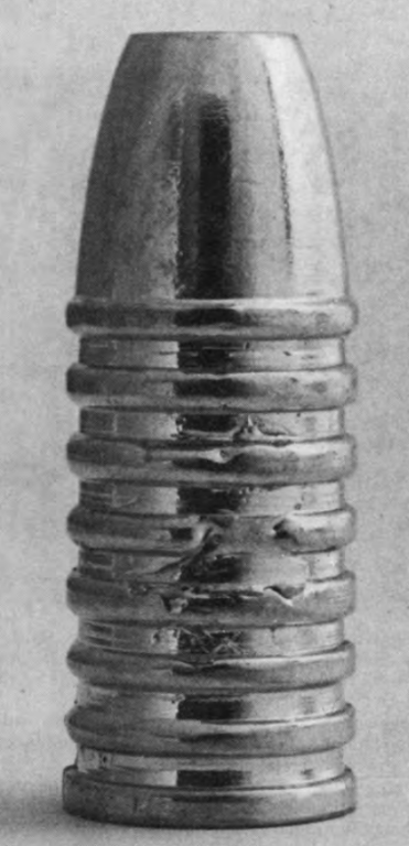

the main difficulty is to keep the mold at the right temperature, neither too hot nor too cold.
700 ° F on the furnace and,
  possibly preheat the mold above the lead furnace
in general, the first two or three bullet are incorrect (mold too cold)
Sample (source Lee modern reloading, Lyman ...) :
MOLD TOO COLD :
too cold.png (240.3 KiB) Viewed 2966 times
MOLD TOO HOT:
too hot.png (413.95 KiB) Viewed 2966 times

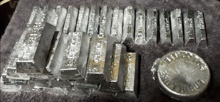

Also, i have spent a lot of time , before to obtain very clean alloy, by fluxing lead, making ingots etc ....
