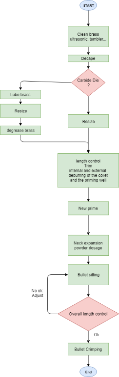

hello !
i will like to make an remeber note to reloading steps, and i have build a flow chart.
what do you think about ?

i hope there not too langage mistake :mrgreen: , and no more reloading error !

I like it - I have said many times with regard to reloading it is important to develop a system that works for you and stick with it - and whatever means you use to remember your system is equally as important.

Looks similar to the 1 made for my first progressive. 1 nit, new brass must be handled just like old brass. You can never trust the system (automation,handling, packaging, shipping, marketing or the stocking) for having the stuff to be exactly what you desire in spec's including the primer holes.

wingnut wrote:Looks similar to the 1 made for my first progressive. 1 nit, new brass must be handled just like old brass. You can never trust the system (automation,handling, packaging, shipping, marketing or the stocking) for having the stuff to be exactly what you desire in spec's including the primer holes.
Very interesting idea, need to verify brass as an old one ....
i will correct flow chart ....
thanks !

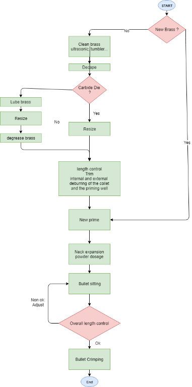

New version
Post by BruniX » Fri Mar 08, 2019 10:06 am
with same handling between new and old brass
Reloading process flow.png (37.01 KiB) Viewed 2286 times
pdf version available on demand :D

Am I the only one who decaps as a first and totally separate step?

ESquared wrote:Am I the only one who decaps as a first and totally separate step?
I was sure someone would tell me that!
you are a perfectionist : :D
i like that :lol:
30 years of computer science, I like to analyze and break down the stages (steps ?) :mrgreen:
Doubt it. However, if you dry tumble there is no need and the primer hole does not get plugged up. I do not clean primer pockets either (note - I did not say uniform primer pockets). Cleaning pockets is a waste of time unless you are really anal and have a firearm capable of <=.15 MOA (.15 inch group or less at 100 yards) with more than 2 shots. ;)

Good idea, out of round and dinged necks can be common in new brass, flash holes not properly formed not so common but does happen.
No need to clean them but running them through a FL die will sort out or highlight any issues with new brass.
