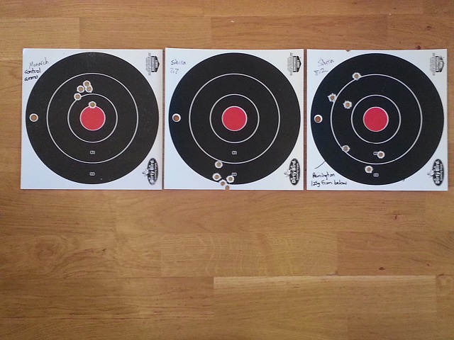

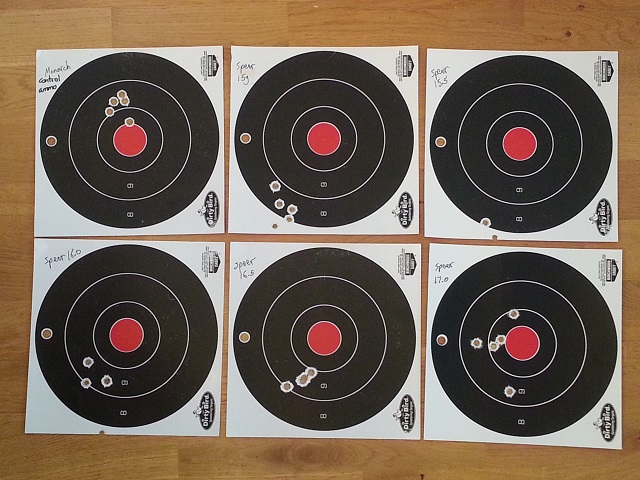

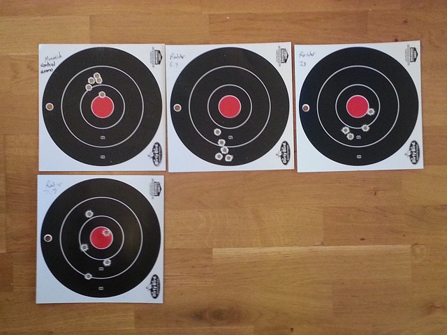

I just got started reloading and worked up a variety of loads as an experiment. I started with a box of Speer 158gr JSP (#4217) and IMR 4227 from the Speer #14 book. Who knew there are no more left in the world? There are a handful of online suppliers that have one box left and they don't come in bulk. Imagine ordering from a handful of people just to get a couple hundred! Anyway back to the topic. I picked up a box of Rainier 158gr JHP (they can go to 1500 FPS, Berry's is only 1200 FPS), and some generic 158gr SJSP from Everglades. I wanted to compare with my off the shelf Monarch 158gr SJHP ammo.
I worked up 5 rounds for each load and shot at 50 yards. The loads were Speer 158gr with IMR 4227, Rainier with Unique, Generic with Unique.
Here is the Henry with Speer/IMR - 15.0, 15.5, 16.0, 16.5 and max 17.0gr. I was disappointed that my velocities were nowhere close to the Monarch. The 15.5gr seemed to go berserk and the 17.0gr group was opening back up. Here is the Rainier/Unique - 6.9, 7.3, 7.7gr. They were inaccurate at the higher velocity. The generics that looked like Sierras - 7.7 and 8.2gr seemed to also lose accuracy at higher velocity. The group at the bottom of the right target were 125gr I mistakenly shot at a target below this one. That Monarch must be screaming hot because these loads were probably in the 1400-1500 FPS range and came nowhere close to the same impact. I guess I need to load with something that can handle W296 or step down to 125gr to even reach out to 100yds. Anybody have a recommendation for a higher velocity load using IMR or Unique?
