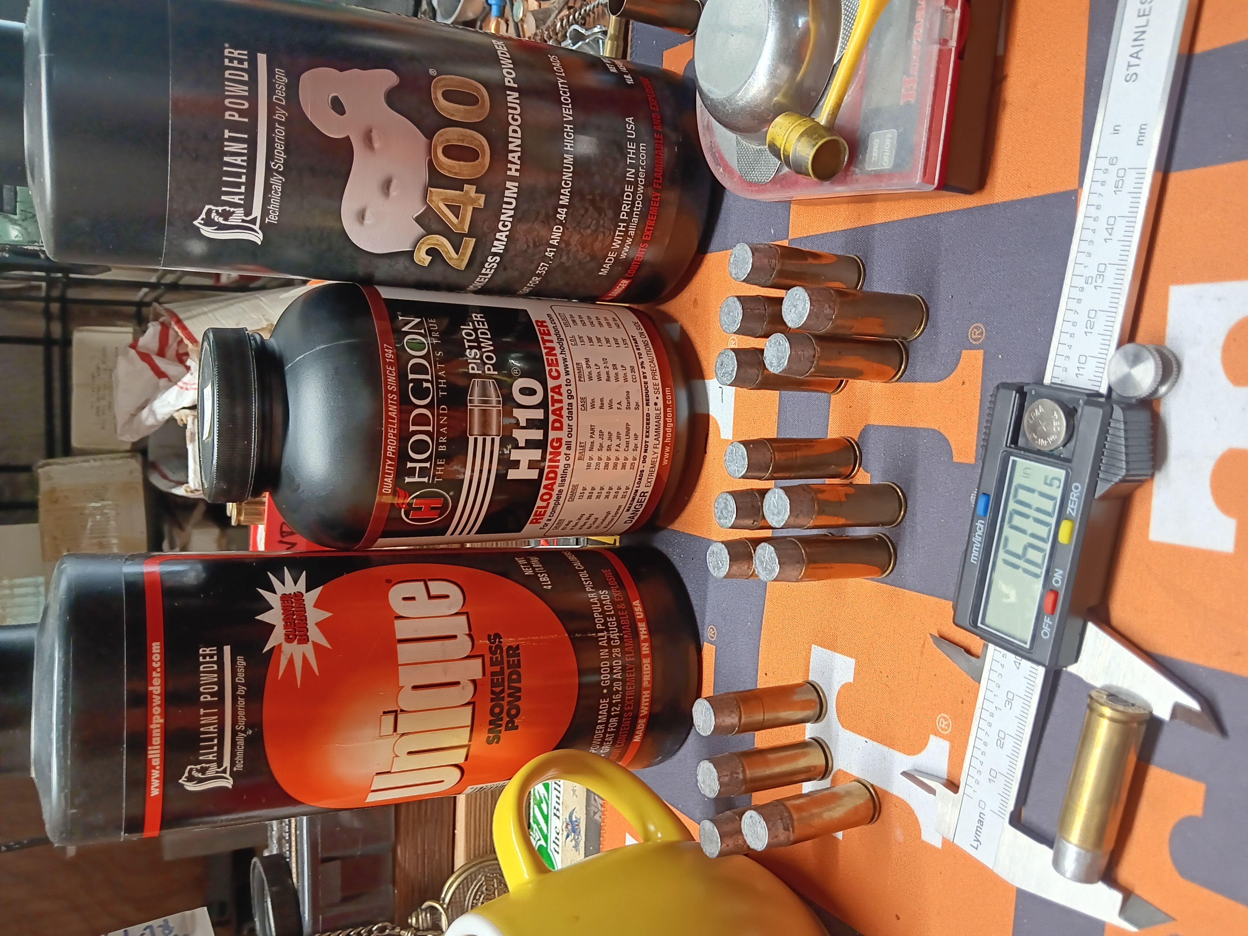

Post by Vaquero » Sat Aug 01, 2026 11:20 am
Stuffed a 45 colt cases with wfn 325gr MBC Slammers.
Five each to test in the Rossi R92.
Starting loads.
Unique 8.5
2400 17.5
H110 20.5

None of those showed promise, but the 2400 17.5 was the best. I don't believe it likes those heavy boolits. :lol:
I myself don't think I'd like shooting the H110 load from a handgun. That first round was an eye opener and the metal butt plate let me know it. :o :roll: :lol:
