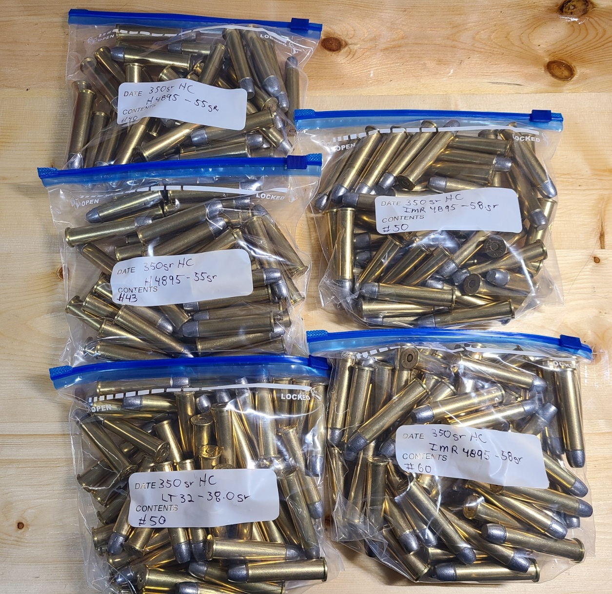

Over the winter I made 1500 350gr 5% antimony HC bullets. This past weekend on Saturday I decided to load a few rounds. On Sunday loaded some Hornady 325GR FTX.

Someone at a local range shoot around September each year with 444 marlin rounds. Last year I collected several hundred rounds, decamped them and cleaned them. I ended up using them for barter as apparently finding cases is like hen's teeth. I shot a 444 many years ago and it is a great round and in Maryland it can be used in every county where shot guns are used along with areas in rifle country in Maryland.
