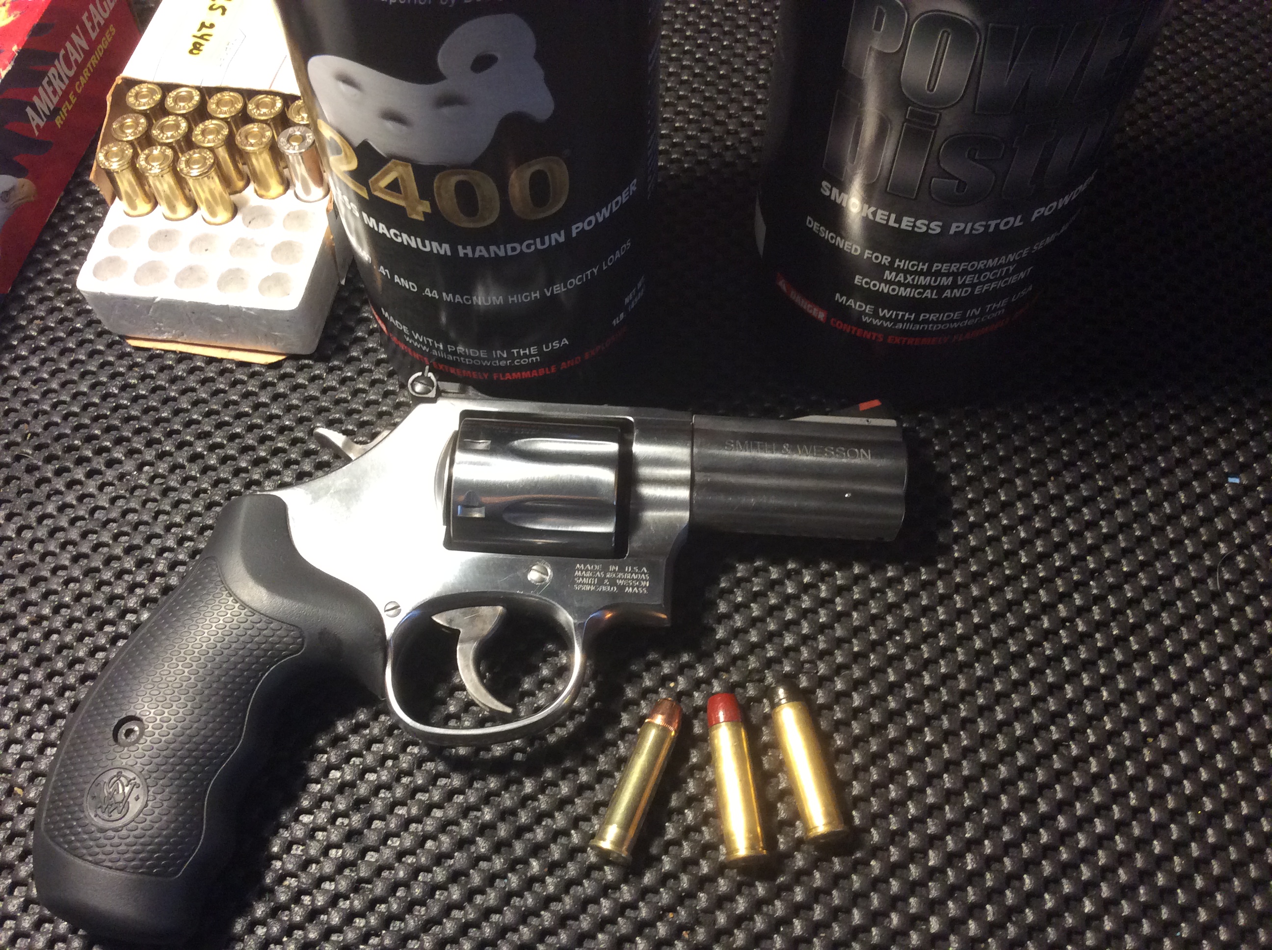

Loading up what I have shot over last year in 357. The Stoppers are 158 gr. XTP with 14 gr. of 2400 and Hammers which would be a pass thru stopper are the 180 Pugs with 11.6 of 2400 and of course my favorite all day plinker the 158 RNFP with 6.0 Power Pistol.
Revolver in picture my S&W 686 Plus 7 shooter 3 inch a fine one to shoot!

Those 180gr pills make steel swing. When I shoot them outa the single shot they are thumpers for sure. Try some RMR 147 grain smiley bullets they shoot wonderful

Yep...those 180's are little destroyers on targets sometimes! :D

The 158 RNFP is my favorite plinker also. Loaded over 5.4 gr of PP it works well in both of my Henry single shots, the X-Model, H012 carbine and a mess of revolvers. The same bullet over a little stiffer charge of HS6 and a magnum primer is the go-to plinker in a couple of guns that occasionally pierce standard primers. That load shoots well in everything also.
