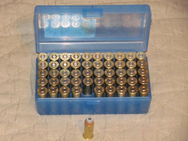

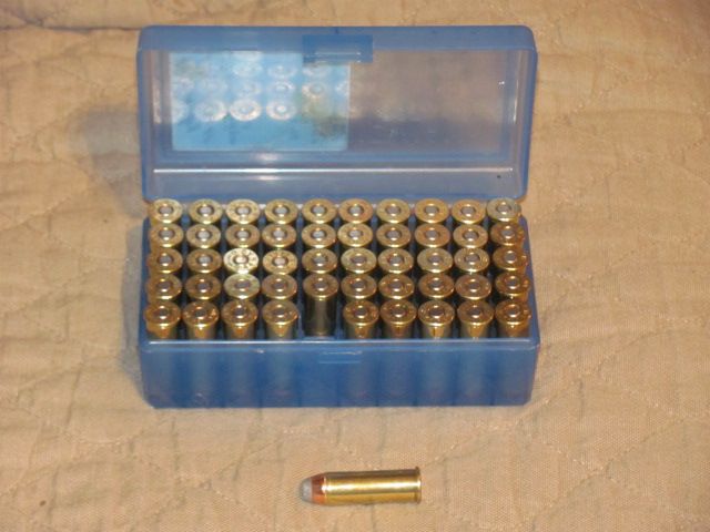

Post by JEBar » Thu Oct 20, 2016 8:48 pm
well, back in the saddle so to speak .... tonight, for the first time 15+ years when our oldest son took over reloading ammo for the family, I sat down and loaded a loaded a 50 round box of 44 Mag hunting level ammo on our 1960's vintage RCBS single stage press .... he recently moved his family from St Louis and is currently living in a rental until they find a spot to settle in for the long term .... right now he doesn't have a place to dedicated to reloading so we are in the process of fixing a temporary spot at our home .... those who reload know that loading a box of ammo isn't a big deal but they will also understand how nice it is to spend a relaxing evening working a press .... parts should arrive within a few days to get our Hornady Lock-n-Load progressive press .... looking forward to getting it back in action .... the 44's shown below are hunting level 240 gr Nosler JHP's, pushed by 23.8 grains of H110, ignited by CCI Large Pistol Magnum primers .... the casings are mixed brand that have been fired and resized .... they will be used for practice in our Henry 44 Mag and Ruger Redhawk .... our actual hunting rounds will be made from the same components but we will use new brass .... looking forward to sending them down the range

Post by Sir Henry » Thu Oct 20, 2016 9:06 pm
Having a dedicated place is important for consistency. I haven't reloaded in a few years but when I was I didn't allow any distractions.

Post by DWD445 » Fri Oct 21, 2016 2:37 pm
That should be a very good hunting load, I've made almost the same load w/soft points at 23.4g H110.
No high tech chono stuff, but my shoulder says it's a strong load :lol: :lol: Feels like a 12ga in my BBS :shock:

Post by Squatch » Fri Oct 21, 2016 2:48 pm
It's about time! :lol: ;)
That should be a nice load. Anything above 23 grains is a nice H110 load for the 44 mag.

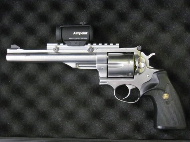

Post by Rugerfanboy » Fri Oct 21, 2016 4:29 pm
JEBar wrote:The 44's are hunting level 240 gr Nosler JHP's, pushed by 23.8 grains of H110, ignited by CCI Large Pistol Magnum primers .... the casings are mixed brand that have been fired and resized .... they will be used for practice in our Henry 44 Mag and Ruger Redhawk.
JEBar...23.8 grains of H110 in a Ruger Redhawk is a HOT load. Not a dangerous load...but it's still HOT. Recoil and muzzle rise/flip is huuugh. The Ruger Redhawk can handle that load plus some. It's just a heavy recoil load for a shooter. Be for warned, that load will wreck your hand, wrist and forearm if you practice with it before hunting. It took me a week to recover from a 100 rounds range trip with that load. When I walked off my range that afternoon, I knew right then and there I was gonna pay for it dearly.
Have you tested this load in your Redhawk yet...??? If not...make sure you apply a heavy crimp.

Post by JEBar » Fri Oct 21, 2016 5:29 pm
Rugerfanboy wrote:JEBar...23.8 grains of H110 in a Ruger Redhawk is a HOT load. Not a dangerous load...but it's still HOT. Recoil and muzzle rise/flip is huuugh. The Ruger Redhawk can handle that load plus some. It's just a heavy recoil load for a shooter. Be for warned, that load will wreck your hand, wrist and forearm if you practice with it before hunting. It took me a week to recover from a 100 rounds range trip with that load. When I walked off my range that afternoon, I knew right then and there I was gonna pay for it dearly.
tested this load ???? .... yep, we settled on 23.8 grains of W296 or H110 pushing a 240 grain Nosler JHP shortly after purchasing the Redhawk in the mid '80's .... back then I felt that one should practice with the same round he hunted with so that was pretty much all that was run through it .... early on we almost exclusively used W296 but it has gotten a bit hard to find in our area .... all the literature and our own experience indicates H110 is an equivalent power, in short we can't tell any difference .... we've been reloading since the '60's and I literally have no clue how many thousands (more realistically 10's of thousands) of rounds have been fired .... a couple of years ago I decided that I didn't need that much power to punch a hold in a paper target so we backed off on the powder charge and went to lead 240 grain bullets .... she's done her share to put venison and pork in the freezer .... your assessment of recoil and muzzle flip is dead on, well it was up until (as can be seen below) we had her Mag-na-ported and upgraded the grip .... significant muzzle flip is pretty much a thing of the past, the recoil is directed back instead of up .... she retains her deep, rather brutal, bark so good hearing protection is a necessity .... it took a while to relearn to shoot it but that didn't take too long .... haven't really kept a count but we've fired something over 500 through our Henry .... firing the lower power ammo is certainly more pleasant and with us not hunting, we have reduced our stock of full loads .... I reloaded another 50 full power target loads today .... with our scope/red dot sights adjusted for low power loads, I don't plan to stockpile hunting ammo .... when needed, the 100 full power rounds we have will allow us to resight both the Henry and Ruger .... they could be used for hunting if we can't get any dedicated rounds made in time

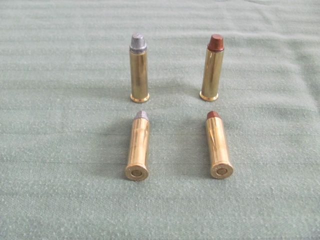

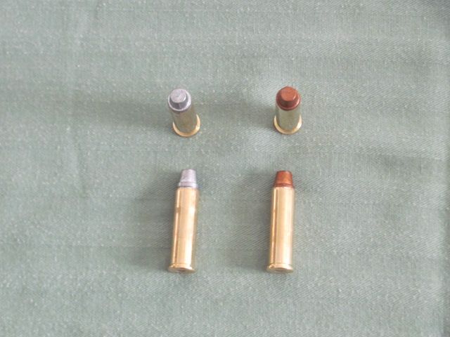

Post by JEBar » Wed Oct 26, 2016 9:10 pm
for those who may be old enough to remember, per Ricky Ricardo, "Splain it to me Lucy" .. ;) .. in testing loads for our grandson's Henry 357, we have come across some numbers that present a bit of a puzzle .... in the pictures below, on the left, Oregon Bullet Company 158 grain SWC, 38 caliber ==> http://oregontrailbullet.com/shop/<== on the right, Missouri Bullet Company 158 Grain SWC, 38 caliber ==> http://missouribullet.com/details.php?p ... &keywords= <== the same powder and primers, loaded in the same session .... fired from the same Henry 357 during the same shooting session .... Chronographed 10' from the muzzle .... the average muzzle velocity for 10 rounds with Oregon Trail bullets was 1,510 feet per second .... the average muzzle velocity for 10 yours with Missouri Bullet Company bullets was 1,300 feet per second .... I have no clue why there was a 210 feet per second difference ... :?:

Re: Back In The Saddle
Post by Jdl447 » Wed Oct 26, 2016 9:42 pm
Just a guess but I would say the absence of the lube groove is causing more friction.
Post by clovishound » Thu Oct 27, 2016 10:34 am
Well, unless I am sadly mistaken, one is a cast bullet, and the other is a coated bullet. While you are supposed to use the same loading data, the characteristics of the two bullets are different. Different friction in the barrel, perhaps slightly different diameters etc. Don't know if the absence of a lube groove would make a difference, but it might. The only way to be sure would be to try two bullets with everything the same, except for the presence of a lube groove.
Coated are not quite the same as cast.

Post by JEBar » Thu Oct 27, 2016 1:29 pm
I believe that you are correct .... one is a cast lead bullet, and the other is a coated lead bullet .... the coated bullet is marketed for high muzzle velocities .... the cast lead bullet is also marketed to not lead the barrel with higher velocities .... both group within a couple of inches at a distance of 50 yards
