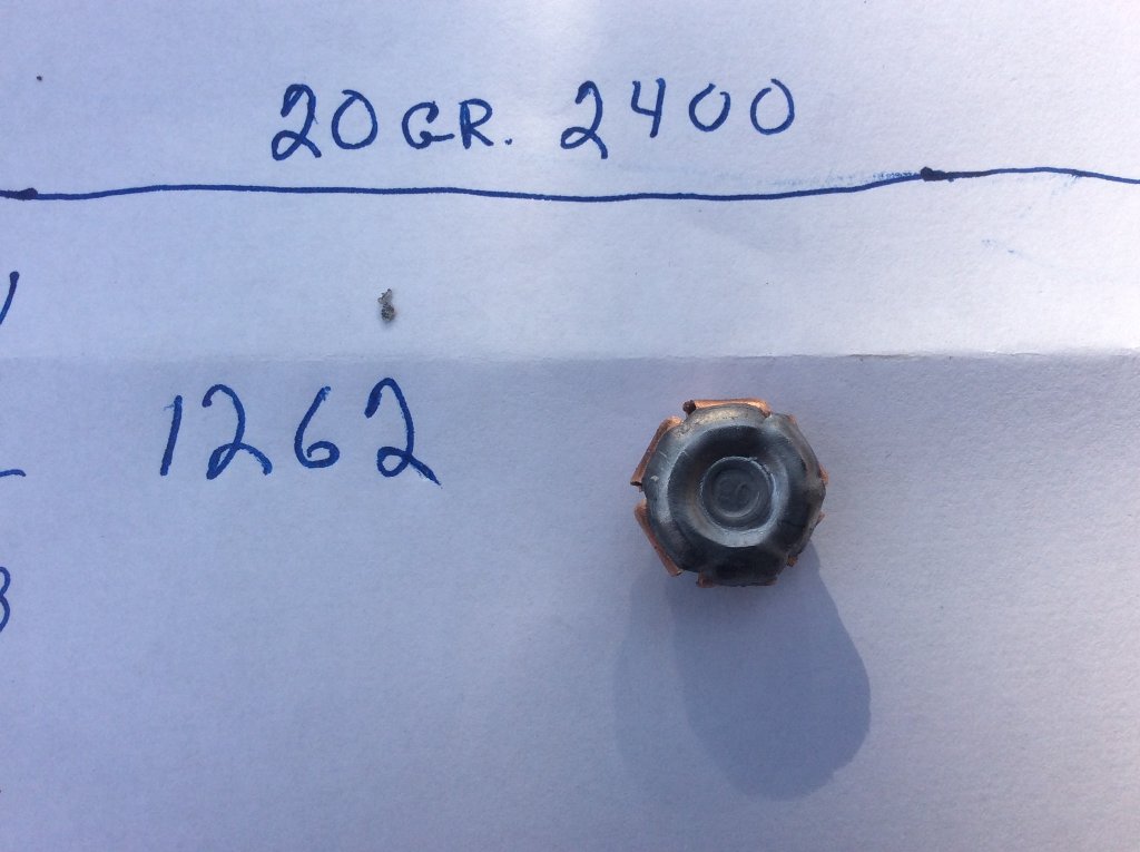

Post by fortyshooter » Wed May 04, 2022 11:12 pm
Here is a gel test result of 45 Colt 200 gr. FTX bullet. Fired out of my Ruger BH Bisley with 5.5 inch barrel. 16+ inch penetration and 1262 FPS.
.625 expansion. These are rifle bullets so less expansion at these slower speeds but still plenty!

DsGrouse
Posts: 1577
Re: hornady LeverEvolution 45-70 brass trim
Post by DsGrouse » Thu May 05, 2022 8:30 am
That's with the tip clipped?
Post by BruniX » Thu May 05, 2022 9:20 am
Yes quote are given with clip point .
i don't want to remov it, because this test with FTX is not to hunt, but to test ballistic curve .
