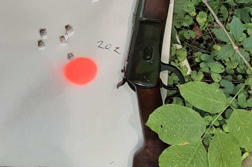

I use 20.6 gr of IMR 4227 with a OAL of 1.590" with Hornady 250 gr XTP for rifle.
