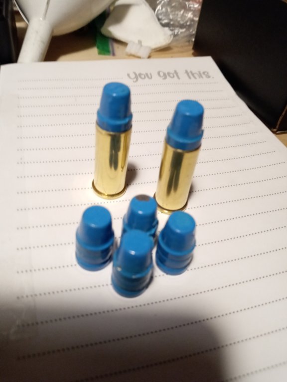

Well,I think l have if figured out. Those 245 gr 44 bullets
hard cast can not be pushed over 1000 fps in the rifle. I loaded them in 44 special and at 978 fps they worked great at 50 yards. Anything faster and they will start to spread out again. These I powder coated.

good to hear you've isolated resolved the issue .... they sure are pretty ;)
