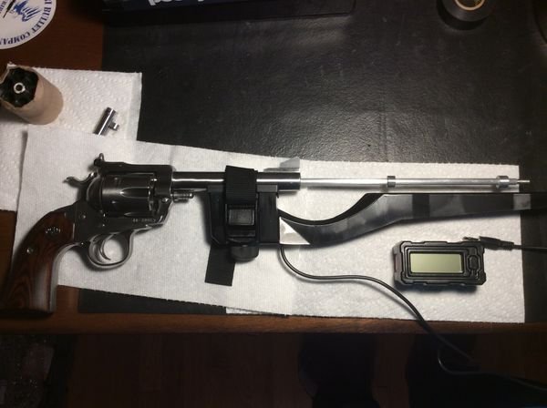

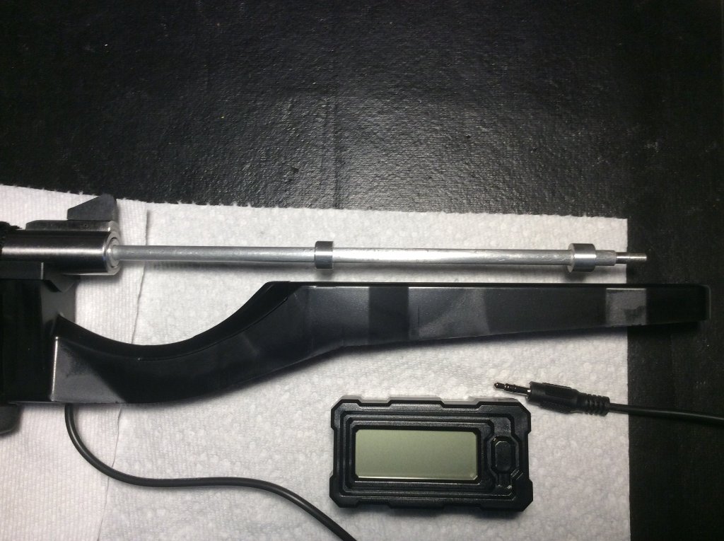

Got my unit in today and set it up on my Ruger Bisley BH 45 Colt/ 45 ACP. Will be comparing .45 ACP loads using Standard & Magnum primers.
To make setup easier I machined up 2 aluminum bushings measuring about .441 to just slide into barrel. These have a .250 dia. hole for a slip fit 1/4 inch aluminum rod. Then another pair of bushings that are bullet diameter at .452 which slide on end of rod over the speed trap bar.
Set gap at 1/8 to 3/8ths inch between bushing O.D. and bar keeping bar within 1/16 inch of being straight. I have a 5/32 inch gap which should be fine using the thicker mounting pad.
I did remove the case ejector rod housing to let the strap have a better grip on barrel.
So will get down to the range in a few days after I load up some test rounds and see how it works.
Will be adjusting my 230 gr. 45 ACP load using 6.0 Unique down to 5.5 gr. for first test using the CCI 350 Large Pistol Mag primers and compare to the standard primer load of 6.0 Unique.
Right now all I have is the Mag primers for .45 ACP and .357 Magnum loads.

Now you don't have to set it up the way I did but having a machinist background it was easier for me just to make up a setup gauge.
At least the sky and sun conditions will be out of the picture and I can set a target out to whatever distance and not worry about taking out my optic type chrono.
