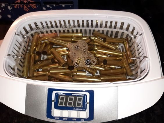

hi, i use ultrasonic cleaner, same model that is rebranded by lyman, but less expensive.
(found on internet, original model is Codyson CD4820
ultrasonic cleaner.jpg (52.72 KiB) Viewed 3279 times
very hot water with two large spoons of coarse salt, and 20 cl of white vinegar
After 16 minutes, cases are very clean.
The water is black at the end!
a good rinse with clear water and drying overnight to finish, or oven at 55 ° if you are in a hurry.
When I have time, I sometimes pass the product to clean the brass, in order to make it look like new ... :D

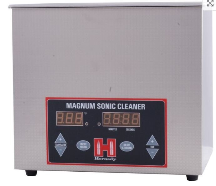

I have used the Hornady Sonic Cleaner for about 7 years. My unit is the original Hornady Sonic Magnum, all metal which is now discontinued and replaced with the unit you are looking at. I heat the solution to 140 degrees and vibrate for 30 minutes.
Hornady SonicJPG.JPG (43.12 KiB) Viewed 3255 times

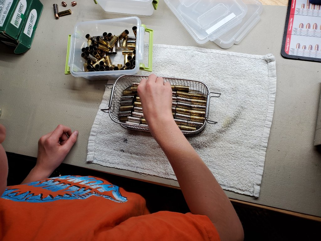

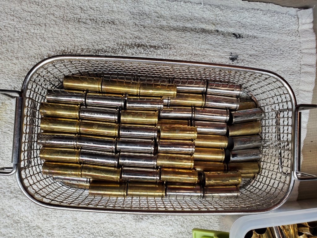

I also use Hornady's One Shot brass cleaner (comes in 1 gallon jug) that will last you a long time. I disagree also that you can only clean a handful of brass. I task my grandson to place my brass in the basket. Of course everything has to be done in an orderly military manner so he took it on himself to line each case up ! Depending on caliber (Picture is of 45 colt and .357 brass) I can clean around 200 cases per cleaning, and usually can use the solution twice before it is too dirty.
User friendly and I like the results. As always, chevy's vs Ford's vs Dodge. Some like wet tumblers, others dry tumblers, others sonic cleaners. For me, this works the best, least mess and easiest to use.
Oh, by the way, when done I dump the basket in a 5 gallon bucket using the Frankford arsenal media seperator (7.99 at midway) and rinse with fresh water, then dry.
