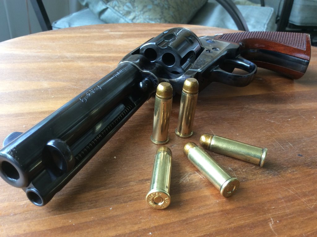

The nice looking 158 gr. RNFP "Cowboy" bullets from Missouri Bullets came this morning and loaded up 50 to try.
I loaded these with 5.5-5.6 gr. of Power Pistol for use with my .357 Evil Roy six shooter. Like the look of this bullet and the flat nose
for getting energy to the steel knock over targets.
This bullet really looks fitting for a Western style six shooter!

Looks good forty! Are you able to get out and shoot? I'm using same bullet with 4.5-5.0gr Unique. Fun loads. Enjoy them forty, bet the shoot good. Be safe out there.

Good looking ammo and revolver.

Would somebody get Forty a towel hes made a mess on that table

Those are character marks...patina! :lol: Actually the bottom of old bar stools to which I added a top. I have several of them and use for a table or stool! Need to get me one of them cute towels one day.
