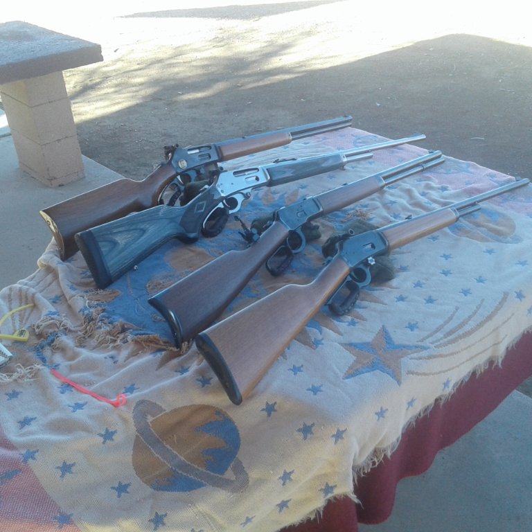

Chronoed a 22 in barreled Zane Grey Century (Micro-groove rifeling) and a 24 inch barreled XLR with Ballard rifeling.
ZG.
1484.
1473
1517
1497 ave.1494
XLR
1528
1544
1553
1547. ave 1543
50fps faster in the 24 inch barrel. Interesting.
I want to get 1700 fps.
The 30-30's are at the top.

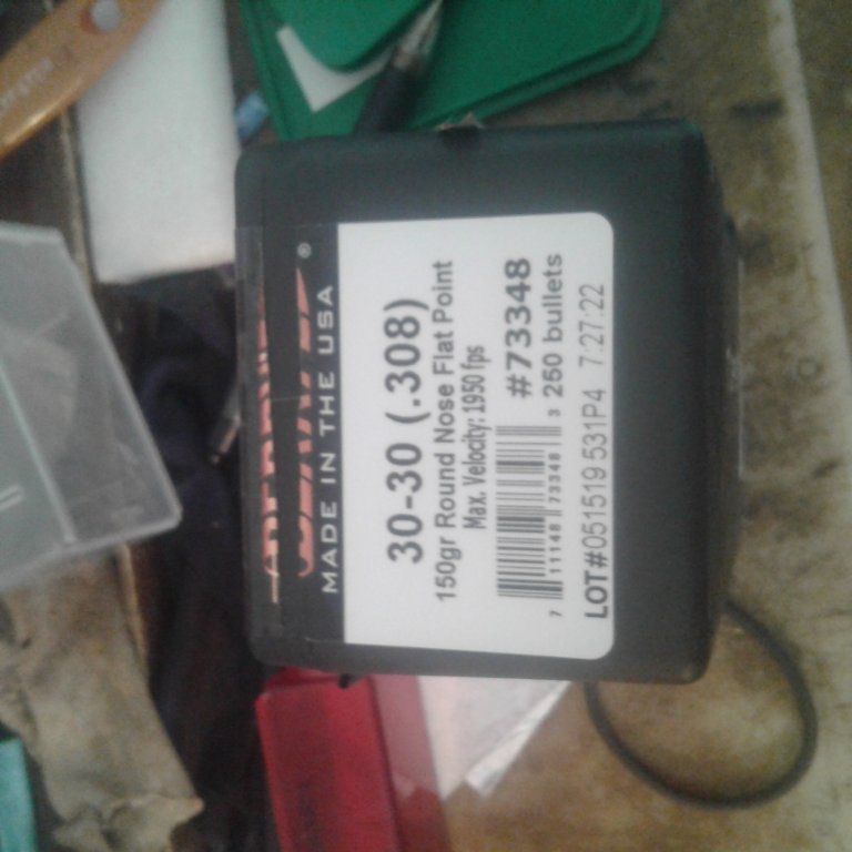

Post by Ojaileveraction » Mon Jan 06, 2020 1:30 pm
The Barry's 30-30 is rated to 1950fps.
Mistered
Re: 30-30 Berry's plated
Post by Mistered » Mon Jan 06, 2020 1:33 pm
Thanks for the pic!
This Is good to know!
