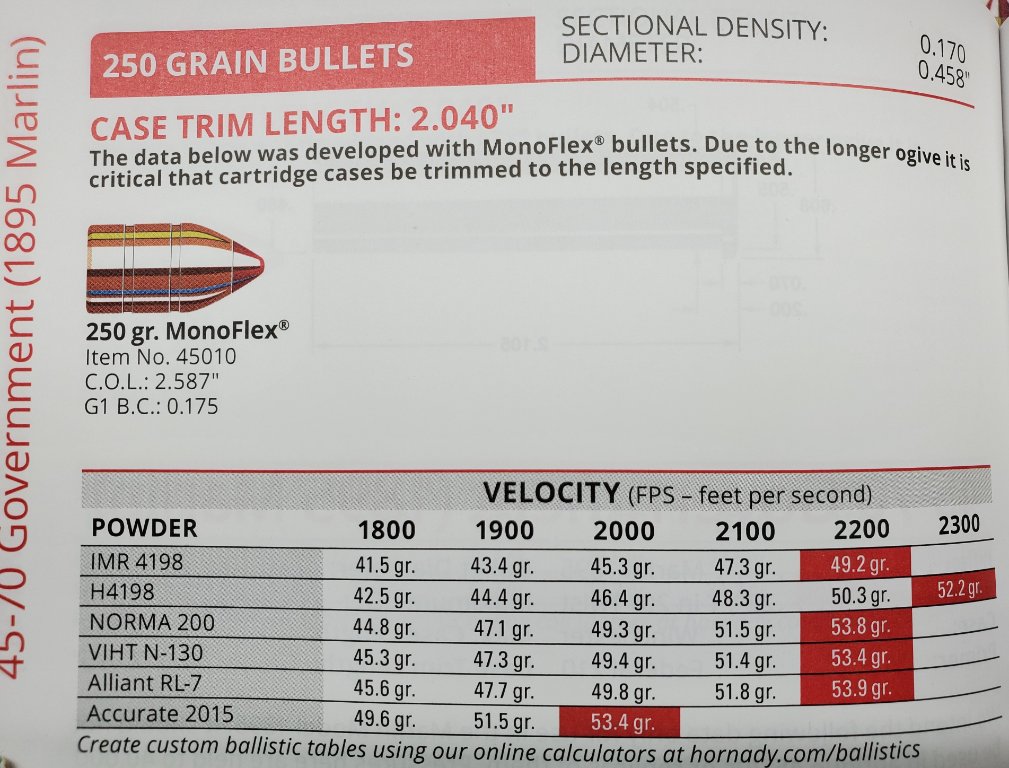

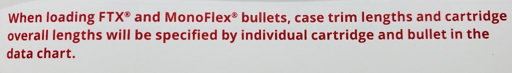

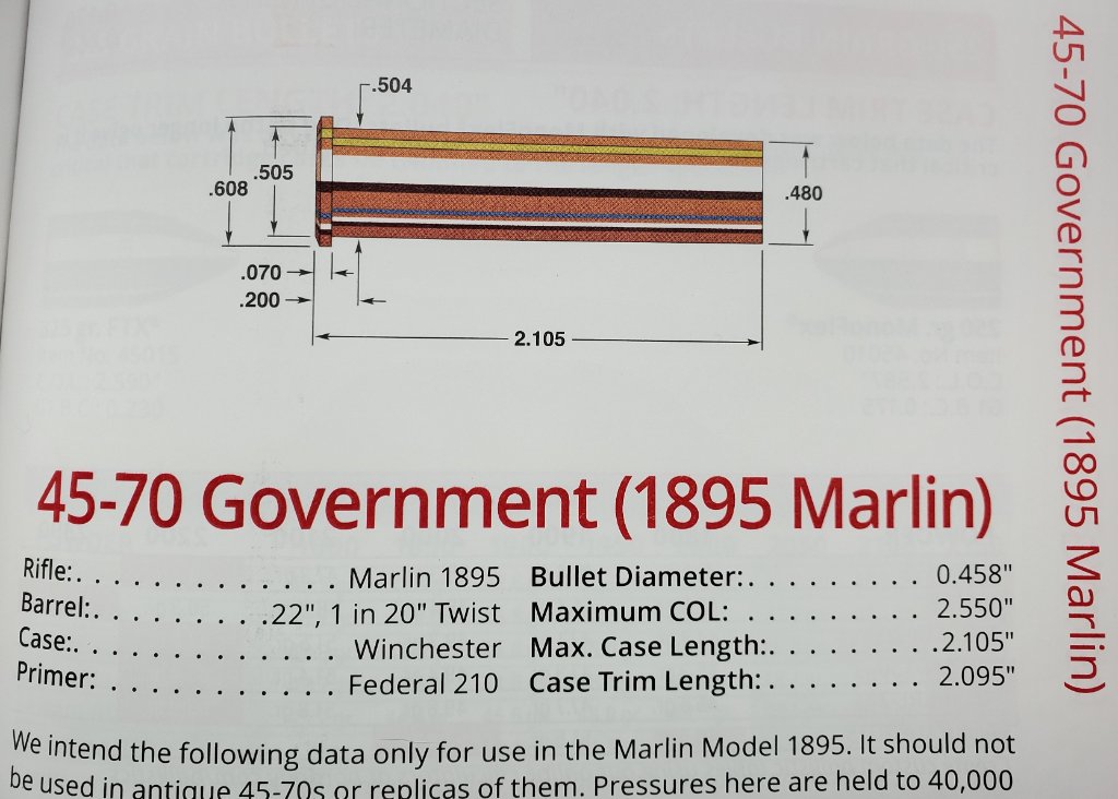

Brunix, here is the data directly out of the latest Hornady book. You can use the standard 45-70 casing, but it must be trimmed to length specifically for the flex tip from 2.105 to 2.040
I hope this helps you.
