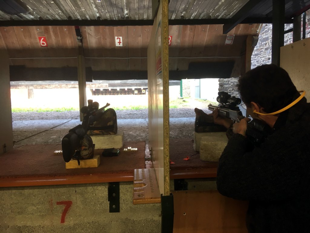

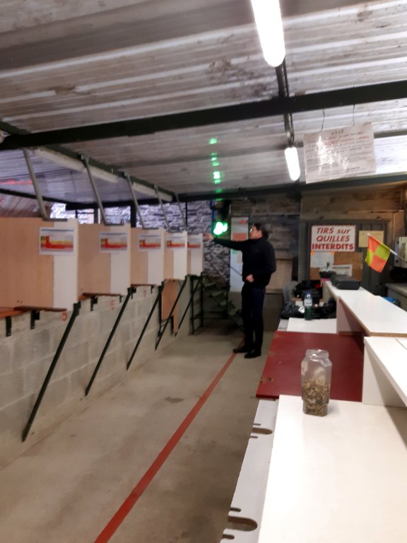

inside the range :
Reclining at 100 & 200 m (94.4 & 188.8 yards)
in 4 rounds he adjusted his optics :
not bad for the first time ...

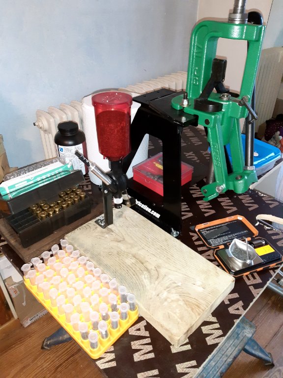

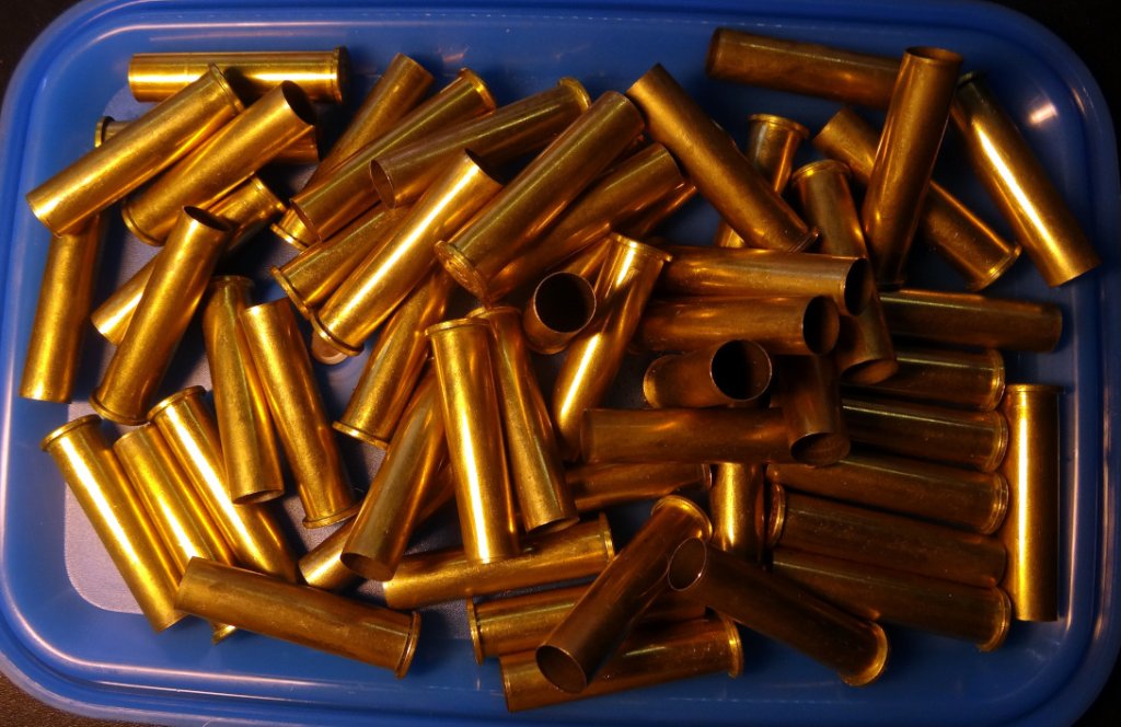

so last night, reload!
Tools, (at least part of it)

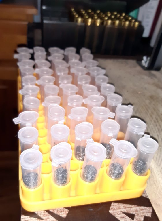

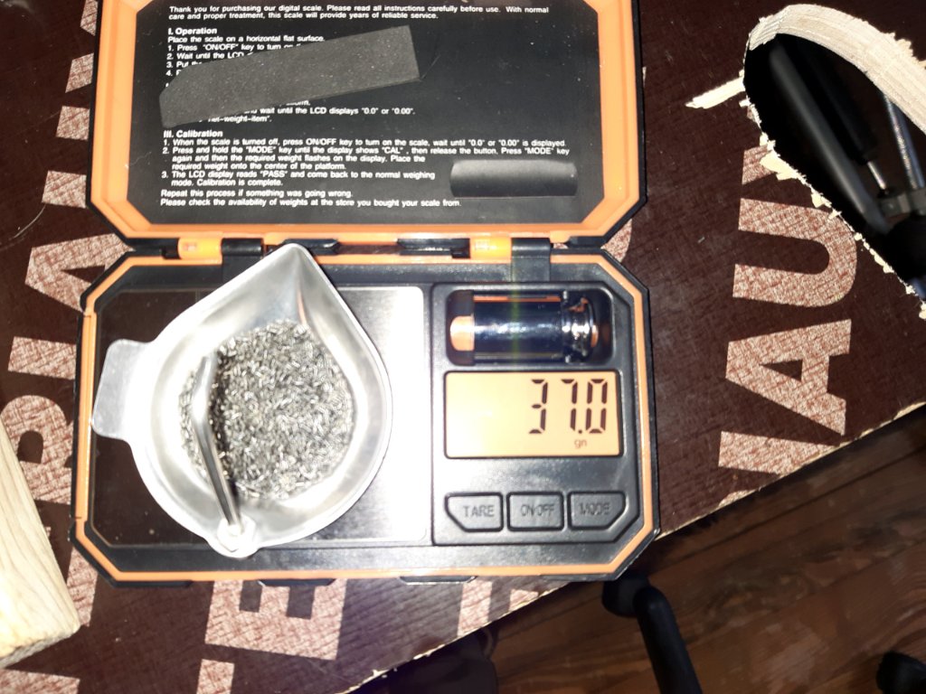

I use test tubes for powder doses, very convenient!
at a glance to control all the loads, and the diameter of the tube is exactly that of the cases 45-70, practical to put them in ...

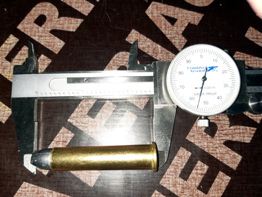

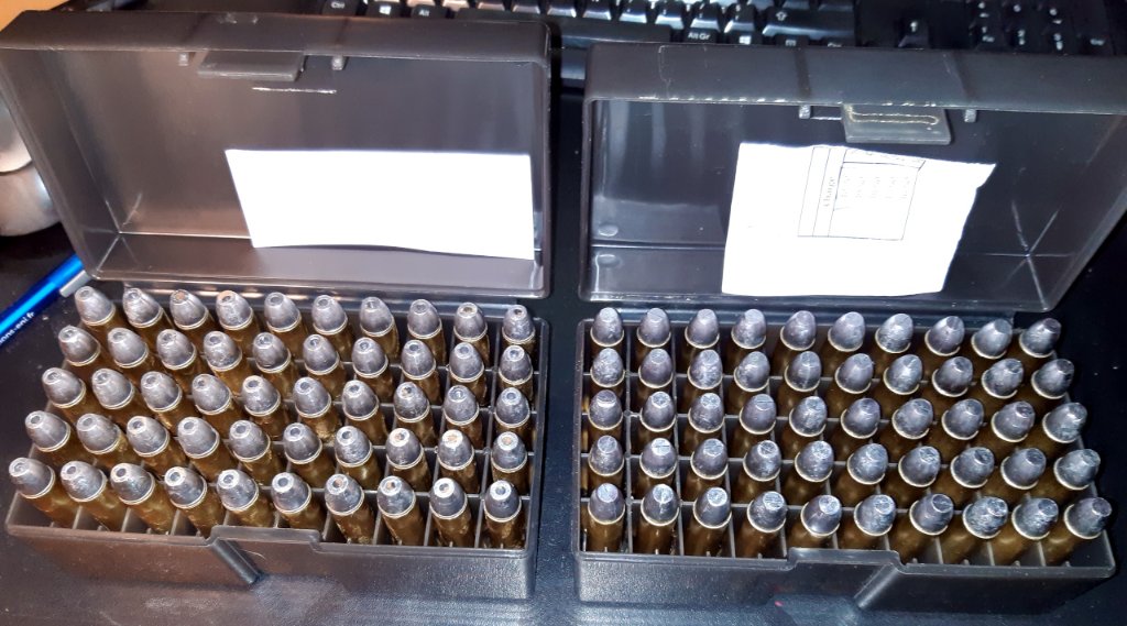

three series,
one of 405 grains hard cast loaded in 40 grains IMR 4198
one in 330grs HP in 37.5 grains
one in 405 grains, less loaded in 37 grains
Overall length at 2.55
next day at the range 200m in December, I hope ...

Very nice work, BruniX.
Those lined-up reloads look great. And what a cool idea using test tubes for powder drops and that the container size matches the 45-70 brass so well.
Thumbs up...You've pulled it all together!

Great looking rounds, anxious to see how they preform for you.
