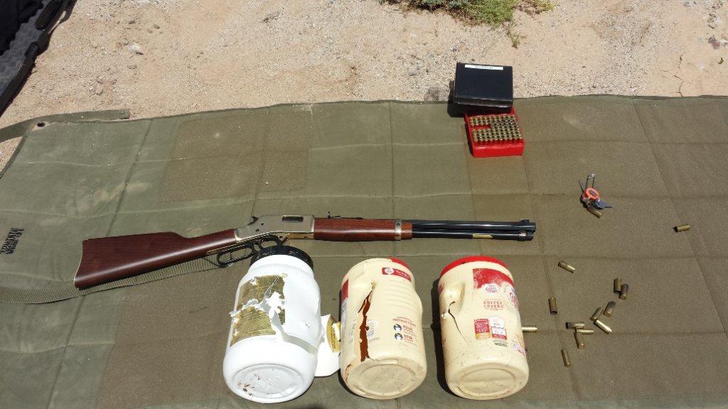

Next week will be reload week. I have the family coming out for the xmas holidays, everyone has a Henry, Vaqueros, Blackhawks, etc. I have a lot of work to get to.
I want to thank everyone for your input on your favorite loads. I wanted to burn up my remaining 100 rounds so I can maximize on brass next week and try some of the favorites you all listed.
I had three jugs that needed to be recycled, so I filled them with water and had at it.
I was shooting my .357 Big Boy with 13.3 grains of Aliant 2400 pushing 158 grain Hornady JHP XTP's. This has been my favorite plinking load.
Mission accomplished, jugs are duly recycled !
