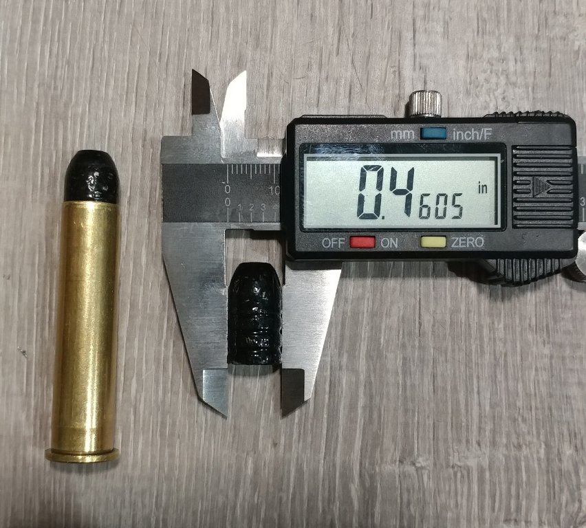

GaHenryFan
Posts: 198
Joined: Wed Aug 02, 2017 9:02 am
Location: Middle Georgia
Re: hollow point version mold , main use and why not in 405gr ?
Post by GaHenryFan » Thu Oct 03, 2019 5:37 pm
BruniX wrote:
Thu Oct 03, 2019 3:01 pm
@garyfan
very nice mold !
.460 , it is 11,6078 mm....
is it for the 45-70 :?:
45-70 is often .457...
.460 cast is all I shoot in my Marlin 1895g. It's very accurate with them too.

220
Posts: 1028
Australia
Post by 220 » Fri Oct 04, 2019 4:14 am
I have a NOE 405 WFP it throws 370gr as a HP. my marlin loves them, works well on game as well.
GaHenryFan
Posts: 198
Post by GaHenryFan » Fri Oct 04, 2019 11:24 am
BruniX wrote:
Thu Oct 03, 2019 11:48 pm
ok !
do you use a sizing die ? from Noe h or other ?
I have not found sizing to be necessarily. My Lee mold drops them around 458 and they are 460 after powder coating. They chamber and shoot great for me.

Post by GaHenryFan » Fri Oct 04, 2019 5:16 pm
BruniX wrote:
Fri Oct 04, 2019 2:30 pm
interesting !
do you have take mesure of barrel before ?, is it necessary, or direct test chamber ?
the mold (C460-429-RF-BA2-106) seems to be very cool...
do you think that the gas check is important, in 45-70, allows it to gain in velocity ?
I know that on 357 magnum for example, it's essential, but on the 45-70, I do not know...
thanks, gahenryfan !
My barrel slugs exactly .458, but the .460 bullets work fine. I cast with fairly soft lead (cowboy action range scrap) and powder coat everything, so I don't use gas checks. I rarely load anything over 1200fps.
