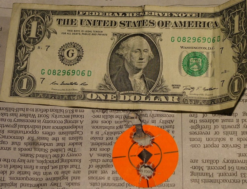

FYI-
A great kids & plinking load for the 45 BB is to use the common 45 ACP FMJ 230g. Use the top ACP load of Unique, Bludot, Universal, etc. Here is a group at 25 yards with an RMR plated bullet over Universal:

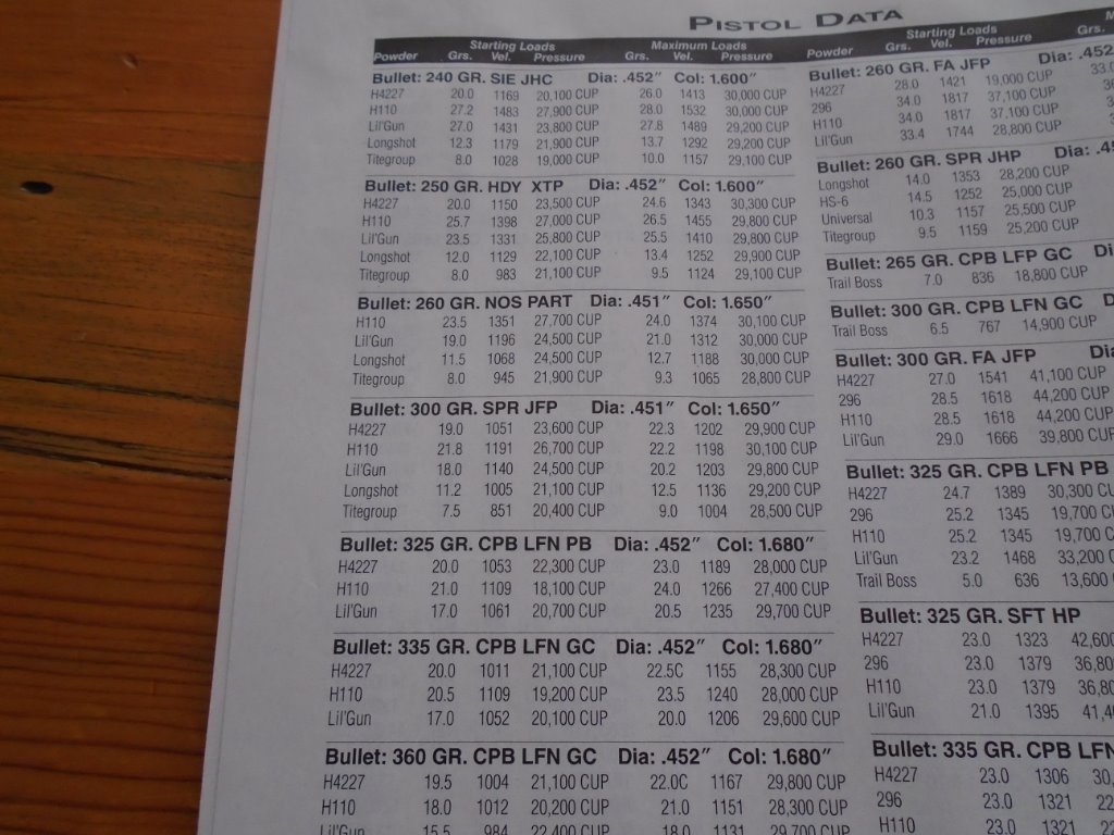

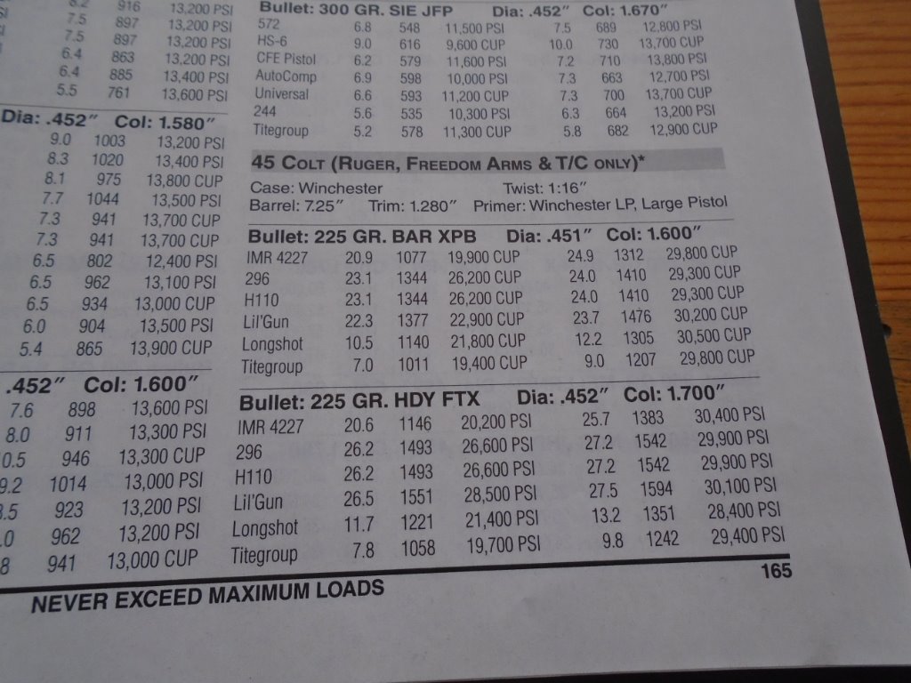

Copied from another thread:
Pic's of Hodgdon's 2018 Annual Manual; Remember most if not all Henry's are rated for 45C Ruger pressure loads. Note barrel length, bullets & weights, COAL and pressures (PSI & CUP):
