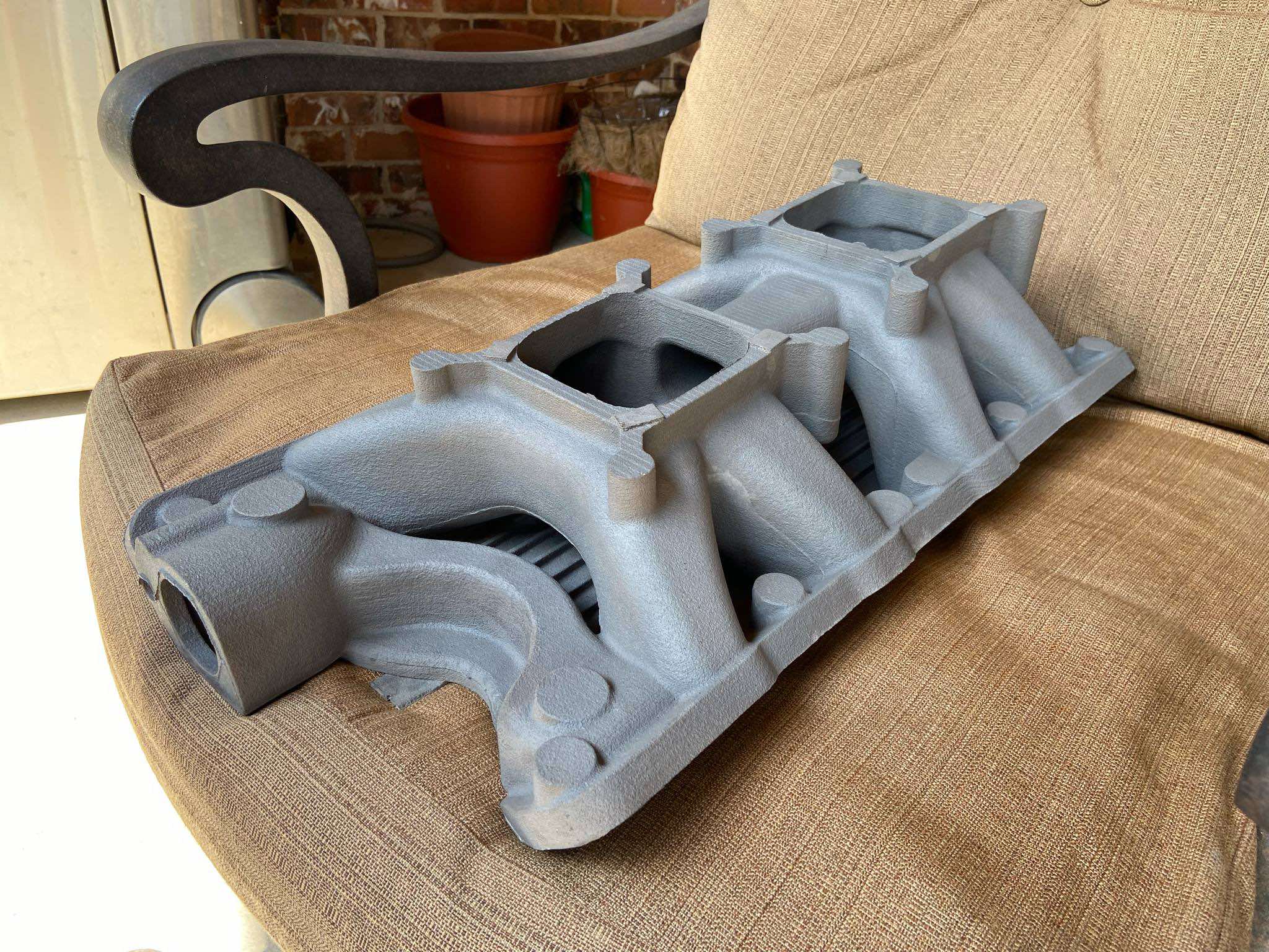

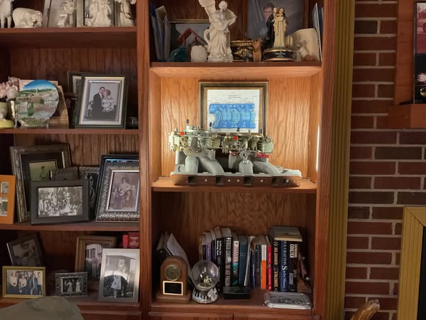

Well for 15 years ever since I built my Ford 427 Windsor engine I have wanted a dual 4 bbl. setup on it. Found one guy 10 years ago that made the only one available for a pair of Holley carbs and it was like the Ford FE 427 low riser. It ran okay but lacked some top end power. What I really wanted was a copy of the Ford factory race piece the 427 Tunnel Wedge intake that was available over the counter back in 1969. It is a unique piece that was a copy of their 1967 Tunnel Port intake for race use with the matching tunnel port heads. The tunnel wedge was for the standard 427 heads.

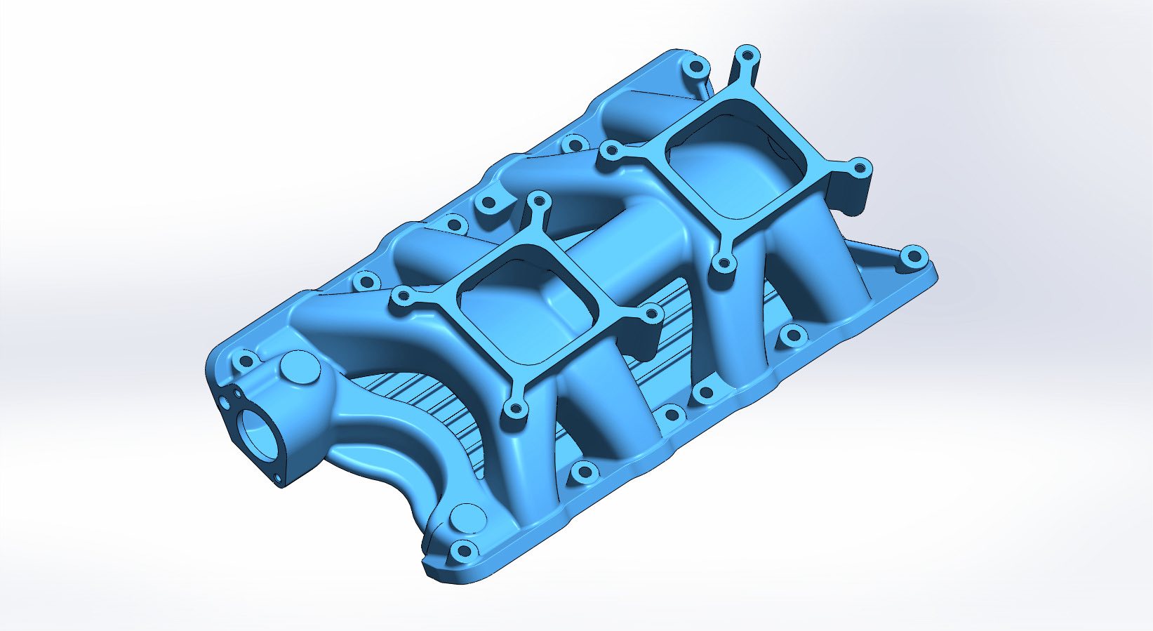

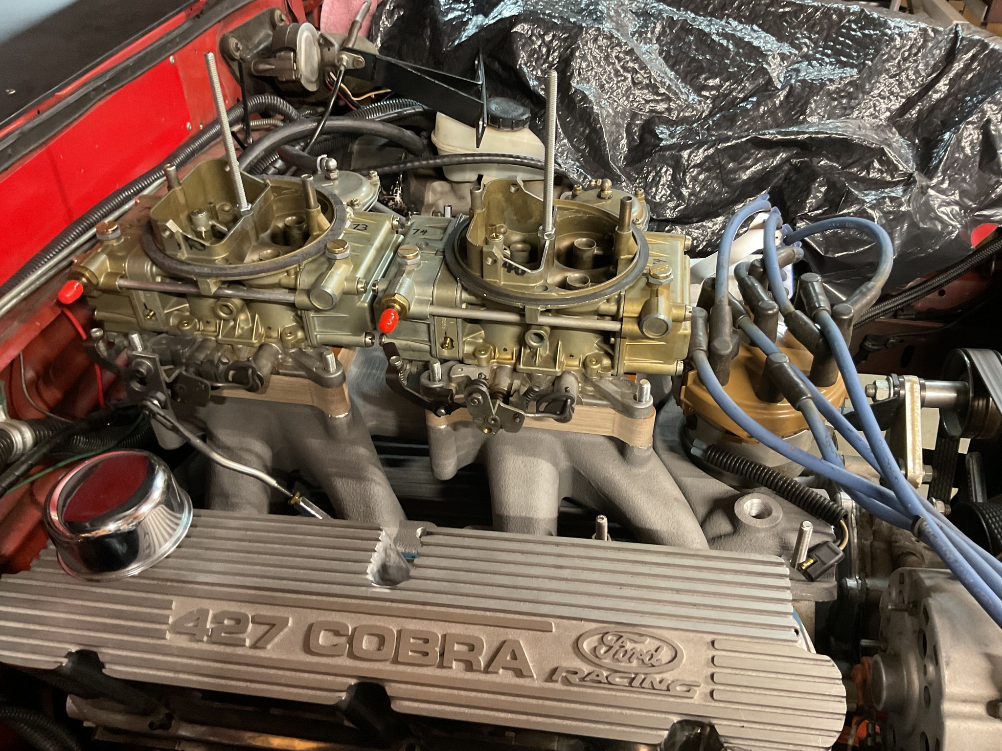

So for 15 years I had been contacting the big aftermarket manifold makers to build one for the Ford small block Windsor engines the 351W and nothing but crickets ! Finally back in May this year I was on a F'book Ford engine forum and happened to mention my idea for this intake to a guy that makes intakes for the Boss 302/351 guys. He thought about it and said that is a damn great idea and within 3 days he had CAD prints made up using some info and measurements I gave to him. July 30 I had two of those manifolds delivered out of the 5 he had cast and machined....one for GO and one for SHOW ! Thing is a piece of automotive art and I am setting it up with my pair of Holley 770 cfm carbs for my engine.
A lifetime dream fulfilled having your own design intake manifold made! Yesterday one of the other guys who bought one had a dyno test run comparing it to an Edlebrock Victor Jr. race intake with a single 830 Holley and my Tunnel Wedge intake beat it by 30 HP by 6400 RPM!!
Needless to say I am VERY HAPPY and in process of finishing the tune on my 427W !

Where did those valve covers come from? they bound to be another specialty item.
Seeing how all original 427s were of the Big block design.

Ford had them in their parts catalog several years ago for their 427 Windsor crate engines built on their heavy duty race block. I built mine using the large bore Windsor race block from Dart Machinery products....built like an anvil! The 351 Windsor has been very popular for 10 years to bore and stroke to larger cubic inches and be lighter than the 390-428 Ford big block FE engines. Cylinder head technology in the aftermarket has reached levels of flow that allow big horsepower.
