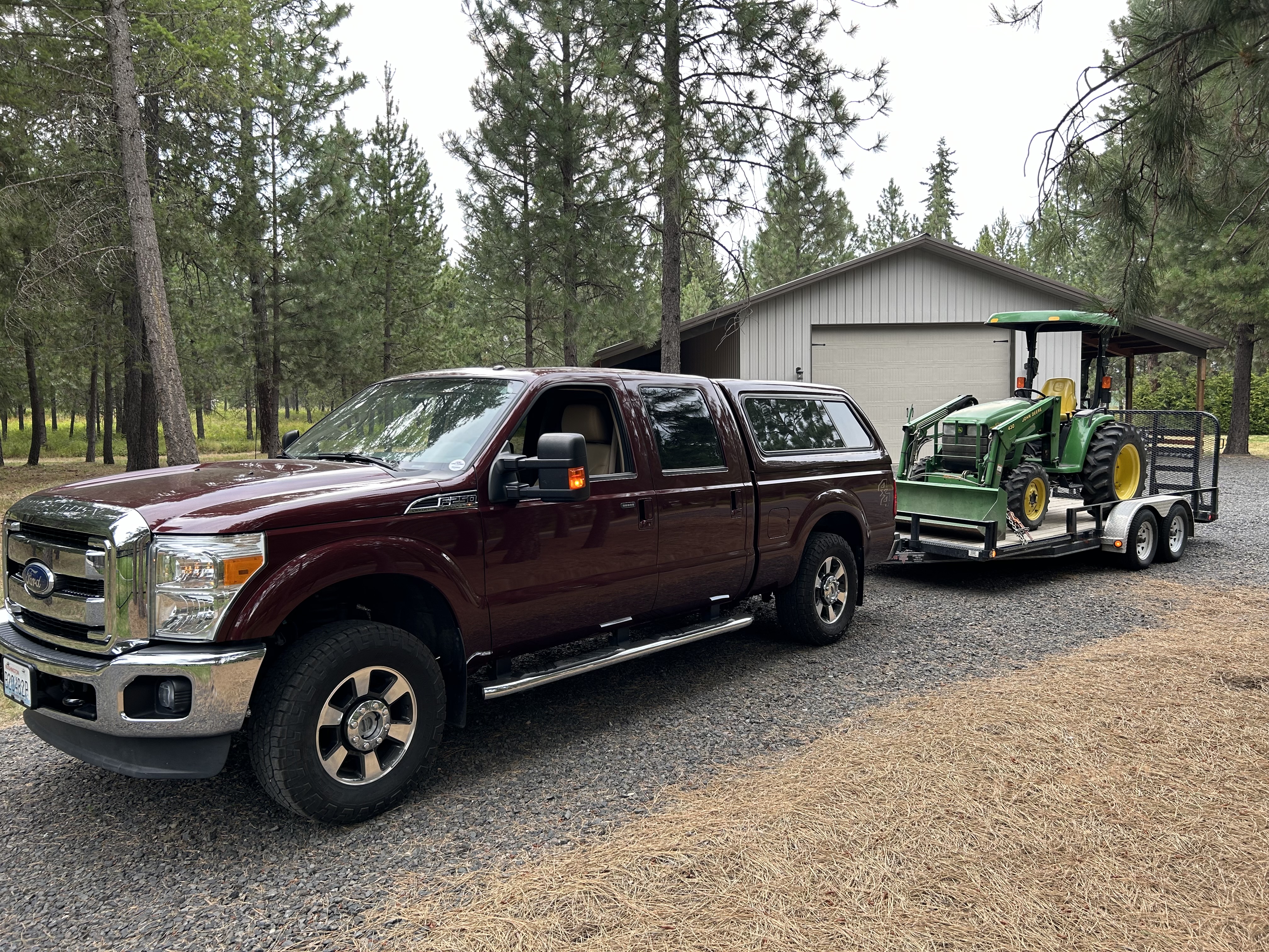

Even when towing my tractor using chains and binders it will work loose. I have learned to stop after around 15 minutes of driving and check the chains. Back in the day when I was a working guy I used to load trucks. Mostly I loaded flat beds with side curtains and the driver would strap with 4” very heavy duty straps. I was told by drivers that they were required by law to stop and check the load after “x” amount of miles. (Can’t remember exactly what the number of miles was). I do the same thing when towing an atv using straps as I do with the chains.
Hard to see in this pic but there is a chain running thru the loader and another at the rear of the tractor attached to a clevis on the drawbar.

Hatchdog - Good lookin' truck.

HenryFan wrote:
Mon Aug 26, 2024 6:41 pm
The tractor is better :mrgreen:

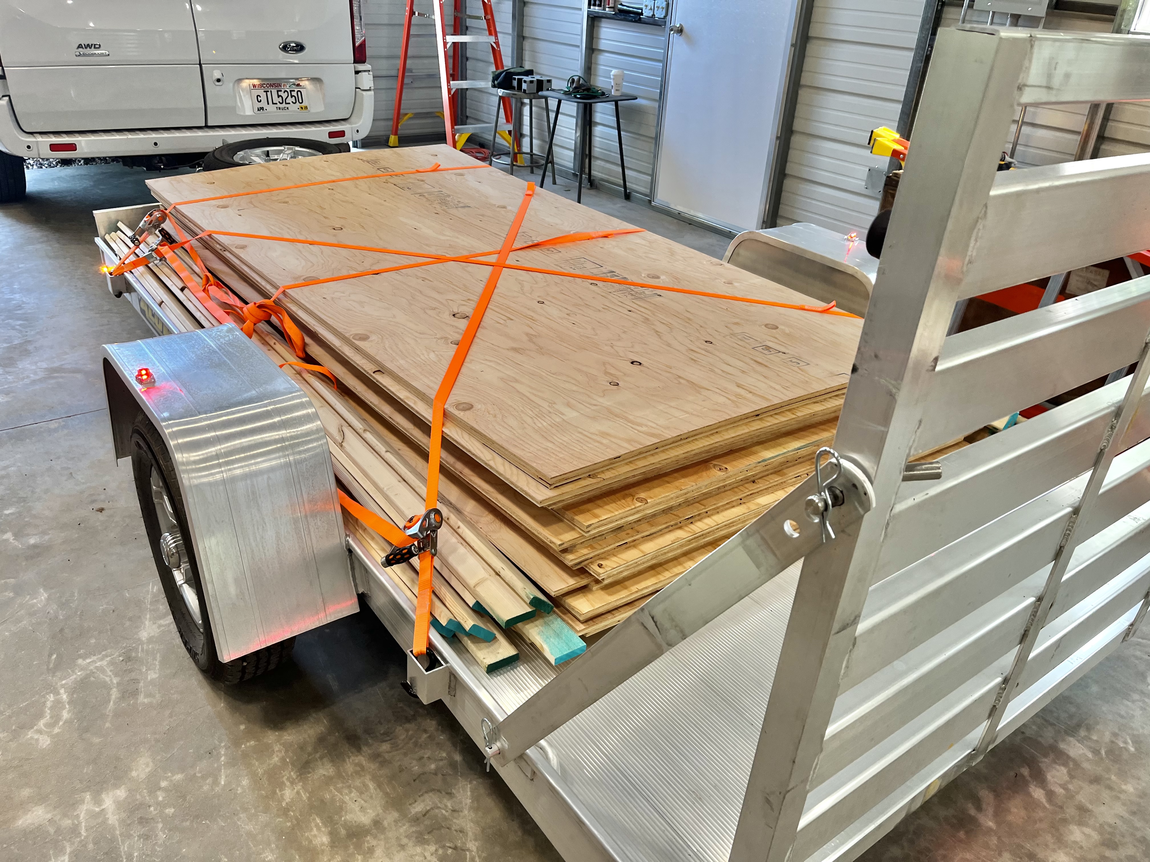

Post by Sir Henry » Wed Sep 04, 2024 11:40 pm
These stamps worked great for me. They didn’t loosen any in a short 40 mile trip. I snugged them tight but could have easily ratcheted them another three or four times.
