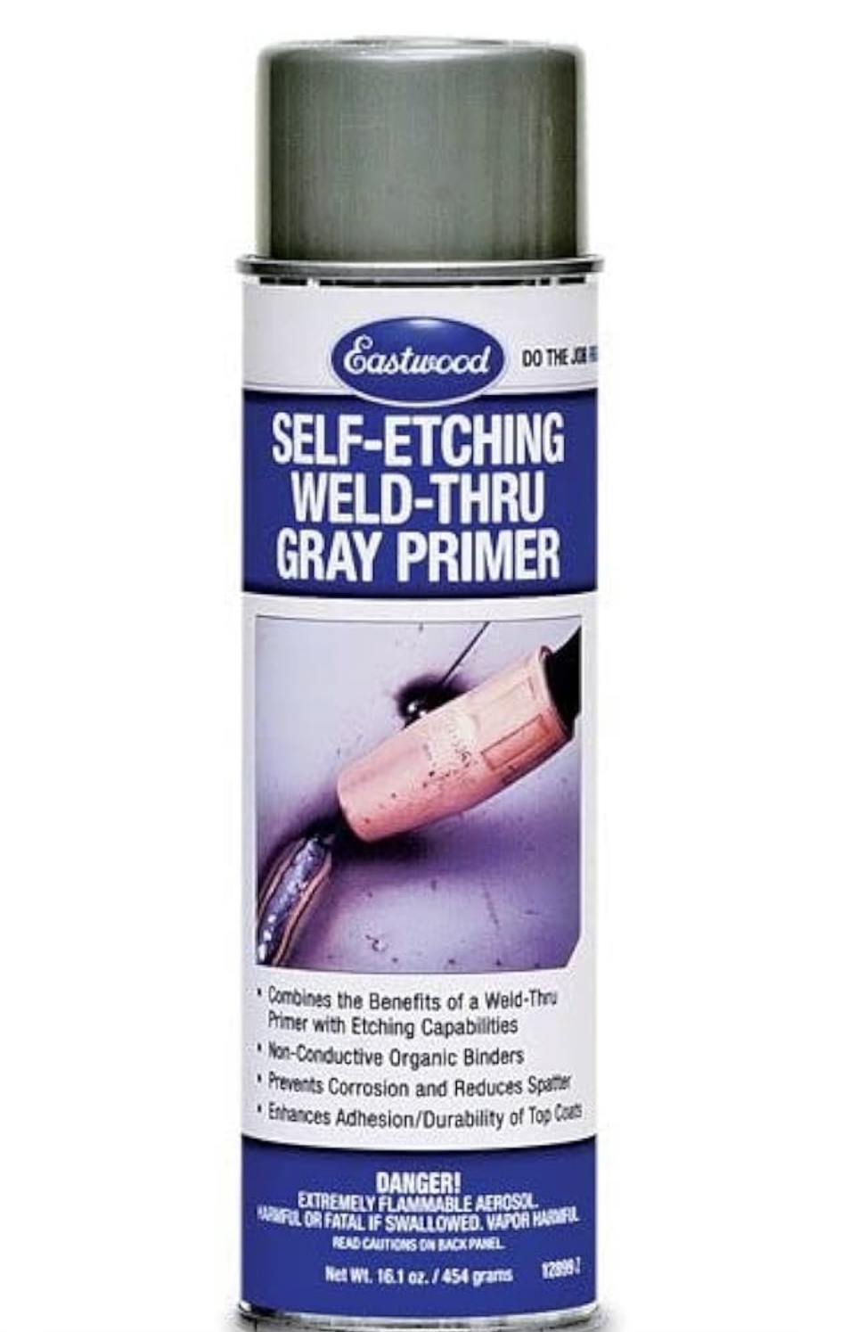

Post by Sir Henry » Sun Aug 04, 2024 3:48 pm
Get something like one of these.
https://www.amazon.com/Eastwood-Durable ... 674&sr=8-4
