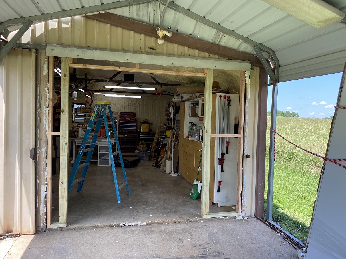

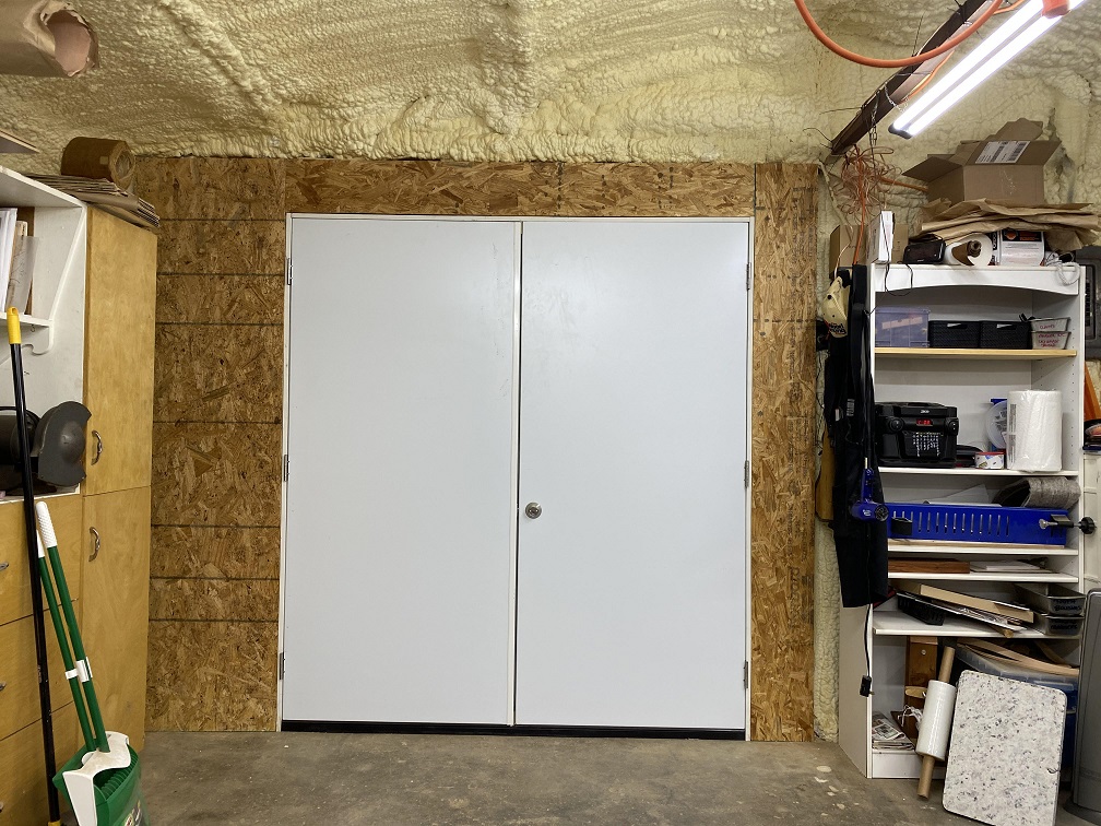

When we first added the mini-split, I found that the huge roll aside metal door tended to moved in and out in the track, exposing a gap of up to 2" on the bottom and sides. This didn't make for an efficient seal around the door. :? The mini-split was properly sized for the shop but couldn't hold a constant temp with the air coming and going at will. I locked the roll aside steel door, and got about six cans of expanding foam and sealed the edges. This meant I couldn't open and close the door without first cutting the foam seal, then cleaning the track at top and bottom. It hasn't been opened since I sealed it eighteen months or so ago.
It had always been my intention to remove the big door, and put in a wall with a more sensible door since I wasn't going to be bringing in vehicles. Maybe some wood. About six weeks ago, I ordered double steel security doors.
We had an ongoing project in Miss Tina's new coop, so the door got secured out of the weather, tied against the outside of the roll aside door under the carport, and we concentrated on the coop. Yesterday, I started prepping the inside of the shop to frame the wall. First clearing the foam and the stuff in the way so I could work. Then after many measurements.... I cut the first three, most critical pieces... the top cross member and both sides. Test fitted them.

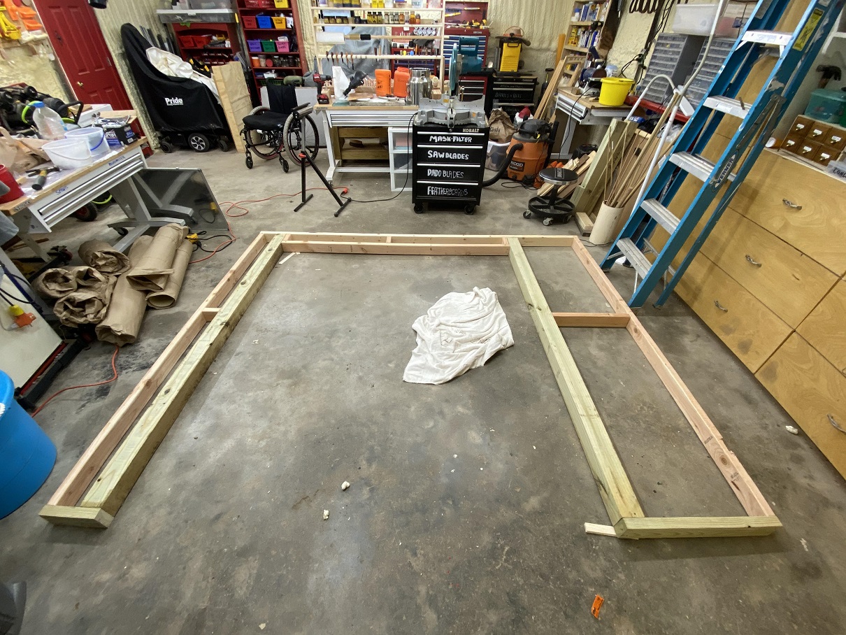

Once those fit, and using the measurements of the door with the spaces for the rough opening (extra half inch in height and three quarter inch in width per the directions,) I laid out and we built the wall, on the floor of the shop.
This distorted pic doesn't do the wall justice. It's nine feet wide, ninety inches tall, and the opening for the doorway is seventy four and three quarters wide by eighty two and a half tall. For now, the wall will sleep on the floor... we woke up at five thirty this morning to a heavy thunderstorm and it's rained off and on all day. I'll hope for clear skies tomorrow. I don't want to work outside in the rain.... even under the carport. It rains sideways in Oklahoma. :twisted:

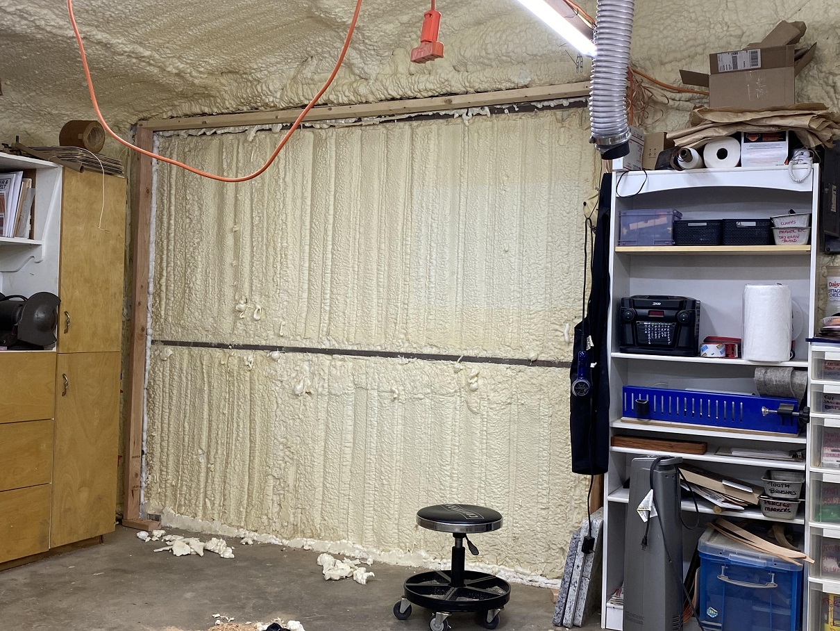

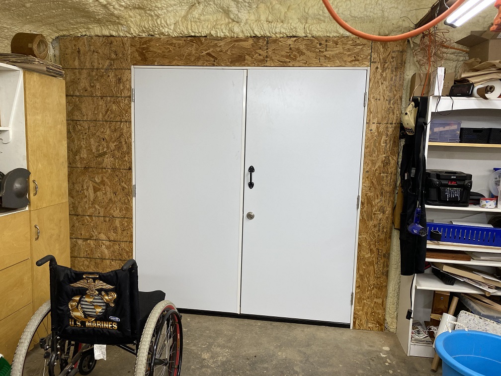

Got out early this morning and cut away that spray foam from around that roll away door. That was NOT an easy task. Since the foam expands, it had gotten up in the track at the top where the wheels roll, and the door still didn't want to move. About 40 feet of chain and the pull strap hooked to the Polaris Ranger in 4WD and the door moved sideways, but it didn't like it. :roll:
Luckily I will be removing the panels from the door and cutting away the frame. The panels will become a carport for the kayaks. The frame?

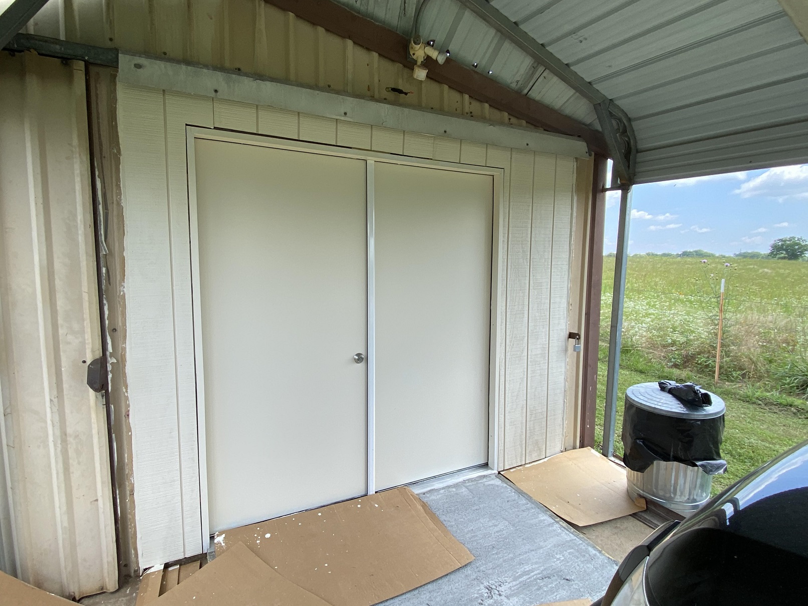

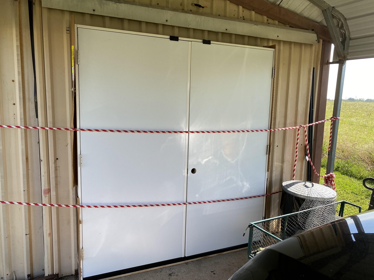

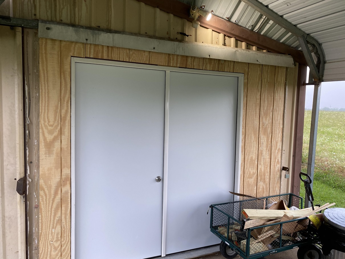

We got the wall stood up and fitted into the slot it was supposed to go into. We secured it in place with just a couple screws until a test fit of the door.
After removing the cardboard, several straps, and after the first try at fitting the door, we removed a 3/4 inch board they had stuck under to protect the threshhold during shipping. I was pleased with the fit as I had "Followed the instructions" and added the recommended spacing to allow shimming to make the door operate smoothly. An additional 3/4" to width and 1/2 inch to height.

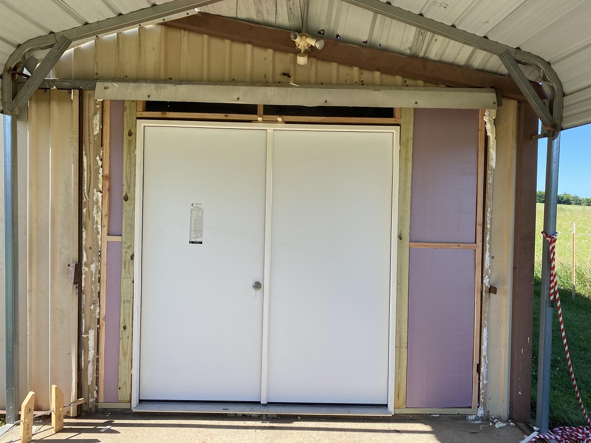

I used cabinet makers clamps to hold the door in place while I installed foam insulation around the door in the wall, while waiting for a buddy who installed and adjusts 50 to 100 doors a year. I tried shimming and centering the dang thing and just got madder and madder. :evil: Miss Tina wanted to burn the door. My guy showed up a half hour after we called and had the door swinging smoothly in thirty minutes. Experience counts. I paid him for his time on the Sunday afternoon... even though they didn't want to take the money. :lol:
Tomorrow Miss T and I will put up the Barn Siding on the outside and the plywood on the interior of the shop. (yes, we know there is a gap without insulation over the door. We finished that AFTER I took the picture.) Once the wood is up and the trim around the door, just painting is left to be done. :)

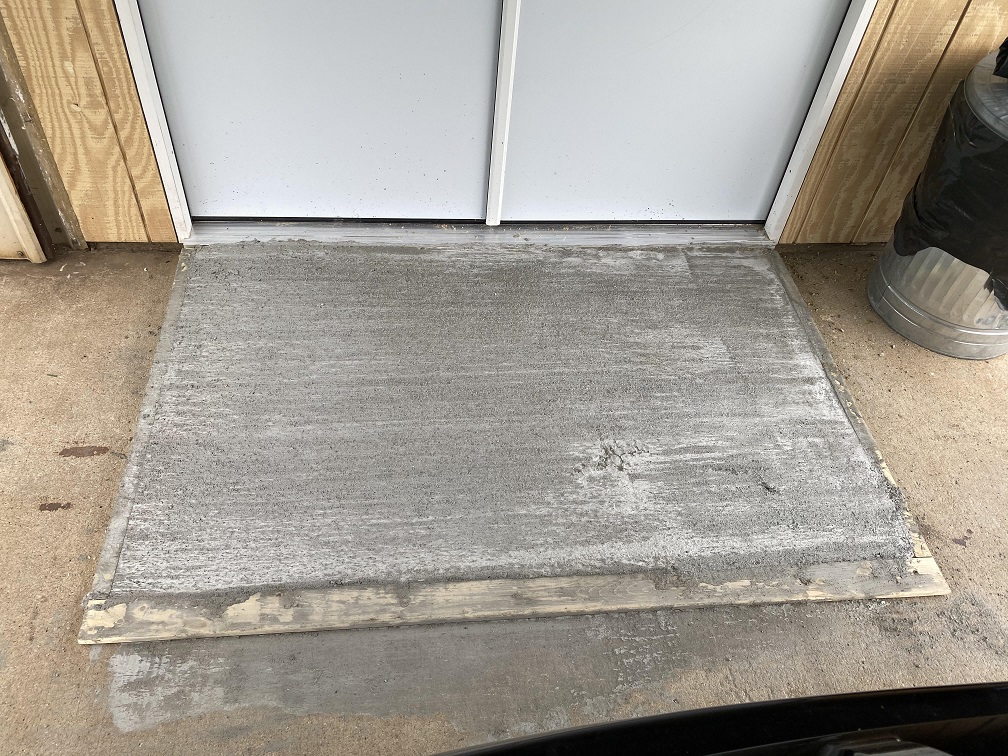

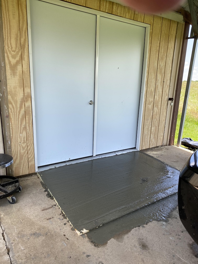

On the outside, I needed to add the ramp down to the carport level. On nice days, in the spring and fall, we have been known to roll the table saw, or the bandsaw out onto the carport to make large format cuts like panels of wood to give us more working room and to let the oklahoma winds blow the sawdust away. Reduces the cleanup.
The ramp goes out level for a foot, then drops from 2" to 3/4 inches over the next two feet nine inches. A gentle drop. Once the concrete sets some I'll do some cleanup. LOL.
We are NOT concrete contractors, so the slab isn't perfect, but it didn't cost $500 for the pour either. It cost less than $30. If it isn't pretty later, I'm not going to fret, it's the ramp to walk into the woodshop, or to roll equipment up and down or carry supplies in the double doors. ;) I can buy a lot of stuff with the money I saved.
Posts: 7473
Re: Upgrading my Wood/Leather Shop
Post by BrokenolMarine » Wed Jun 14, 2023 7:54 pm
Waited a few hours then went out and did a bit of cleanup, then broomed the surface. Still not perfect, but we'll check it out tomorrow and I'll add pics. I have to go to OKC to the VA Hospital for a couple of appointments. The ADT Tech comes to install the new alarm contacts on the new doors. I'll likely paint on Friday, the concrete should be set up by then. Pics to follow.

Once I got home, I worked on the ramp a bit more, it seems to have cured nicely. I nipped the exposed wire we used on this thin pour and got that taken care of and swept more of the loose dried concrete away. We'll stay off another 24 hours but I think we are good to go. Tomorrow I'll clean up the wood edges and leading edge. THEY will stay in place. (I designed it this way to prevent concrete crumble with the thin pour.)

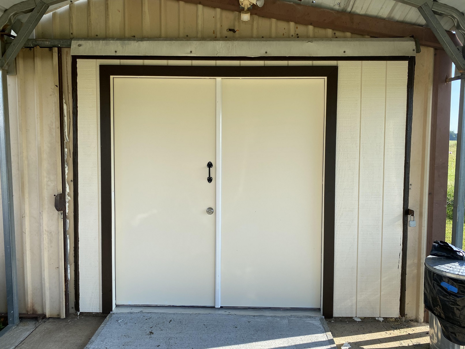

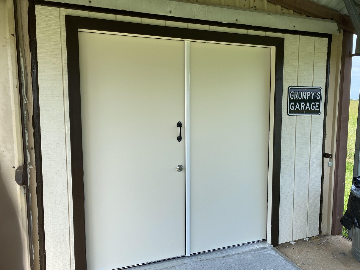

So, I painted the doors and the siding the bone color of the existing building. Then, after lunch, I went back out and cut the trim, then painted that the dark brown of the existing trim ON the building. It's drying on the workbench in the shop and once dry I'll put that up. I also painted the edge of the metal siding on the building to mimic trim where it joins the new wall. ;) I was able to do a good job on the right hand piece. The left hand side I could only start until the roll away door is removed, it's blocking me. (The brown trim painting isn't shown in this pic. Maybe tomorrow....) The trim will hide the gaps. I will caulk before adding the trim for improved weather seal.
14 doors and siding painted.jpg (559.81 KiB) Viewed 698 times
Posts: 7473
Post by BrokenolMarine » Fri Jun 23, 2023 11:38 am
Well, the trim is up after having been painted yesterday and dried overnight. It looks pretty good. I have one area at the right edge that has that dribble that needs touched up where I painted the two edges of the existing metal siding to mock the trim. The project is basically complete. I went thru the shop and cleaned off the three workbenches and put away all the tools.
15 trim installed.jpg (523.88 KiB) Viewed 689 times

That nasty foam covered thing to the left of the new door is the rollaway door. It's coming down when the temperature drops some and we get a few cooler days. Then we will wash the metal walls, and perhaps paint them as well.

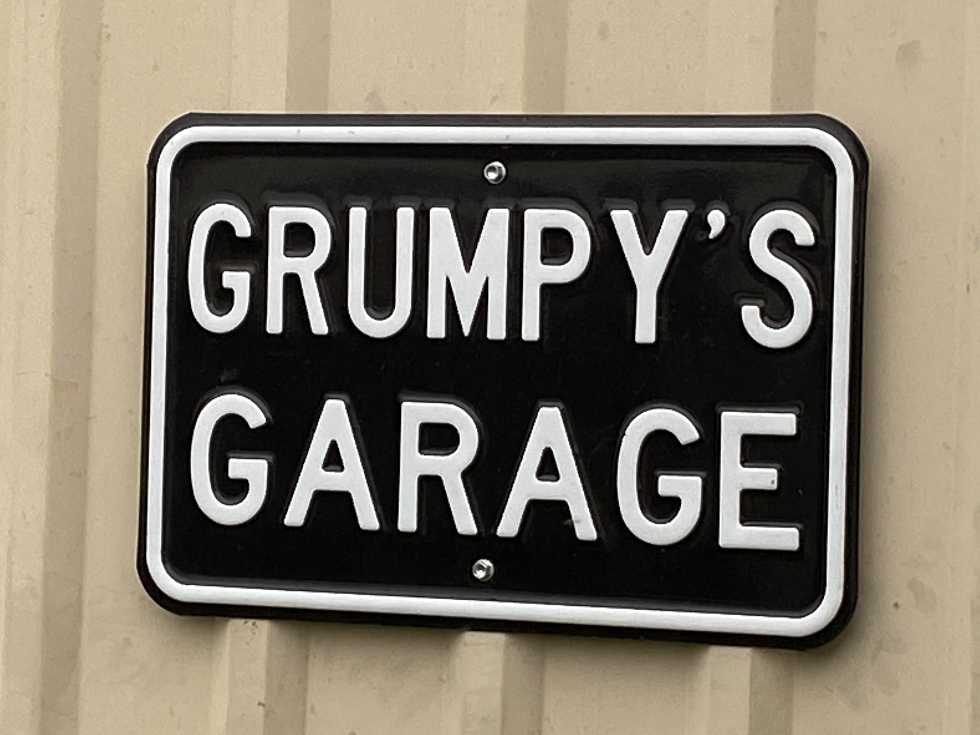

I got back after the shop project over the last couple days. First, I moved the Grumpy sign from the roll aside door to the wall beside the static door. I'm liking it there.
16 sign up.jpg (284.17 KiB) Viewed 674 times

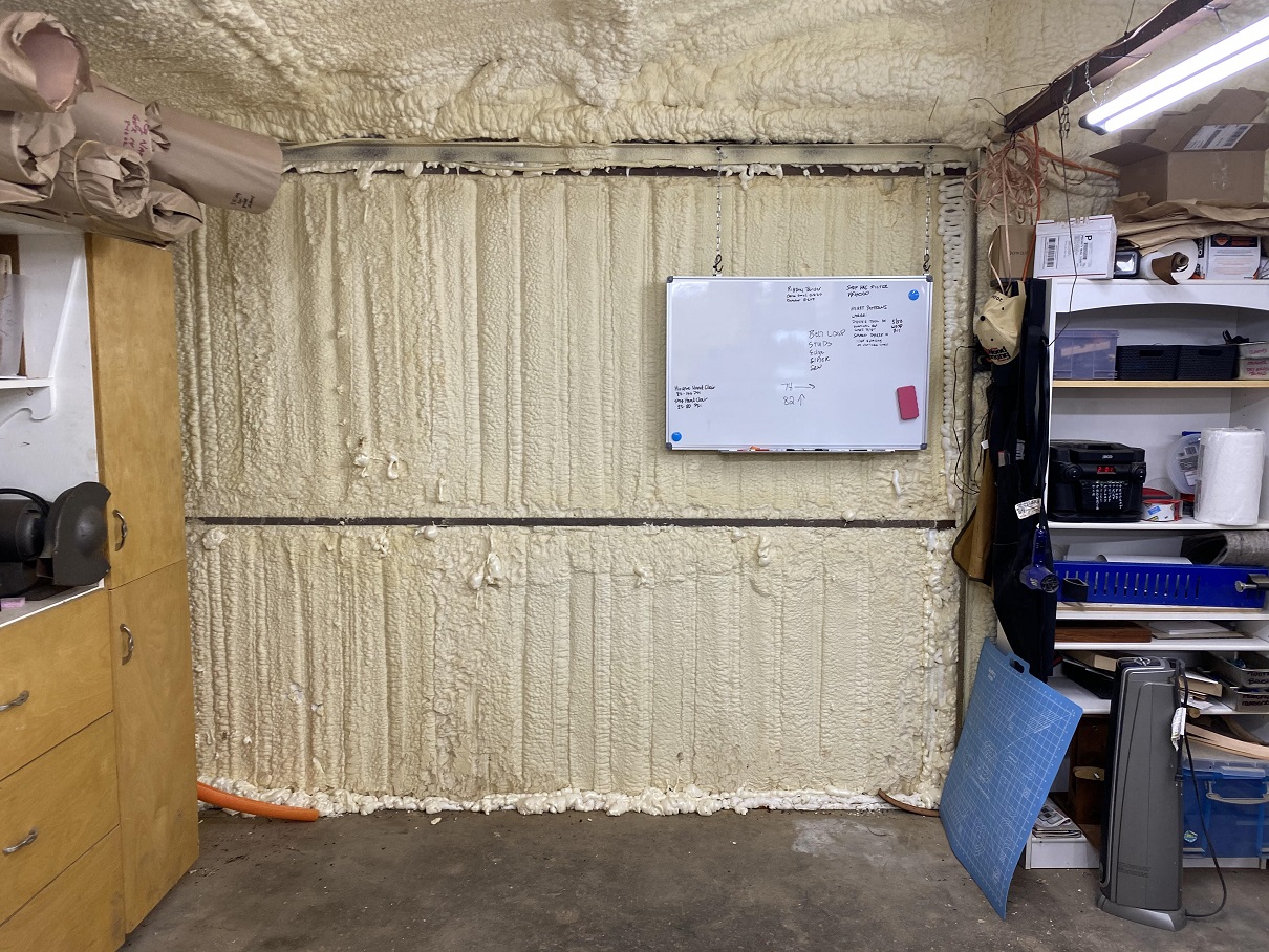

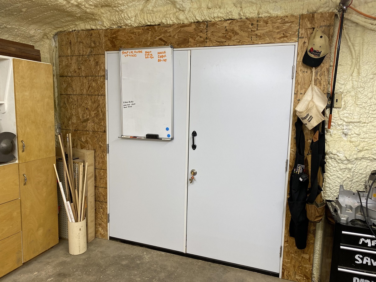

Next, I hung my dry erase board over the static door, but not ON the static door. I hung it from cup hooks vertically, so I can use it, but it can easily be moved on those rare times when I might open BOTH doors.
17 dry erase over static door.jpg (384.44 KiB) Viewed 674 times

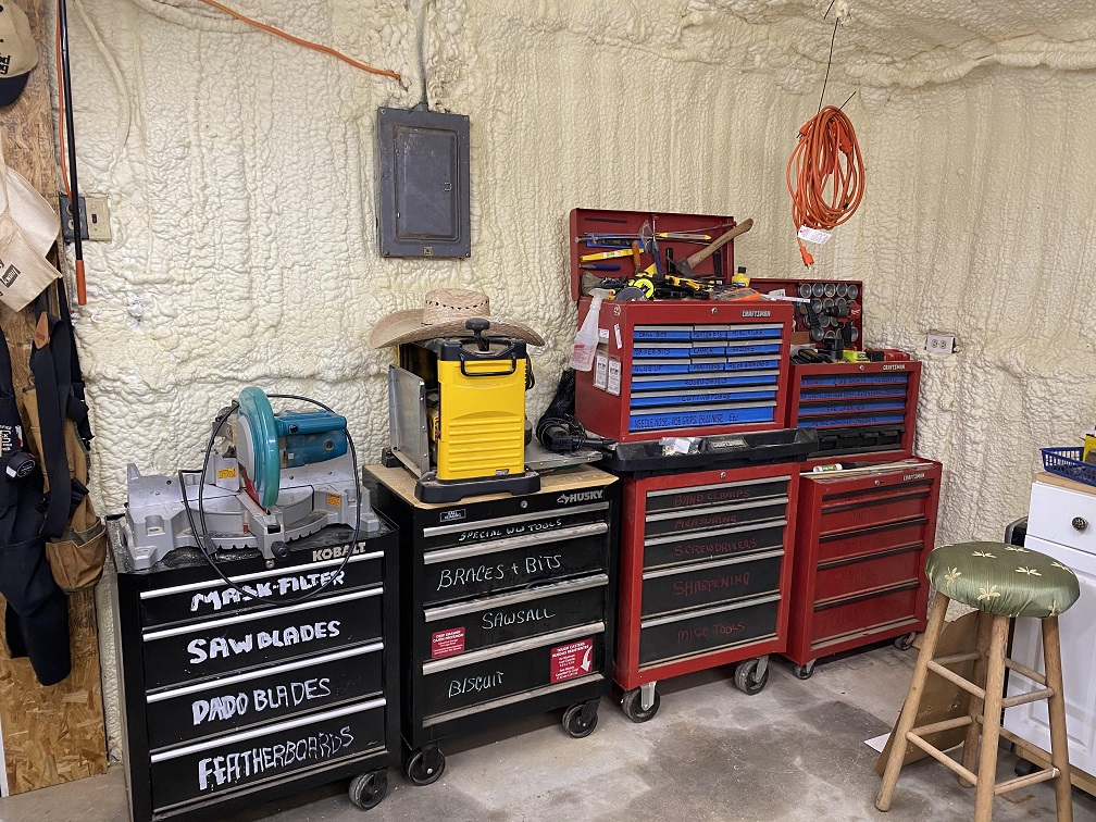

As I said in an earlier post, I have begun rearranging the shop, and part of that was to move all the rolling tool boxes to the wall beside the door since I moved the woodworking bench to the area near that door. They fit almost perfectly once I moved the stacked wood that used to be in the corner.
18 Boxes moved to work bench side.jpg (409.4 KiB) Viewed 674 times

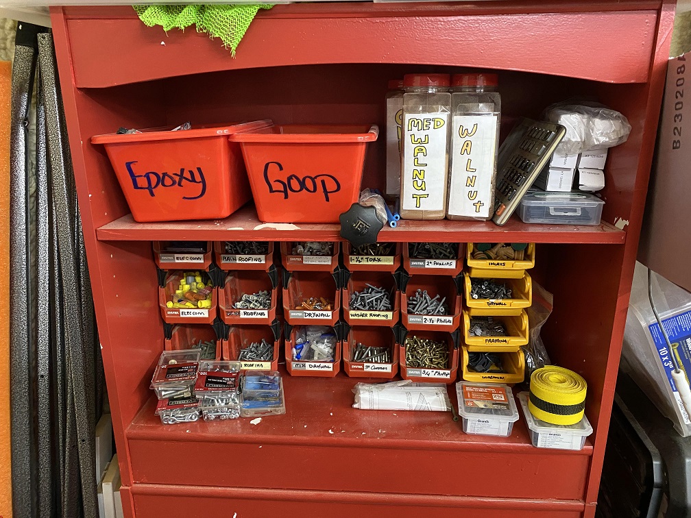

The real "Yawn" work over the last few days has been to sort and clean up the storage in the shop. From buckets of miscellaneous mixed screws and nails, bolts, and hardware to sorting the tool drawers to thin out the collections of wrenches, screwdrivers, pliers, etc. The duplicates were thinned and top quality tools were organized in the shop drawers. Extras were put in a tool bag I'll put down in the barn area so we'll have tools there.

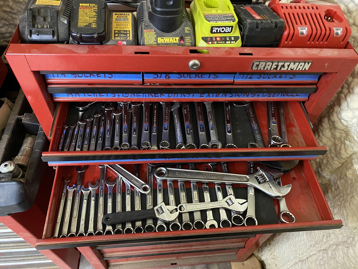

The wrench drawers look better, wrenches in order by size and sorted into two drawers, SAE and Metric.
01 wrench drawers.jpg (517.39 KiB) Viewed 674 times
I went thru the sorted hardware and put that in it's place, then clearly labeled the drawers they are stored in.
02 hardware drawers.jpg (374.44 KiB) Viewed 674 times

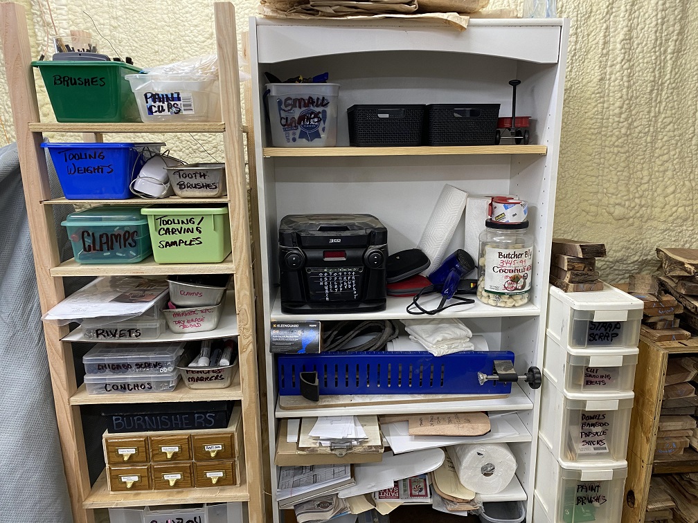

Same with the leatherwork shelves, including building a new shelf to accomodate more storage bins.
03 leatherwork shelves.jpg (358.12 KiB) Viewed 674 times
The original storage shelves were sorted, and bins remarked. Screw and hardware bins cleaned and sorted.
05 storage shelves 2.jpg (349.5 KiB) Viewed 674 times

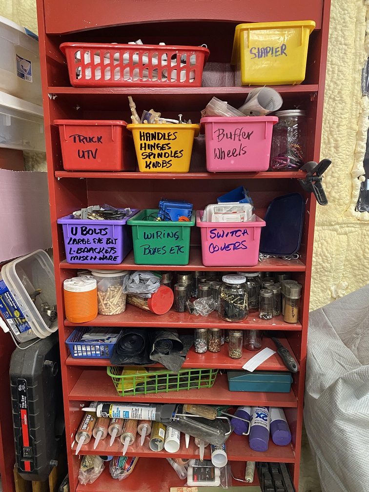

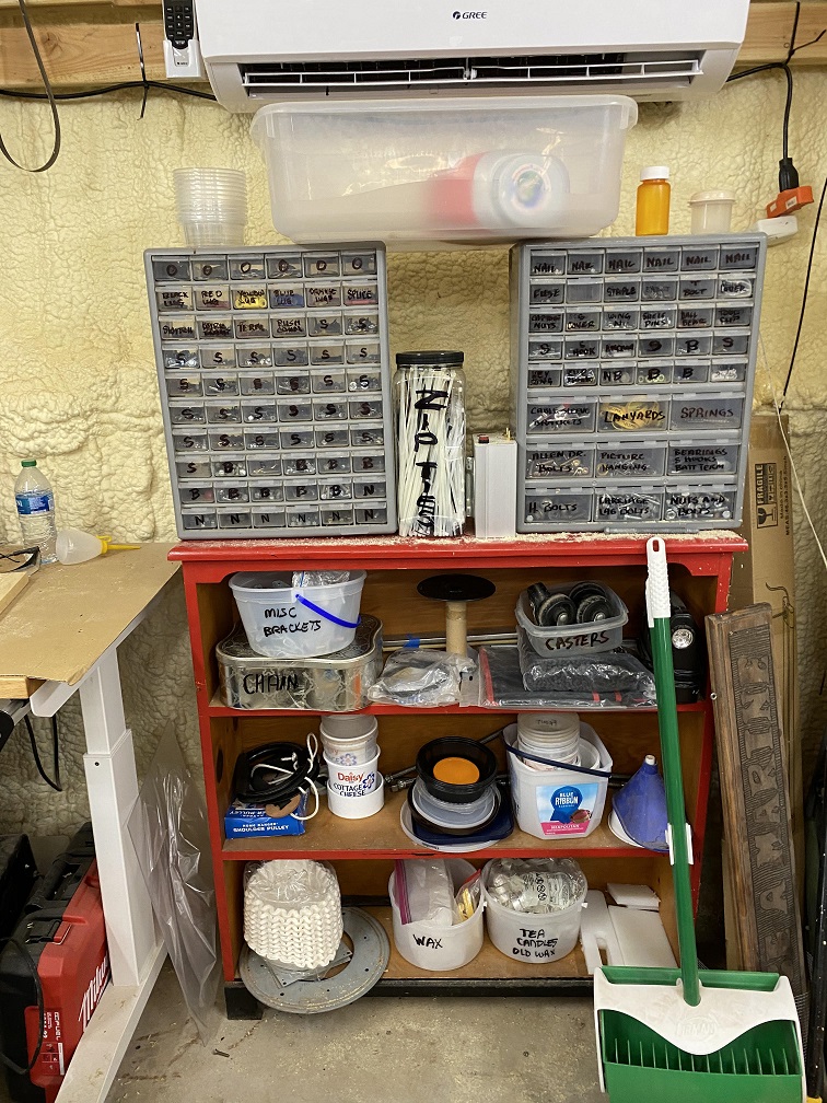

I paid particular attention to rusted, twisted, or outdated items that had been held on to, but I felt I would use Someday. Space is often at a premium and like many, I had given up a lot of space to "maybe someday." We have all tossed an item here or there that later (often years later) we found a use for. I think I'd rather have the space and if necessary, buy something later. Cheaper than an addition due to junk.
04 storage shelves 1.jpg (361.18 KiB) Viewed 674 times
