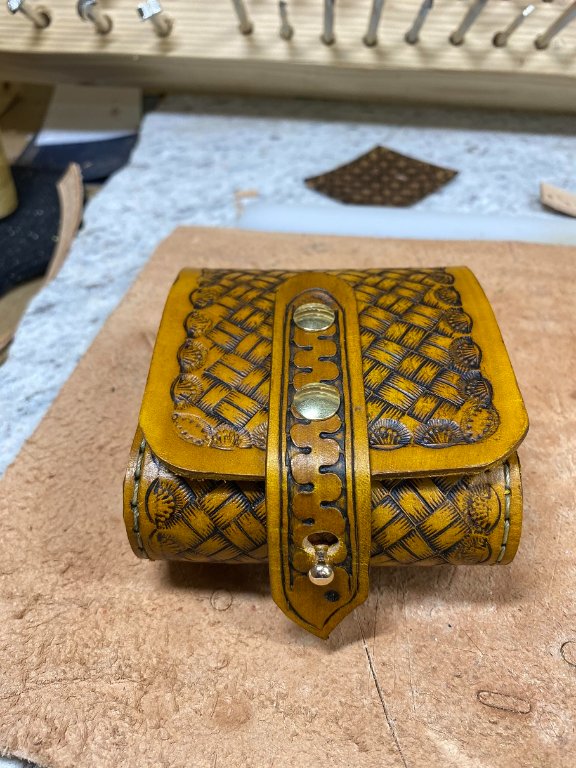

Some of you may remember the pouch I made for .22s so I could wander around the farm and plink.
22 completed.jpg (116.53 KiB) Viewed 1266 times

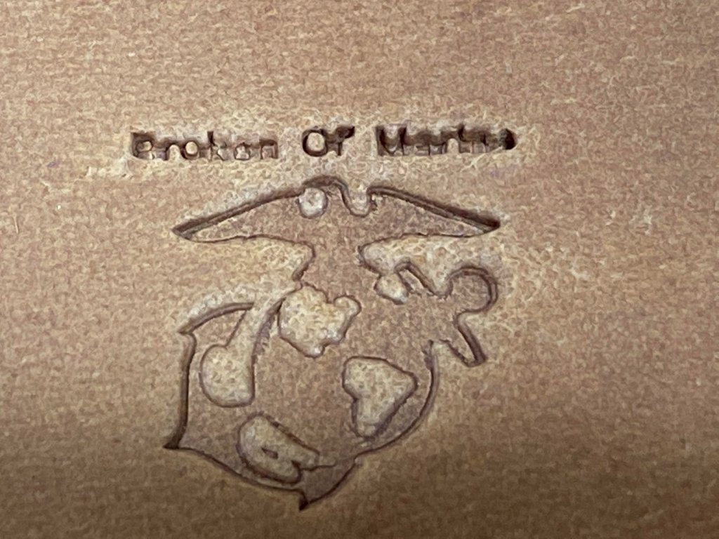

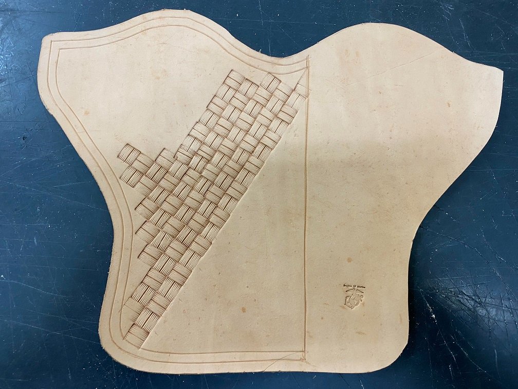

It's okay, I had stamped this version with my new maker's mark stamp and applied a bit too much force in my stroke blurring the lettering.
Guess I'll strike a tad lighter in the next application. It should read: "BrokenolMarine" if I hadn't blurred it.

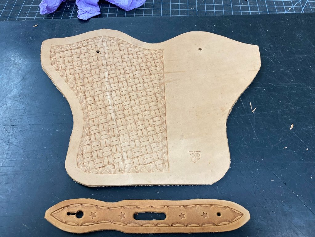

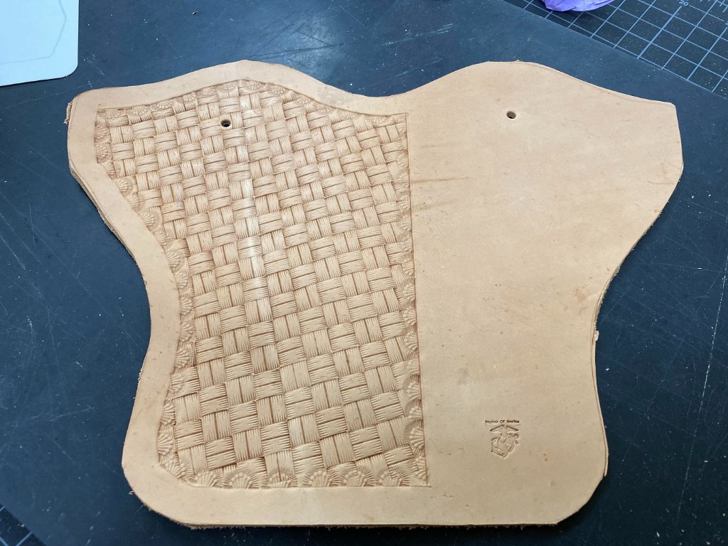

I had appointments the next day, so the day after I recut the pattern. I took my time and then laid 'er out again. Then quit for the day. I came out the next morning and tooled HALF the basketweave and quit. Tooled the rest the following day. I was pleased with that.
second shot at basket weave.jpg (157.15 KiB) Viewed 1266 times

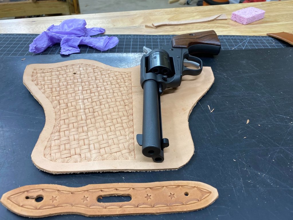

Here is the Ruger Wrangler laid on the rough.
There is still quite a bit to do. I'll have to line the holster to protect the gun from the hardware, finish the edges of the strap and the holster, make and sew the belt loop on the back, after deciding on cross draw or strong side. Yup, lots to do. I'll dye the holster and strap before most of the above....

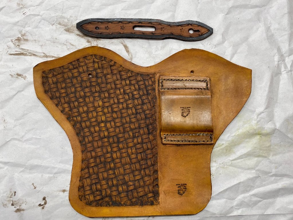

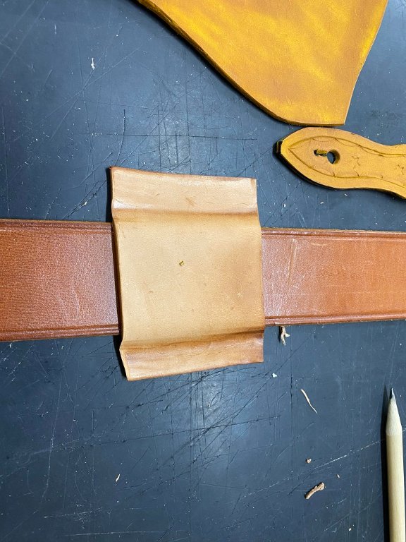

While I was in the shop working on the Rifle Rest, I worked on the Wrangler Holster again. I formed the belt loop for the back of the holster. This entails cutting out the shape then wet forming it over a scrap piece of belt the right size.
07 forming belt loop.jpg (96.38 KiB) Viewed 1055 times

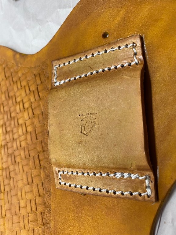

Once everything dries and sets, I'll sew down the belt loop, attach the tie down to the back with the Chicago Screw, and screw on the stud on the front side. Then it will be time to glue in the lining. After trimming everything , I'll antique the panel and strap. Then I can sew up the holster. Once that's done, I can put on the final finish. She'll be done and ready to use. It should match up with the 22 ammo pouch rather nicely.

Back out, and stained the back of the strap, and the belt loop brown for contrast. Added a second maker's mark to the loop.
Then glued the belt loop in place with contact cement and clamped it to let it set up. Once that is done I'll stitch it in place. :)
09 glue up.jpg (107.01 KiB) Viewed 1014 times

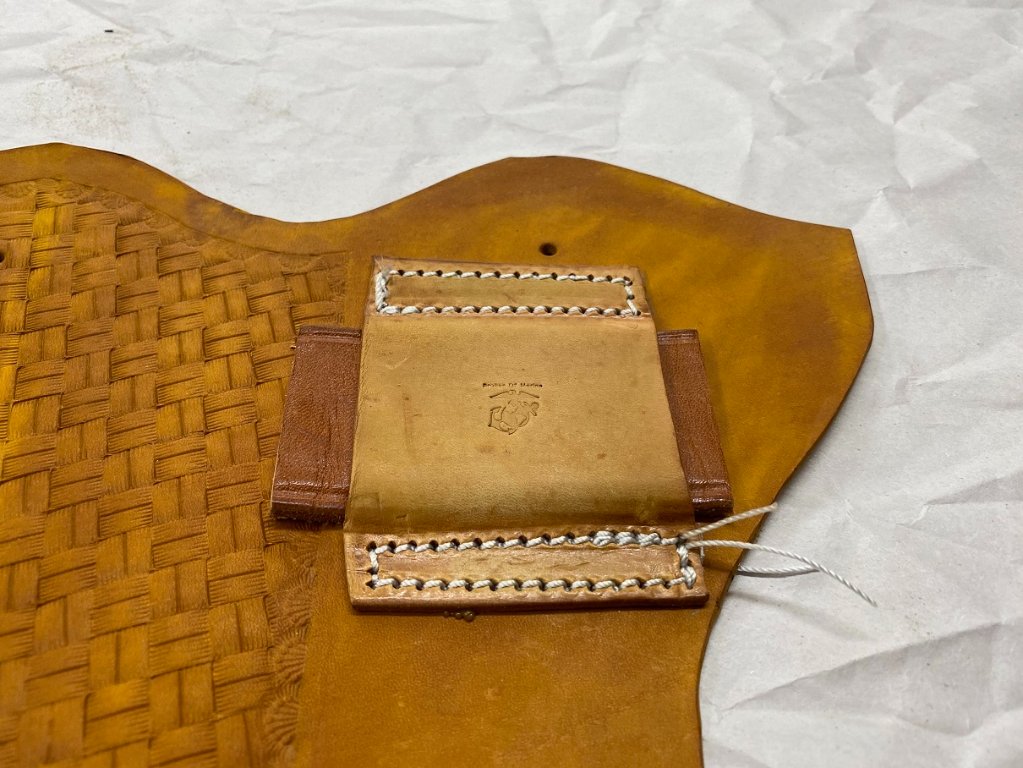

Went out this morning after breakfast to work on the holster. Took it out of the clamps and slipped a belt scrap in the loop and set up the Cowboy machine. I took a deep breath and sewed down the edges of the loop. I took my time, sewed at the slowest rate the machine would go and was really happy that all my practice had paid off.
10 sewn.jpg (143.7 KiB) Viewed 977 times

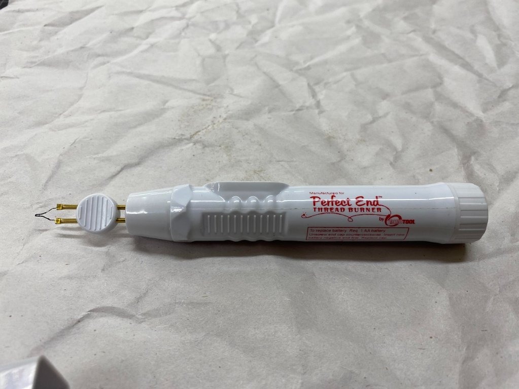

Time to cut off the Irish Pennants, as we called them in the Corps. Some call them tag ends. I guess with Cancel Culture these days, Irish Pennants would be "Wrong." I'm Scots-Irish and Indian.. and not offended, but ... :? I added a handy little battery powered tool to the drawer not too long ago. Works great. A cauterizing tool. Cuts and burns the thread ends at the same time.
11 cuts and burns.jpg (103.41 KiB) Viewed 977 times

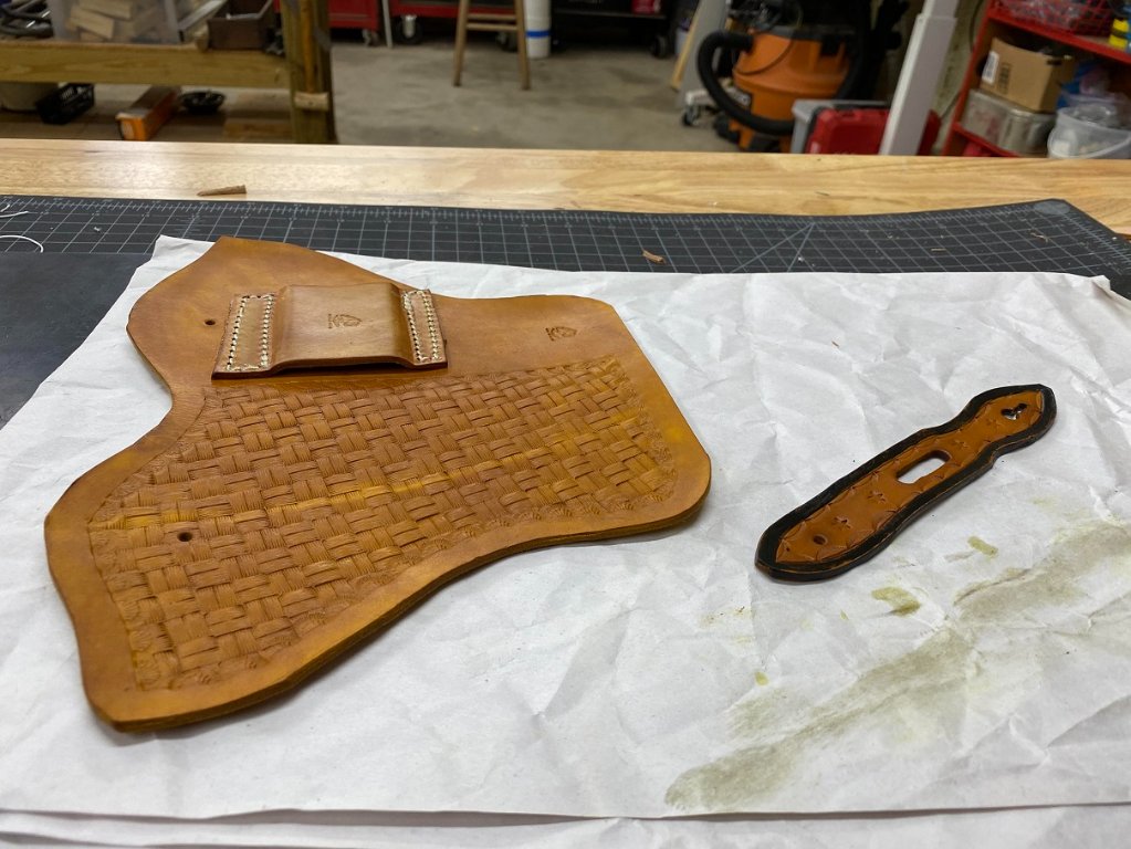

I coated the finished sides of the leather with a top coat, to put a barrier between the leather and the antiquing to come. That way the excess will wipe off clean. Left it to dry. When I go out in an hour or so the final look will start to show. I'll antique it, then wipe it and get the look I want and leave it to dry. When I go back out I'll put on the finish, and leave it to dry again. Then when I come back out I'll glue in the lining.
13 top coat.jpg (141.3 KiB) Viewed 977 times
Posts: 7475
Re: Wrangler Holster
Post by BrokenolMarine » Wed Oct 12, 2022 11:23 pm

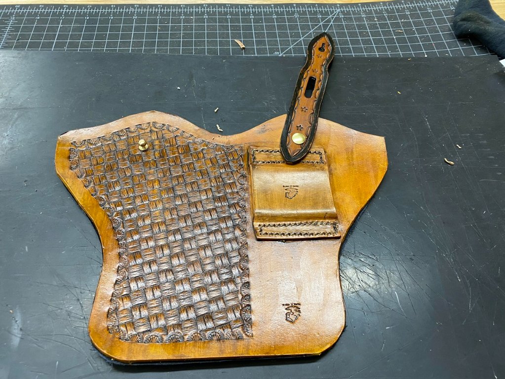

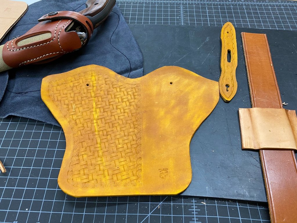

I went out this afternoon and antiqued the two pieces and left them to dry. Forgot to take the camera and when I went out to apply the topcoat to freeze the antique, I took the pic.
14 antiqued.jpg (193.51 KiB) Viewed 767 times
I'll take the pic of the topcoat in the morning when I go out to put on the hardware and glue in the lining in preparation for sewing the holster together. We are getting close to the end. I think it will match pretty close. I like the way the antiquing really makes the basket weave pop. 8-)

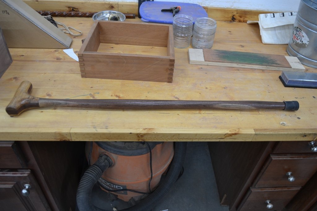

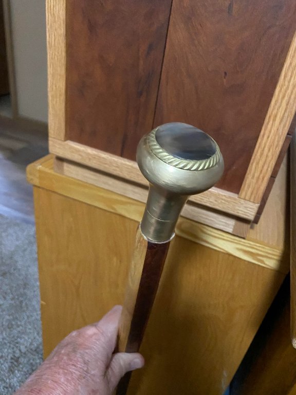

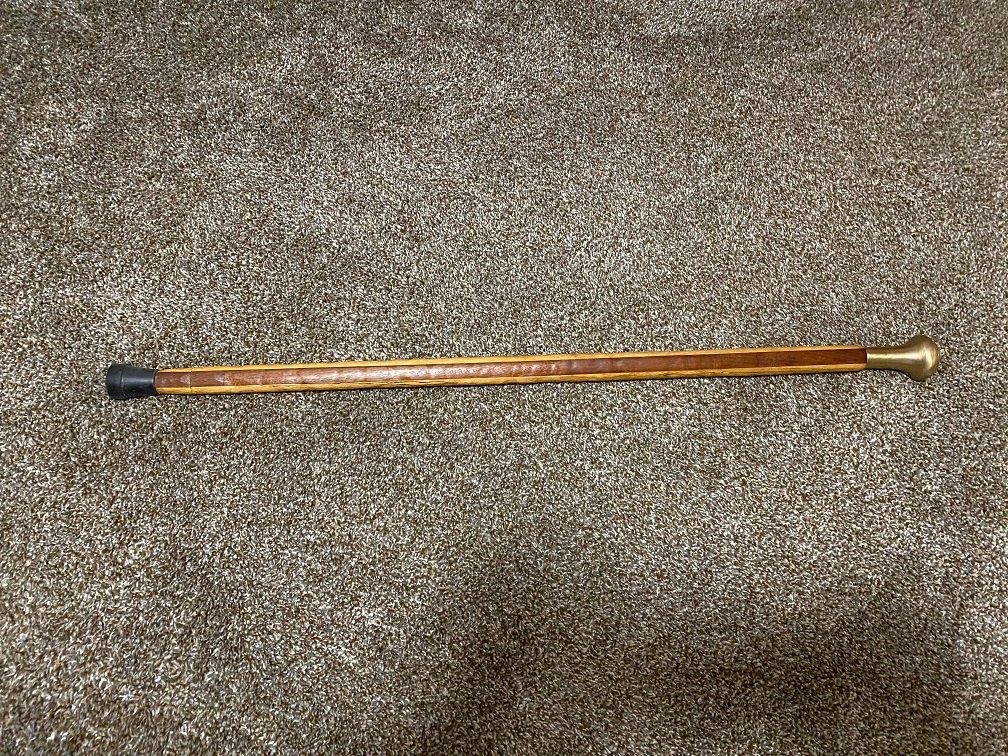

I have other things I'd like to try and I did the same. Tina told me to buy a lathe so I could turn canes. Nope. She showed me one in the Woodcraft Ads, only $1,800. Yeah, ONLY $1,800. I pulled up a picture of a guys lathe corner in his shop. The peg board beside the lathe covered in tool heads, and ALL the various cutting tools for woodworking. Yeah, the lathe is only $1,800. That board holds about $3,000 bucks worth of things he uses to make all the cool stuff on his page, and I'd bet there are just as many things in the drawers and cabinets you DON'T see. 8-)
I bought a pair of spokeshaves and make two canes by hand.
reshaped and refinished.jpg (140.92 KiB) Viewed 749 times
new shaft.jpg (440.49 KiB) Viewed 749 times
Lot's cheaper than the lathe.
Quieter too. ;)

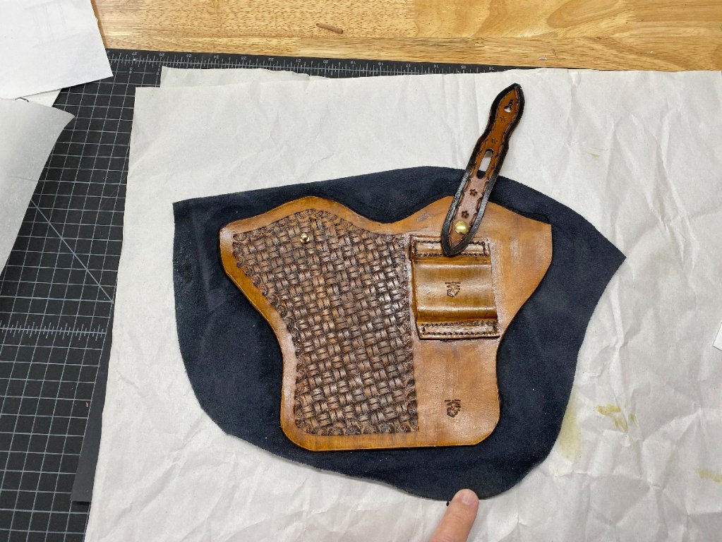

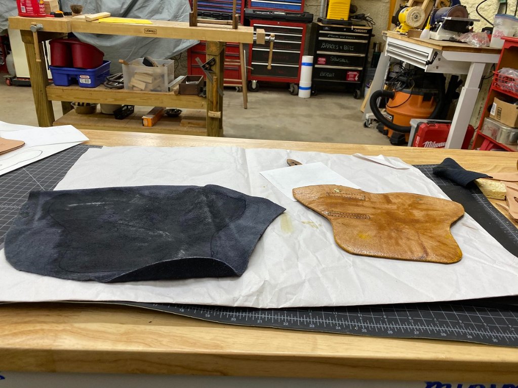

I blew it this morning when I went out to work on the hardware and lining. I forgot to take the pics of the hardware and topcoat, before I turned it over and added the cement and let it start curing. Sux to be old and have a short memory. I really thought I had taken that pic.... but here is the pic of the holster and lining with the cement painted on, waiting for it to turn dull so I can mate them up.
16 cement.jpg (164.83 KiB) Viewed 749 times
Once the cement was ready, I turned the holster over, lined it up best as I could, and mated the two. Then I put various leather scraps on top of the holster to bring some height to the rest to match the loop to keep it from being marred, then a sheet of parchment baking paper to protect it. Then a slab of marble scrap for weight. Left to dry.
17 mated and weighted.jpg (194.25 KiB) Viewed 749 times
Pictures when it comes out.
Next up, cementing the edges and folding it with clamps to cure, ready to sew.

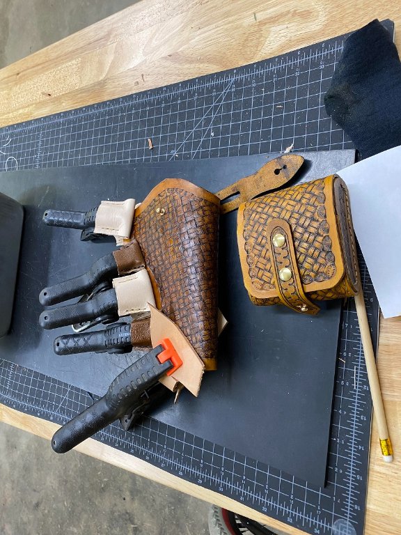

Tied up all day, but got out this evening and removed the weight from the stack and pulled out the holster. The lining is pretty well glued in place.
The only place it wasn't really glued in perfect was right at the edges, but that will be sewed down. You can see the hardware in this picture but will get a good look in the next.
18 lining and hardware.jpg (183.51 KiB) Viewed 735 times
After trimming away the excess, I rubbed down the leather with Mink Oil to insure it stays flexible and to add some waterproofing. We want flex, we are about to fold and clamp to prepare for sewing. Here you can see the brass stud that the retention strap will secure to, just as the ammo pouch secures. I chose a Chicago Screw that left some movement with the retention strap so it could be easily moved to the rear of the belt and tucked for freedom of movement of the Wrangler when needed.
19 trimmed and mink oil.jpg (218.76 KiB) Viewed 735 times

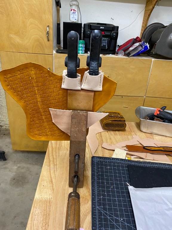

I painted the interior edges of the holster with contact cement and then when it was tacky, folded and clamped. It will cure overnight and hopefully we'll get a good hold until I get the edges sewn. I have to sand the edges then sew them down, a nice even double row. Then some finishing touches and Boom... done.
20 folded glued and clamped.jpg (131.09 KiB) Viewed 735 times
I set the pouch beside the holster, and I think I'll need to re-antique the pouch to darken it to match. No biggie.
Five minutes then some drying time.
