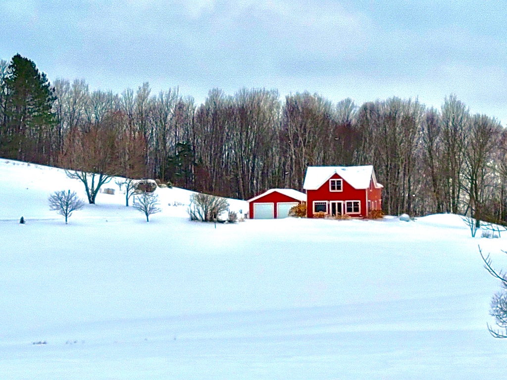

My property is not level. I am trying to figure out where to put different ranges. I’m thinking shooting targets at 25 yards will be against the hill. When I’m standing placing the targets on the ground will make me level with them. If I want to shoot 50 to 100 yards I’m thinking of shooting downhill. The terrain kind of dictates that but also because shooting downhill has always been more accurate than shooting uphill.
Any thoughts or ideas?

I should be able to dig in enough to make the backstop more than a 45 degree angle. Few richochets at that angle. At least on my planned 25 and 50 yarders. At 100 I’ll need to figure something out like only shoot at bullet traps. I’m guessing 90 percent of my shooting will be at 25 and 50 with SV rimfire and pellets. If I can buy the land adjoining me it will give me more options.

The hill makes a great berm and a couple hours with a shovel will make it even more safe. The hill is 50 feet high and quite steep at about a 30% grade. Then it levels off a bit at the bottom where the lawn is. I can only get 25 yards distance. Maybe more but I’ll need to wait for the snow to melt. Shooting to 50 yards downhill will be more of a challenge. Odd because again at 200 yards it starts back uphill enough that again the hill makes a good berm.Headhog wrote: ↑Thu Mar 24, 2022 1:03 pmThe club I shoot at their main rifle range is downhill. Not sure of how much drop there is from the firing line but it is very noticeable. The berm at the back of the range is earthen and about 15 ft. tall. Beyond the backstop is unused wooded property for at least a mile. The it opens up to some farm land and one home. The next home beyond that is again at least another mile. This is a 200 yd range.

Right now I can’t tell where my property ends. If I can buy the land next to mine I will have more options.
