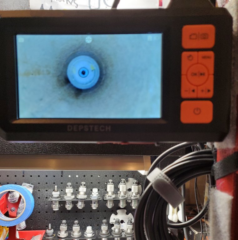

So my son and I were talking about rifle barrels and he asked if I had a bore scope (he is in medicine so he said endoscope, you know the think they check our colon with !) I said no, but was thinking of buying one for several uses, not just as a bore scope. Well, he gave me one for Xmas.

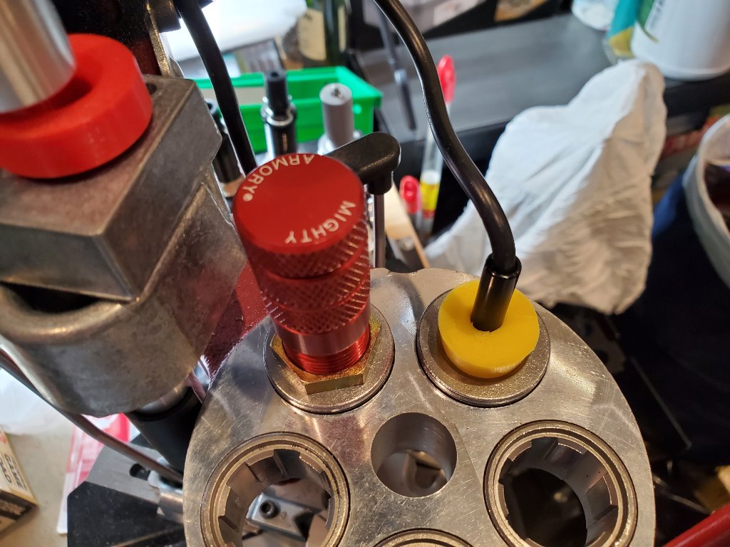

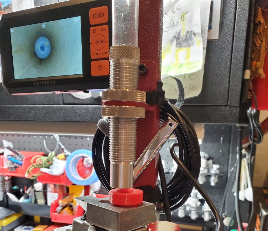

I finally got around to putting it all together. I attached the monitor to my press at eye level when I sit on my stool and load with industrial Velcro so I can take it off for other uses. . It is directly in front of me and very easy to see. I took a yellow silicone plug and drilled out the center and inserted the camera. I put the plug into a Hornady bushing so I can easily remove it or move it to a different station.
I placed the camera after the powder drop, and now I can easily see if I failed to drop any powder, double charged, etc. I have used a powder cop, but it is awkward to have to continue to look up at the PC. With the monitor I can see everything including the powder drop. I also use it for things such as inspecting shotgun hulls to see if they are straight wall, beveled, cupped, etc. Clear as day and works great.
The other thing I just picked up was a Mighty Armory Universal de-capping die (The red die in the picture). It will decap any caliber I shoot including 9mm, 38/357, 45acp, 45 Colt, 45/70, 7mm, all of it. It is screwed into a Hornady bushing and once adjusted to the plate, I never have to adjust it again for any caliber. It does not resize, only decaps which is what I want. It is a unique design and is rock solid, the pin is machined and guerrilla strong. ((No more broken or bent pins).

Very true CH, another reason I wanted this. I have used it as I said to check shotgun hulls as their specific construction drives the correct wad for the correct pressure and I never found a way to really see without cutting it apart.I may have to get one of those to check bores with
I also have scoped some rifles. The nice thing about this scope is it has two cameras, one on the bottom and one on the side, both with LED lights. I put it in the throat of a rifle and I can rotate it 360 degrees to really see, and I can do a split screen on the monitor.
The only PIA is that it comes with 16 feet of cable, so I have to keep it rolled up and tied.
