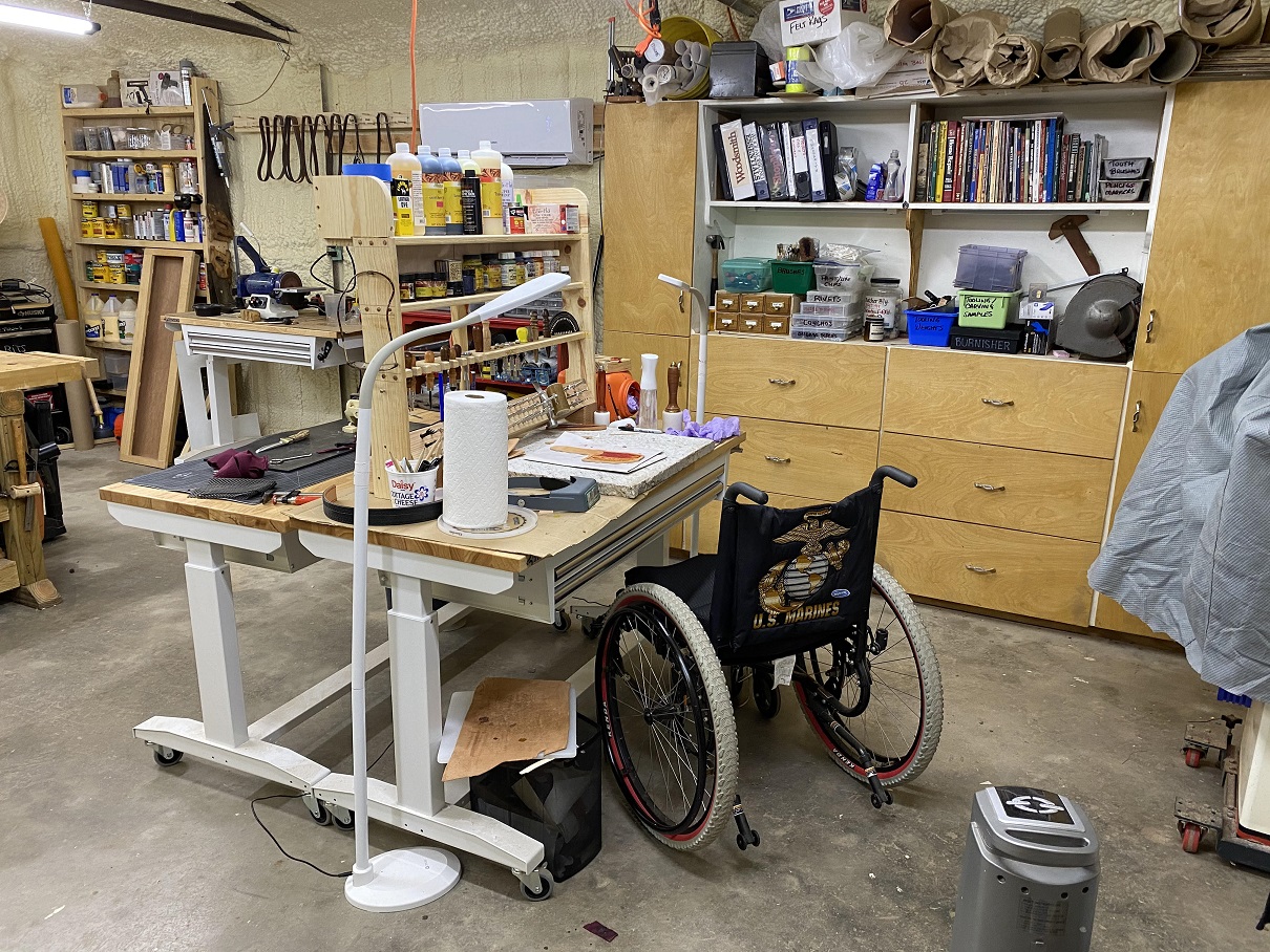

I noticed that with the temps in the low teens, the wall behind the workbenches was throwing off really cold air. It used to be the sliding door and even though I had the spray foam guy coat it, it's a weak area in the shop. I was in fear the cold air coming off the wall would damage the dyes, paints and other items on the bench so before starting work, I rearranged the shop a bit to move the bench off the wall, at least for now. I ran that power cord over the overhead beams to drop behind the shelving from overhead for the lighting, like most of the others... and good to go.
*** :o Don't tell Miss Tina, I'm not supposed to get on ladders, even that step stool this required. I can't stand for long and the leg isn't that stable but I didn't want to wait. :?
19 moved the benches.jpg (558.04 KiB) Viewed 754 times

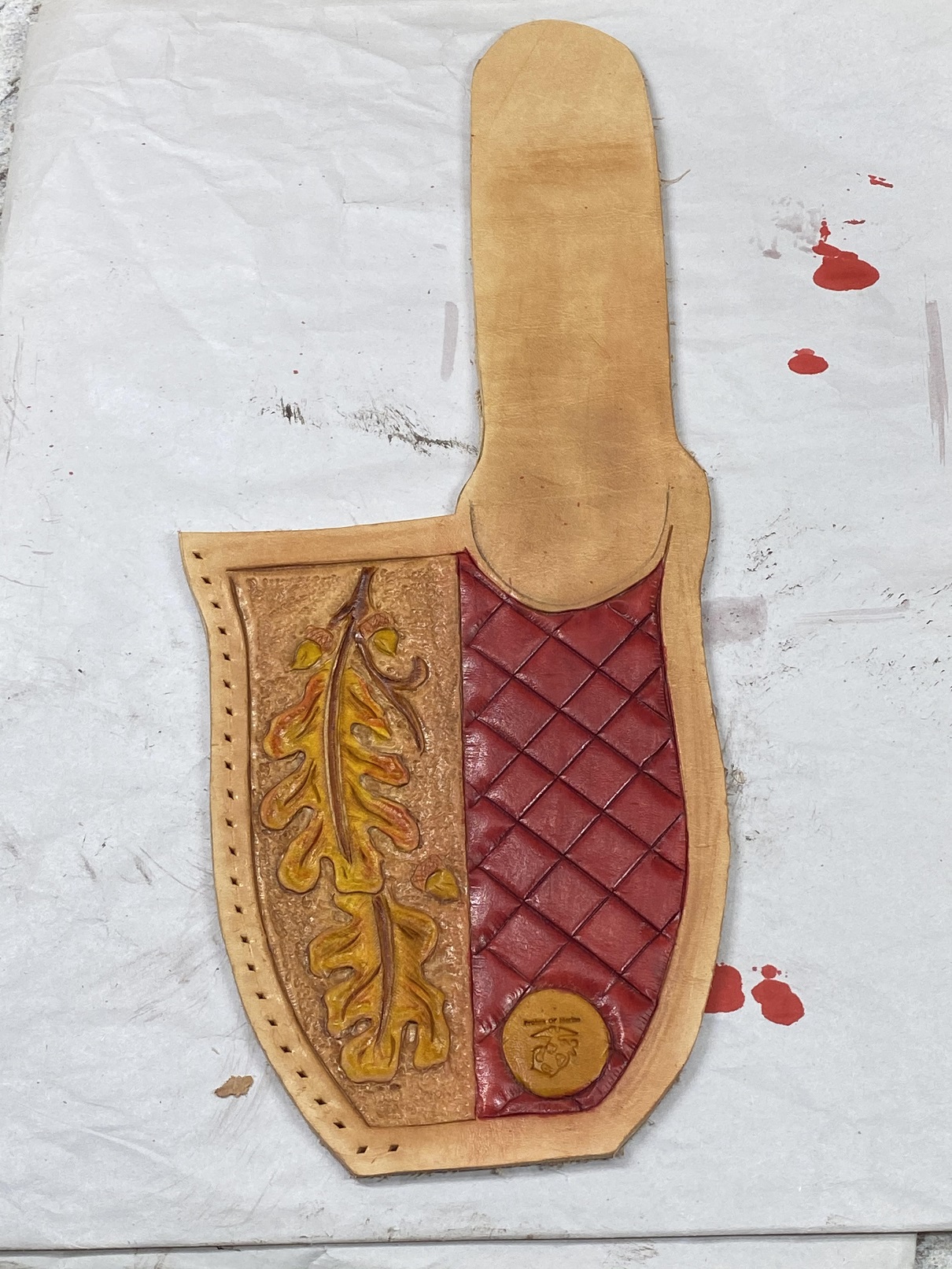

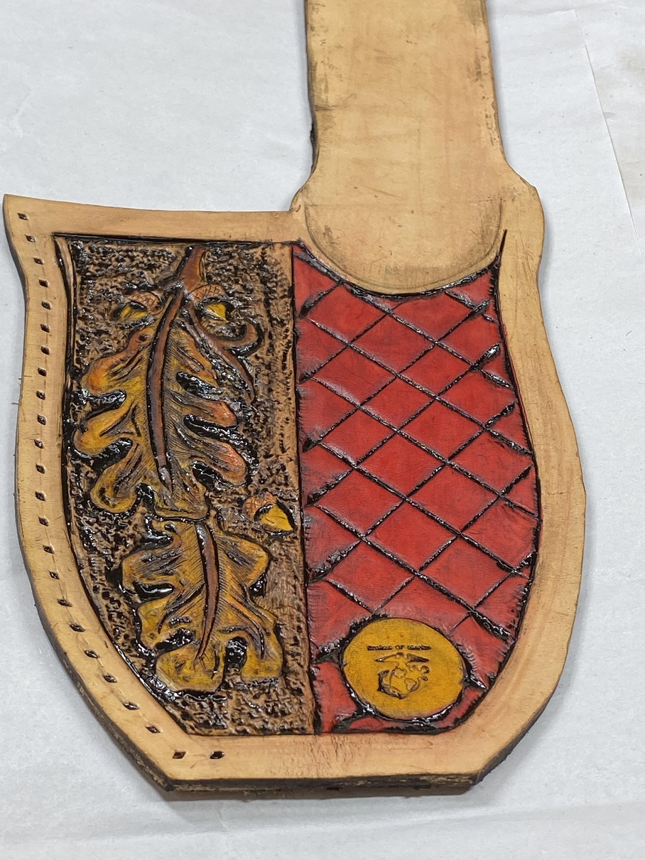

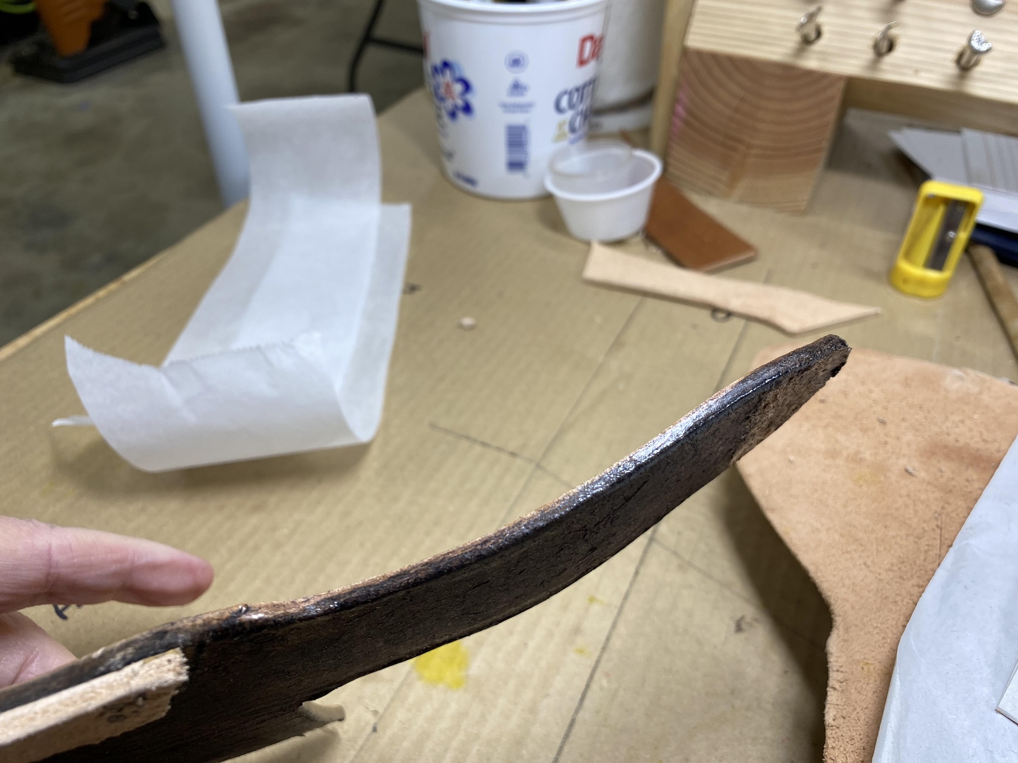

I was VERY careful and held on to the beam while I zip tied the cords in place. ;) Then I moved on to working on the sheath. I decided to tool the back of the sheath before applying the resist so I could antique it tomorrow after coffee. I went with the "tuck and roll" pattern. It won't be seen much but I'll know it's there. Plus it's a chance for practice and I can use it later. :)
18 more sheath work.jpg (622.83 KiB) Viewed 754 times
The pattern is easy to lay out and the thing that takes the most time is the beveling. There are a number of things you can do to enhance the pattern, but since it's the back, I'll just antique and move on. I punched the master holes for sewing, Step one. Enough for the night.
I'll antique and add a first coat of finish tomorrow to lock in the antique after it dries.

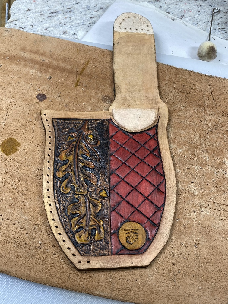

In the first session, I burnished the edges of the belt loop, by dampening and applying burnishing gum. Then you rub with a burnishing tool of your choice. You can use a special tool, the edge of a screwdriver, anything smooth. It's not pressure that smooths and seals the edges, but friction/heat.
Properly burnished you get the glossy, smooth edge that looks professional and seals out grit, grime, and moisture. I'll burnish the rest after the sewing and sanding is done.
21loop edges burnished.jpg (604.96 KiB) Viewed 742 times
Next the welt was glued into place on ONE side. Before we can fold and glue, we'll need to sew the belt loop down, and add any hardware that will be put in place in the areas about to be closed off. NONE here.
22 welt glued in.jpg (490.75 KiB) Viewed 742 times
Contact cement is applied and the welt placed, then clamped and allowed to cure.

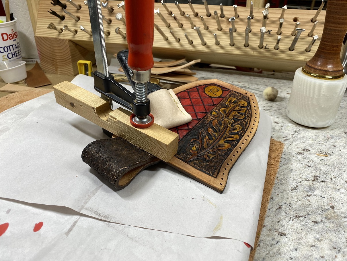

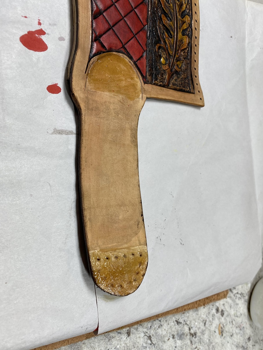

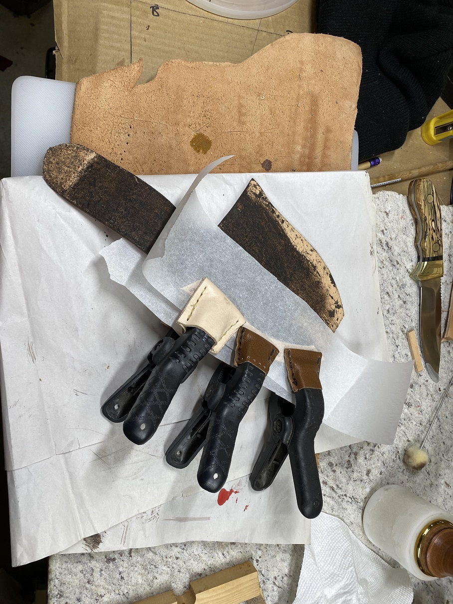

The next session of the day.... I skived the belt loop, which means I shaved down the edge of loop to allow it to lay a bit flatter when glued / sewn down. I matched it to the area where it was going to land, and marked that area. That was roughened by sandpaper to aide in adhesion.
23 belt loop skived and roughed.jpg (432.98 KiB) Viewed 741 times
The holes were marked and punched for the sewing of the loop. Then contact cement was applied and allowed to partially dry.
24 loop cement applied.jpg (360.92 KiB) Viewed 741 times
Once the cement appeared "Flat" then belt loop was put in place and clamped down. The wood is there to insure a nice tight seal along that edge.
When it has fully cured, I'll sew it down.
25 loop glued.jpg (444.58 KiB) Viewed 741 times

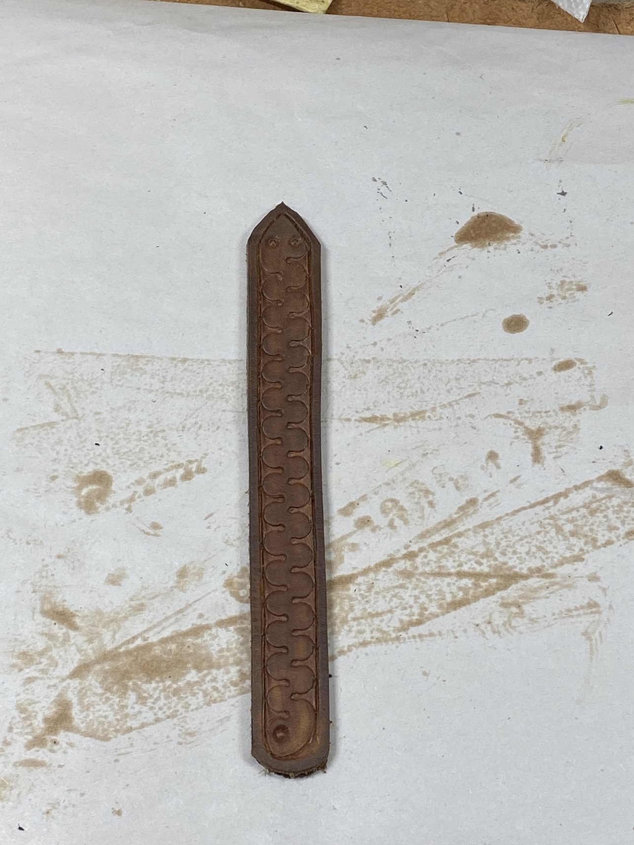

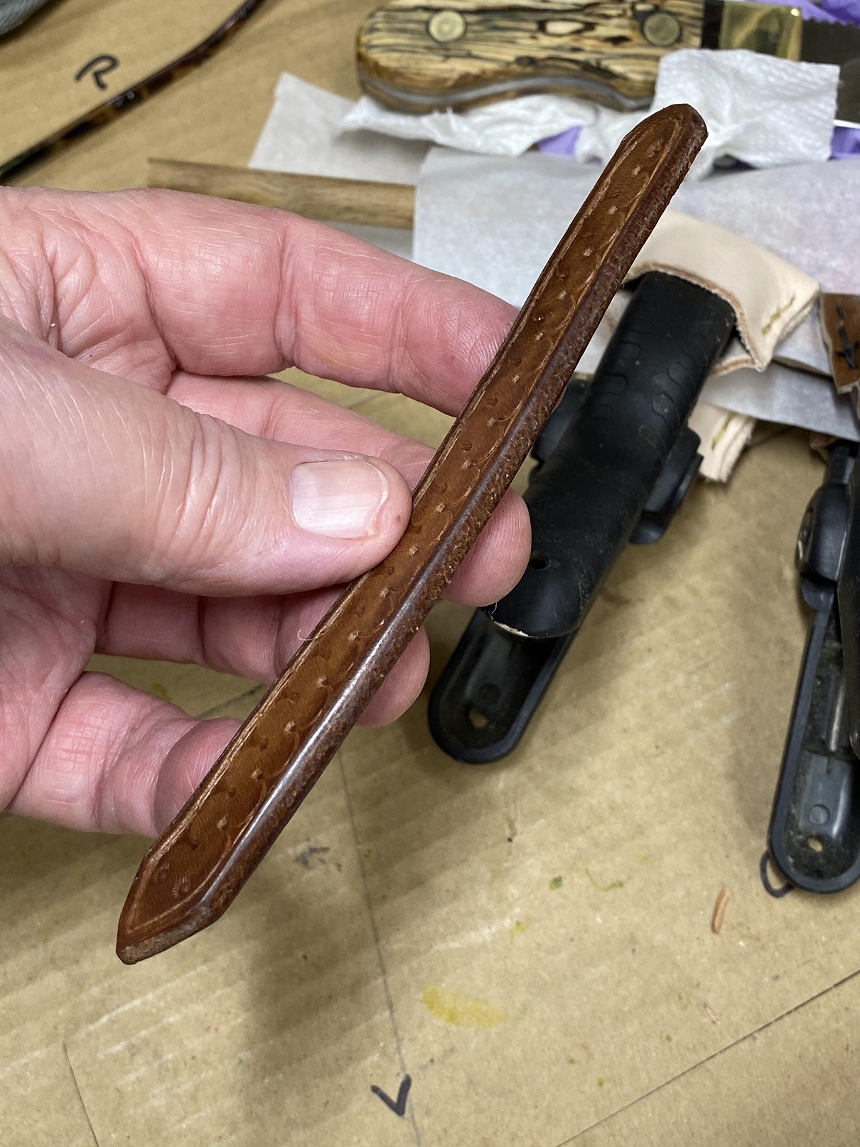

While that cured, I laid out and cut the security strap, then laid out the design and tooled and dyed the strap. The first step to later secure the knife in the sheath.
26 started security strap.jpg (595.67 KiB) Viewed 741 times
Those edges will get burnished, the strap will get antiqued and finished, and hardware installed. AFTER the sheath is done, the strap will be riveted to the appropriate location on the loop, like this one:

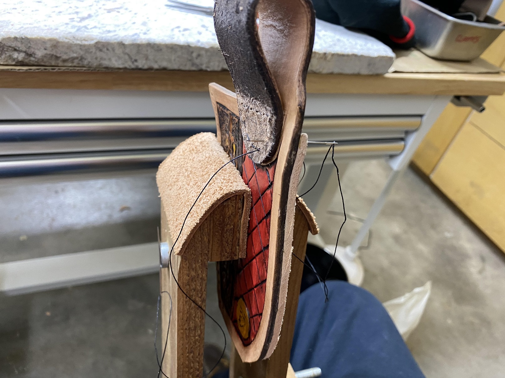

First job was to sew down the belt loop. I clamped it in my custom lacing pony and sewed it down with waxed black gut. I made a loop around then back across the straight edge that will be adjacent to the belt for security. Lessons learned from the past. Note the magnets I added to my pony, not usually seen the ones I saw on line and stole the best ideas from. Nice place to drop the needles as you pull the thread tight every two or three stitches. I was going to countersink them, but that would have made the needles harder to retrieve. :)
27 sewing the loop on the lacing pony.jpg (589.89 KiB) Viewed 733 times
I applied the contact cement to the welt and opposite edge, and a coating on the inside stitching for the belt loop to protect it. while it dried I burnished the edges of the safety strap. Turned out very nice.
28 burnished the strap edges.jpg (592.22 KiB) Viewed 733 times

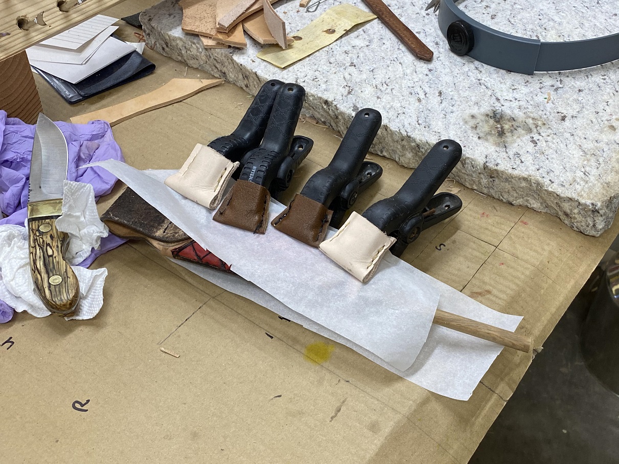

I wet the inside of the sheath to prevent cracking and then placed an appropriate sized dowel against the off edge inside to make sure it stayed nicely curved and with my tongue properly tucked in the corner of my mouth for luck, I rolled the edges and matched them up. You only get one chance with properly cured contact cement. NO resetting. Then I clamped it and it will set until this afternoon, when I'll sand the edges and then drill thru the master holes and sew that down. Then burnish. Then I think I'm going to paint that background flat black before applying the finish and wax.
29 rolled the sheath and glued and clamped.jpg (480.84 KiB) Viewed 733 times

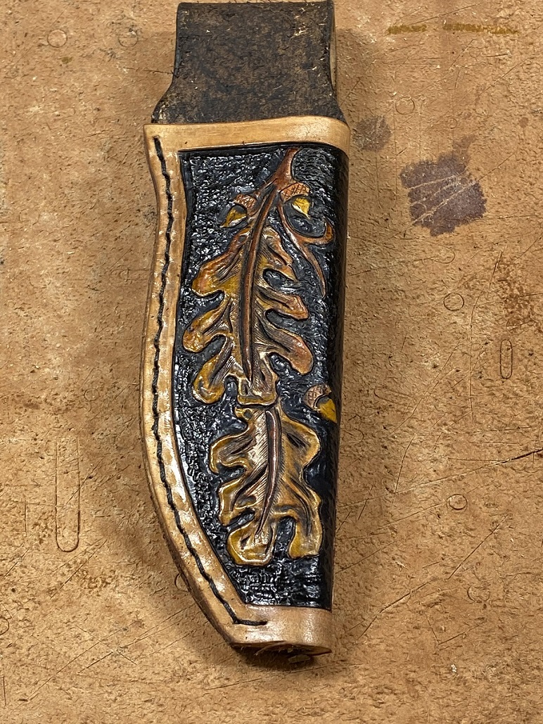

Another visit to the shop and prepared the sheath to be sewn. I drilled the master holes thru with the appropriate bit, insuring the sheath was held flat on a spacing wooden block on the drill press. I used the waxed black gut again, but this time doubled the strands. Took my time, tightened each stitch pair, and the stitching came out great. I sanded the edges of the sheath, and then painted the background with a jet black paint to even it up and make the tooling pop. The antique wasn't setting it off.
30 sewn.jpg (475.38 KiB) Viewed 729 times
Then I dyed the edges and sides with light brown, and once that dries I'll burnish the remaining edges and put several coats of finish where needed, finish the safety strap and attach that, then wax the entire sheath. It will be done. :D

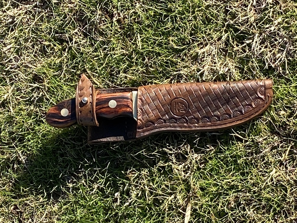

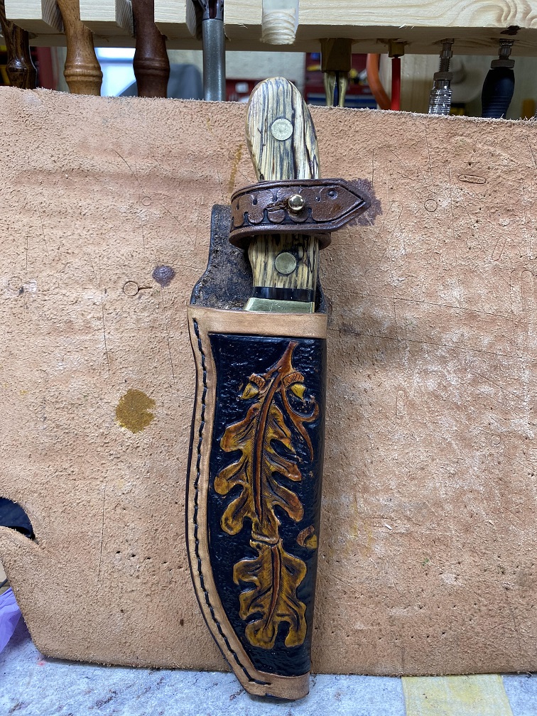

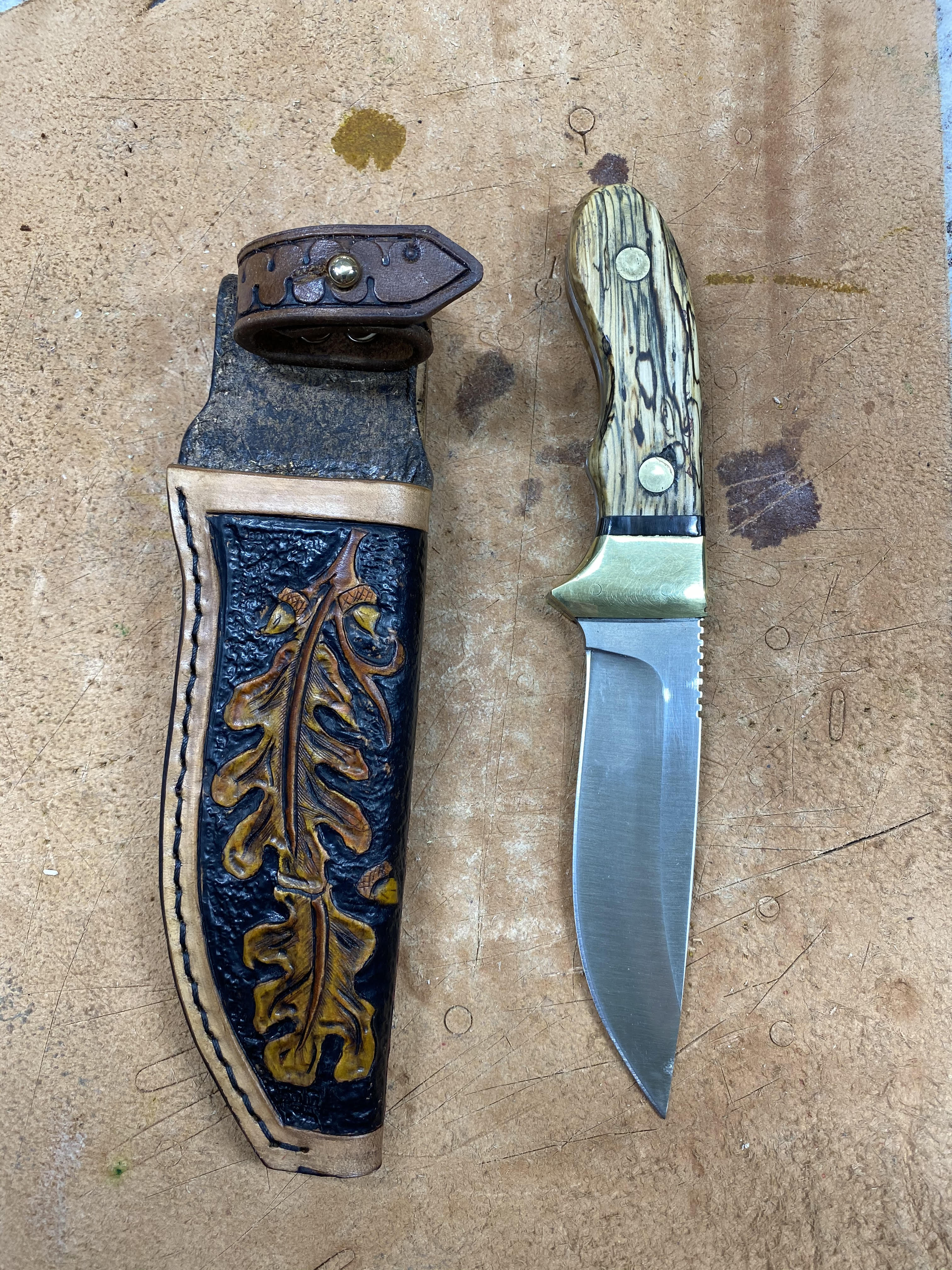

Spent another hour in the shop and got the security strap mounted. The knife fits well. I had antiqued the strap earlier and put a coat of finish on it. Basically the sheath needs a few coats of wax, but it's done.
33 just needs waxed.jpg (470.21 KiB) Viewed 717 times
A look at the pair.
34 the pair.jpg (2.2 MiB) Viewed 716 times

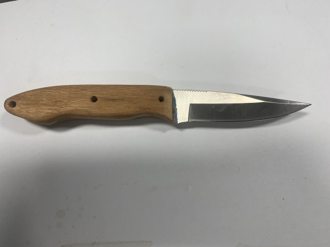

Knife project1.jpg (57.28 KiB) Viewed 835 times
My first attempt. Shaped and round sanded only.

Looks really good coop, what wood is that?

BrokenolMarine wrote: ↑
Wed Dec 28, 2022 6:13 pm
I honestly don't know and they didn't say. It was a kit.

Post by BrokenolMarine » Wed Dec 28, 2022 8:09 pm
Still looks good. Now you have a good idea how it works, next time you can just buy the blank and choose your own handle material. They have SO much to choose from, or you can use something you already have.
