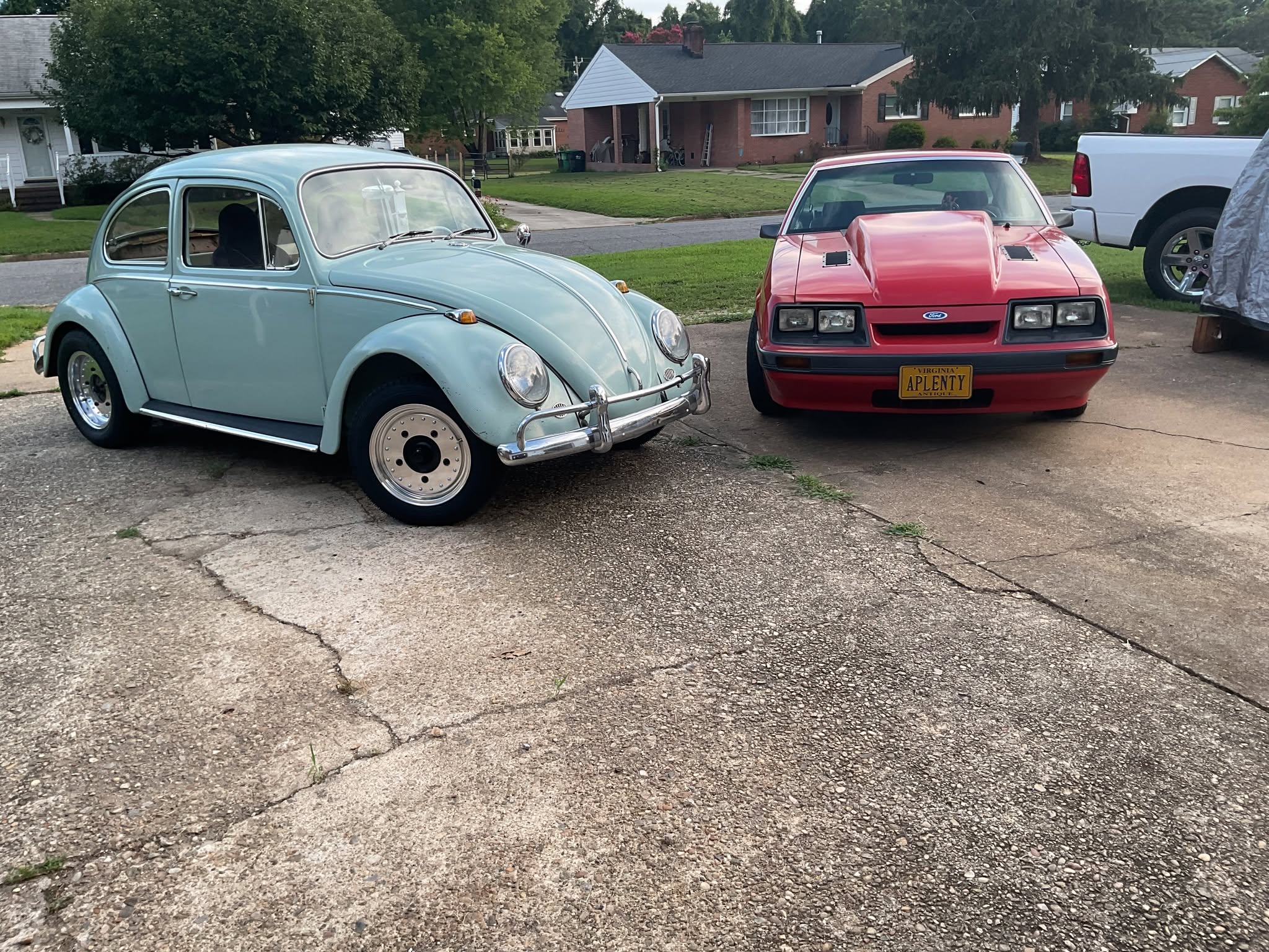

Yes I found the perfect,as close as I could year wise, VW to look somewhat like the one I had 54 years ago during the Summer of 1972. Mine back then was a 1966 however I found a very nice solid no rust 1965 the same color within a 2.5 hour drive from home! I am only the 4 th owner now and it came with all the paperwork from previous owners including the original sales invoice from 1965 and the first tags ever put on it!

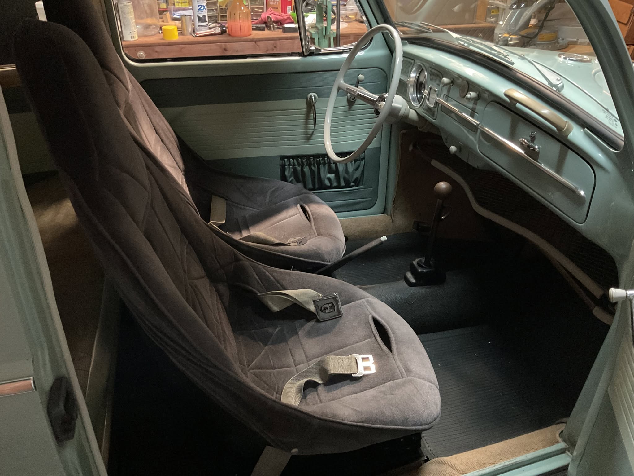

The seats were show a good bit of splitting in the material and I replaced them with a pair of nice race seats I used to run in my 1985 Mustang and they follow the theme of the high back 1970 Cuda seats I put in my original 66. Had to make my own adapter seat rails that bolted to the VW seat rails without any need to drill any extra holes in the floor or the factory rails. The tires that were on it were 22 yrs. old and even though they looked new I replaced them with a set of custom wheels that look like the ones used on a famous race VW out of the Thunder Bug shop featured in CARS magazine in 1972. Upsized the rear tires to 205-65-15 about as wide as I can go without any fender mods. New muffler installed,since the other one was rusted a good bit along with unbaffled larger tailpipes for some sound. The 1965 has the 40 HP 1200 engine nobody makes a header for due to a narrower engine case. 1300 and up no issue but I do have a pair of larger engines that came with the Bug.

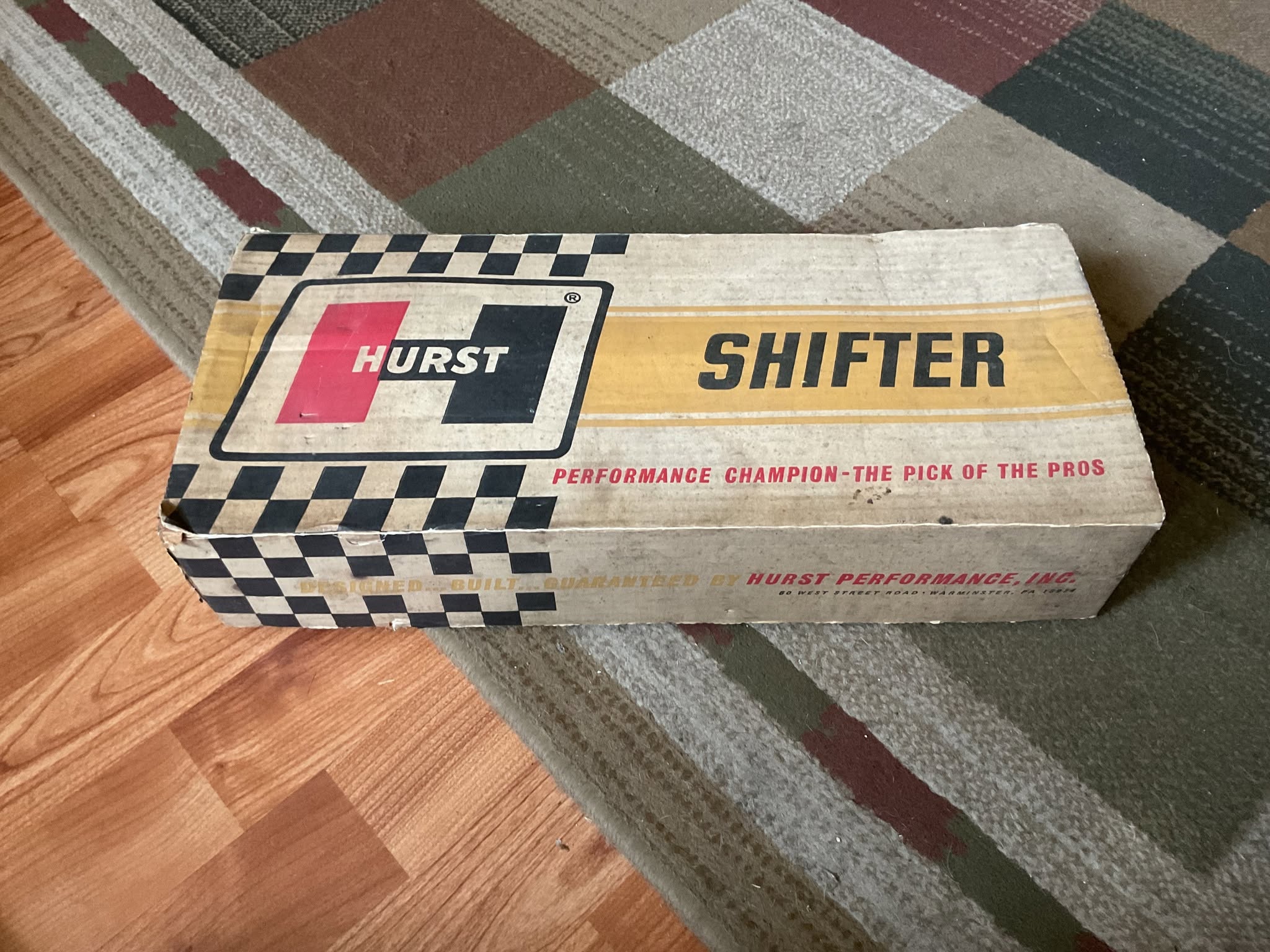

Yes I will do that. Forgot to mention the original shifter in the VW was like a wet noodle for shifting and I got lucky and found a Hurst shifter like the one I had back in 1972 in brand new shape with the original box new never used. Best of all in came with the Thunder Bug store label on it! Won't cheap but then Hurst quit making them back in 1979 and only thing like it now is a cheap China copy that falls apart.
