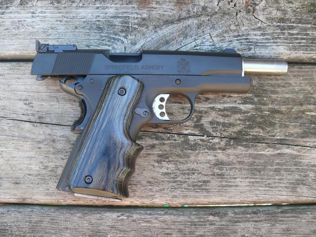

Post by North Country Gal » Tue Jul 23, 2019 8:20 pm
This is what it would like without a full length guide rod. I can do without a full length guide rod, by the way. Not big deal for me. Do let us know how it hoots for you, though. Good to hear that your LGS is making an effort.

Post by Mistered » Tue Jul 23, 2019 8:43 pm
Personally I like the FLGR.
Mechanically it keeps the recoil spring in a 'straight line' as it is contained by the guide rod.
This results in smoother slide action as the spring is not being compressed in a lazy 'S' shape while on slide retraction.
Try it yourself - If you have a FLGR remove it and install the original spring guide and cycle the slide. Then replace it with the FLGR and cycle the slide - much smoother.
Regardless some still maintain there is no need for a FLGR on a 1911 and that is OK!
