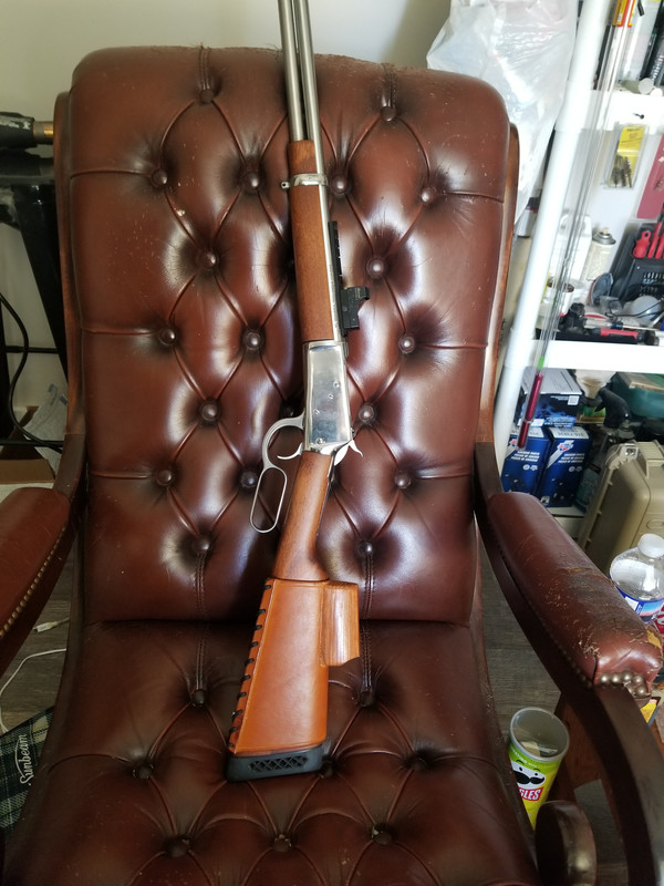

They certainly make it easier to get a decent cheekweld. The one on my Henry is fairly crude but its functional.

Now Im making a stock cover with a cheek riser to line everything up. It will be like the one I made for my bigboy, hopefully a lityle more refined though. I should look like this
That looks great, nice work for sure. I use a cheek riser too buy mine’s one of those store bought ones. :D

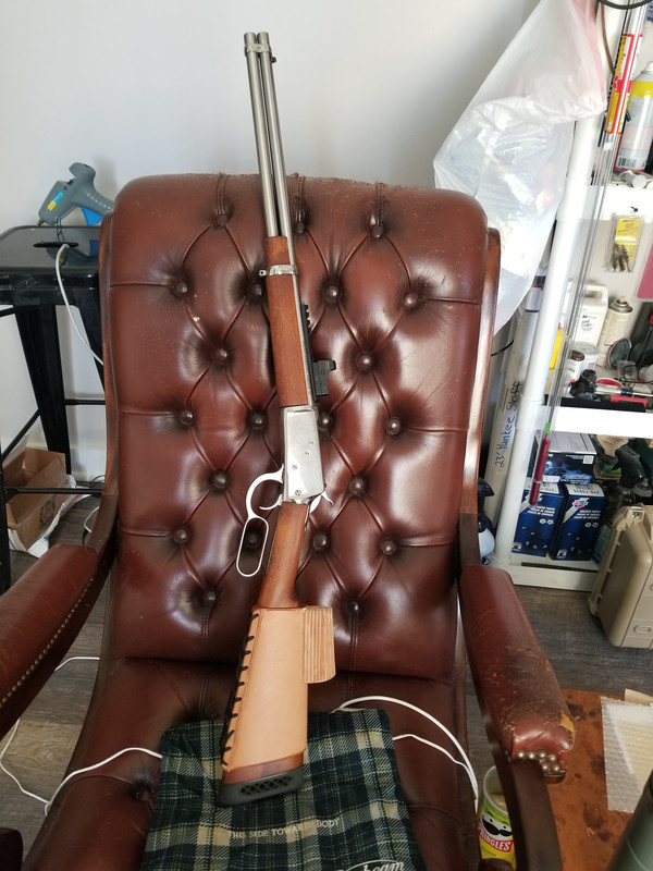

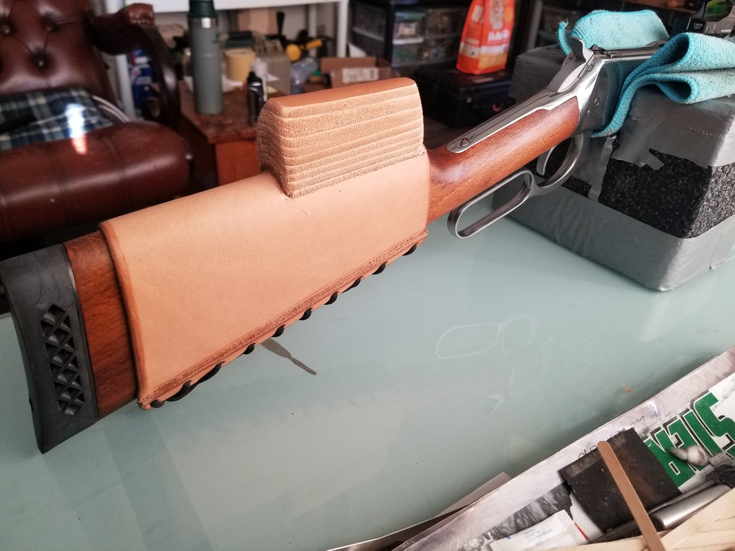

So, it has to look something like this, and this is THE minimum height for seeing the dot, in the bottom of the window.
I thankfully did remember to make sure this one tapers downward toward the muzzel end so as to not slam so hard into the orbital bone upon firing. Its bad enough with the 44mag so I van only imagine how bad it would be with a 454.
Of course its totally shapable at this point and I may do shome final shaping and then the small details and the lacing and a finish. Im thinking just neetsfoot oil on this one but its about at its final shape. I know it looks quiye high and a bit wonky but thats the height it needs to be to be of any use with that dot. It is comfortable though so that counts for something.

Is there a stock that would align better for optic use?
You'd think that with all the new tactical levergun options, that someone somewhere would have one that gives proper comb height on a replacement stock.

Not that Im aware of. I dont think I could anyway, all of that "tactical" levergun stuff is about as ridiculous as it gets. Ive come to loath that word, tactical. Personally I dont know how a firearm, or any other inanimate object can be tactical. The word implies having tactics no?
Ill see how this works out. I think, well hope that with some final shaping this wont look as unbalanced, and it is quite comfortable.
On an 1892, a stock would have to have a pretty high comb to facilitate the use of any optic. Youll note how low that little red dot is, can you imagine trying a scope? If it wasnt a rossi I might be persuaded to attempt making a stock set for it but knowing me the way I do I would have to use some aaa fancy walnut and again, its a rossi.

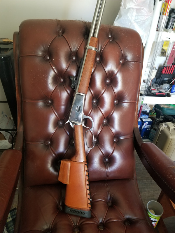

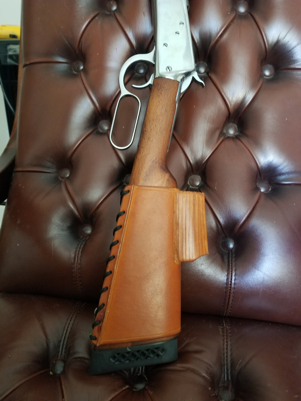

Final product.

Color worked out nicely. The “stacked” pieces of leather making the riser look nice, the lamination works great for the visual.

Yeah, the color is about the best thing about it. Well that and I can use the dot with a good cheekweld now. That was the goal.
