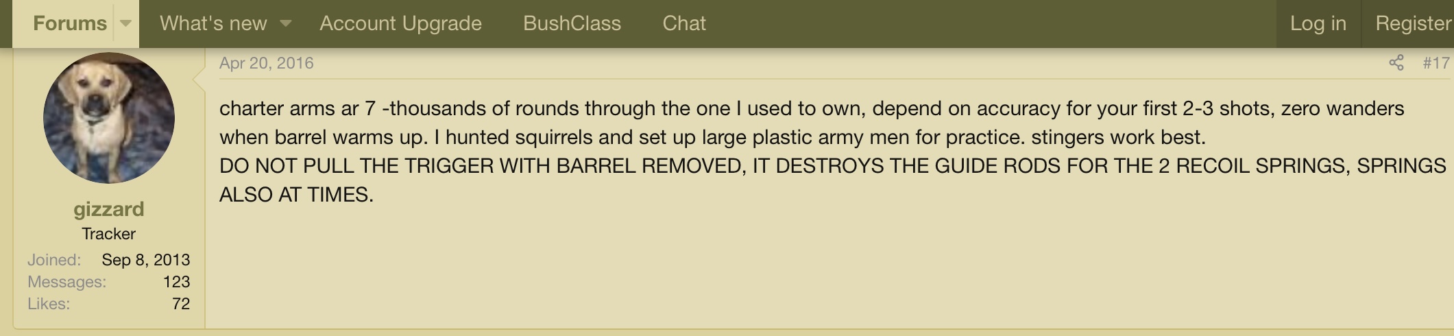

MYTHS AND RUMOURS 10
Firing the action with the barrel removed damages the guide rod and springs. Well the poster does state at times, so this could be possible however in my experience it is not true.
When re-assembling the rifle the action must be cocked to put the action spring guide, springs and bolt back in the receiver. Once the bolt is pushed back in the receiver the cocking handle can be inserted and this retains the bolt in the receiver. Since the action is cocked I often fire the action to release the trigger spring with the barrel still off. With the barrel off the bolt sits slightly forward of where it would sit when the barrel is in place but not far enough forward to prevent the hammer from lining up with the cut out in the bolt, When the barrel is attached the cocking handle does not contact the receiver. With the barrel removed the cocking handle contacts the receiver. When the action is fired the hammer strikes the firing pin and bolt which would exert a forward force on it pushing the cocking handle into the receiver at the front of the groove it travels in. Although I have not experienced any problems this could potentially cause some peening on the receiver or possibly crack the receiver so firing without the barrel may not be recommended but I will continue to do it.
